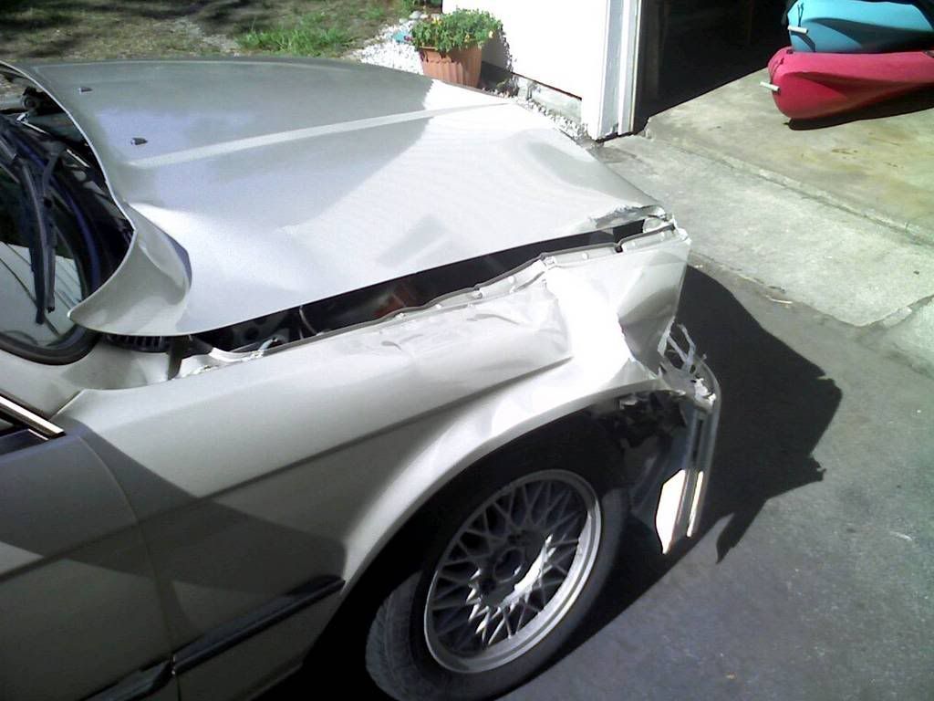

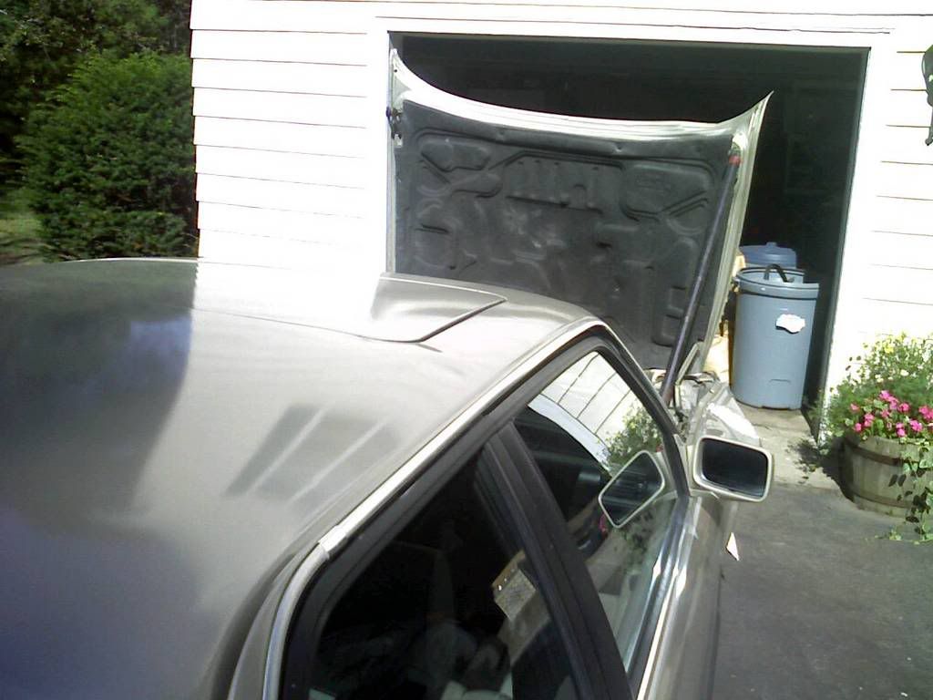

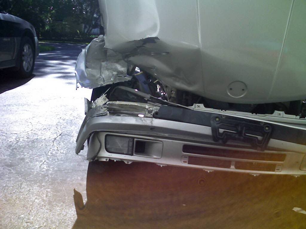

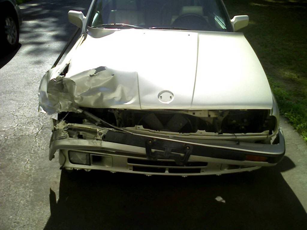

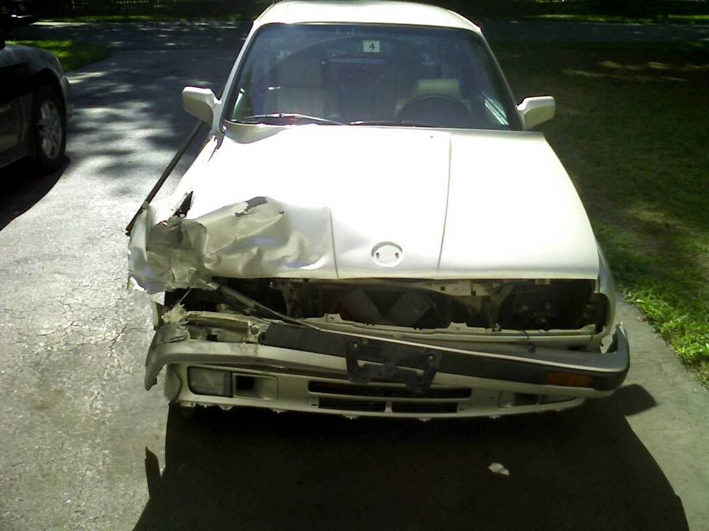

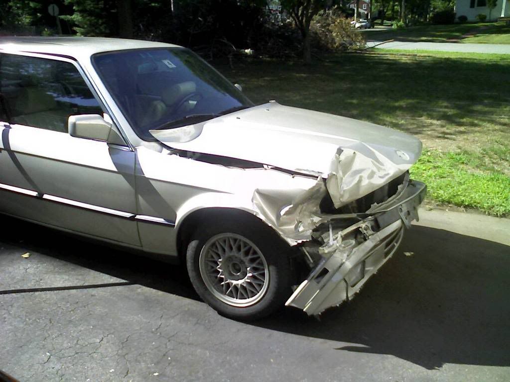

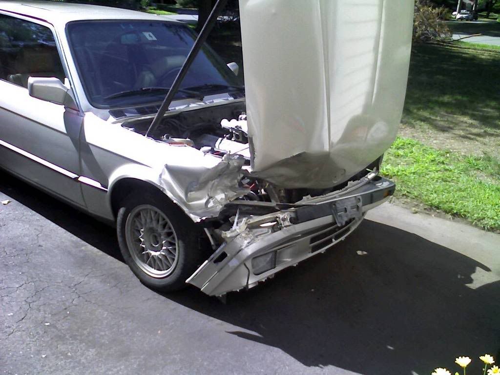

            Totally effing stupid... Rookie move on my part! I was driving up Rt. 138 North in Portsmouth, RI, 4 lanes, two each way, I was driving ~40mph in the left hand lane. There was a semi (18-wheeler) in the right lane, our front wheels were about even. I was following an Expedition for about three miles, got a little pre-occupied thinking about stuff, all the sudden I look up and the Expedition swervs to the right litterally about 2 inches in front of the semi... There was a stopped car there making a left hand turn. I hit it at about 40mph which was fast even though the speed limit was 45mph. She was OK, turns out I know her from a friend of a friend (which makes it easier and worse at the same time)...
            Car is totaled... totally totaled. The roof buckled just behind the sunroof from the impact... So now I'm SOL but good news is a buddy of mine just gave me an e21 (he got it for $50 and he probably got ripped off...). I'm on the fence as to whether or not I should build the e21 (m20 swap) or if I should grab another e30 and build that. I've got all the e30 parts but I have more e21 parts and emissions on the e21 is WAAAAYYYY better than the e30. I currently have a fuel issue with it and need to get fuel to the motor. Once that's resolved I'll want to know things like can I put e30 strut bars in the e21 or is there anything else that will swap over???Teaguer said no to diff, rear trailing arms & rear subframe... WHY? Is it the bolt patterns? Pickup points on the subframe? Trailing arms spaced too far apart? Lots of guys put e30 trailing arms on 2002 race cars to get cheap access to better stub axals & rear disc brakes... Is it just not a direct bolt on or is there something else that I'm missing?
            Here you go FredK:
            Good news is that NO ONE GOT HURT and that my e30 did what BMW designed it to do - keep people alive...

              holy side scrolling post batman!
              Anyway, good to hear you didn't get hurt. 40 mph sounds like a pretty gnarly collision! The car must have absorbed a lot of energy if it deformed behind the sunroof. :shock:
