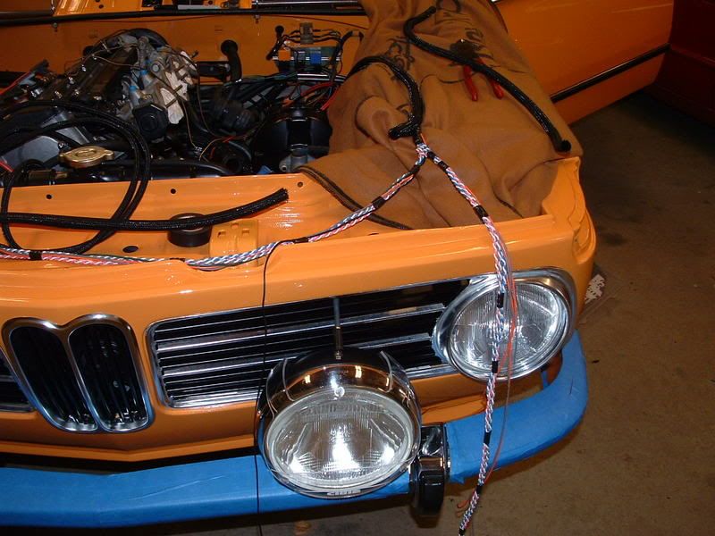

    who knows HID's? i have a set of apexcone 50watt 6000k hid's in my driving lights. one works fine and the other one makes a clicking noise (igniter i assume) and works about 1/2 the time. think its the ballast or igniter or what? i suppose i should contact apex but thought id ask here in case someone knew the problem
    its in these-------

    ballast. i had this same problem when one of my ballasts fell off the car and i was dragging it down highway 1...
    PS: holy shit those are gonna be bright in those fog light housings...
    EDIT: can i see what kinda setup you have? the HIDs i use have just the ballast and the bulb...no more external igniters on newer HID setups.

        dude these things are nuts when they both light. they are actually 5000k not 6000. they are hardcore bright white like a rally car. im amazed at how fucking bright these are. you want a pic of the ballasts and igniters? is that what you mean??? so i wrote understeer to see what they suggest. i hope this doesnt turn into a shitfest. i just want everything to be right

                ^no. prolly a shotty ballast.

                  just noticed how nice that wiring looks, should have used a purple instead of white, would have had ///M wiring...BALLIN!

                    You're not going to leave that bumper blue are you?! ;)
                    I would say ballast too. I had a Phillips one go to crap in my Denali - it did the same thing.

                        Holy shit I cant get past the badass restore job !!! What a beautiful 02 !! Sorry back on topic sounds like a ballast to me but however I am not real familiar with hids too.

                          holy clean wiring job... looks great.
                          If the light lights up then dies or blinks its the ballast. if it doesnt even come on at all its probably the igniter. Higher end systems have the ballast and igniter in one box.

                            Probably a bad ballast, try swapping sides with the ballast and see if it goes with it.
