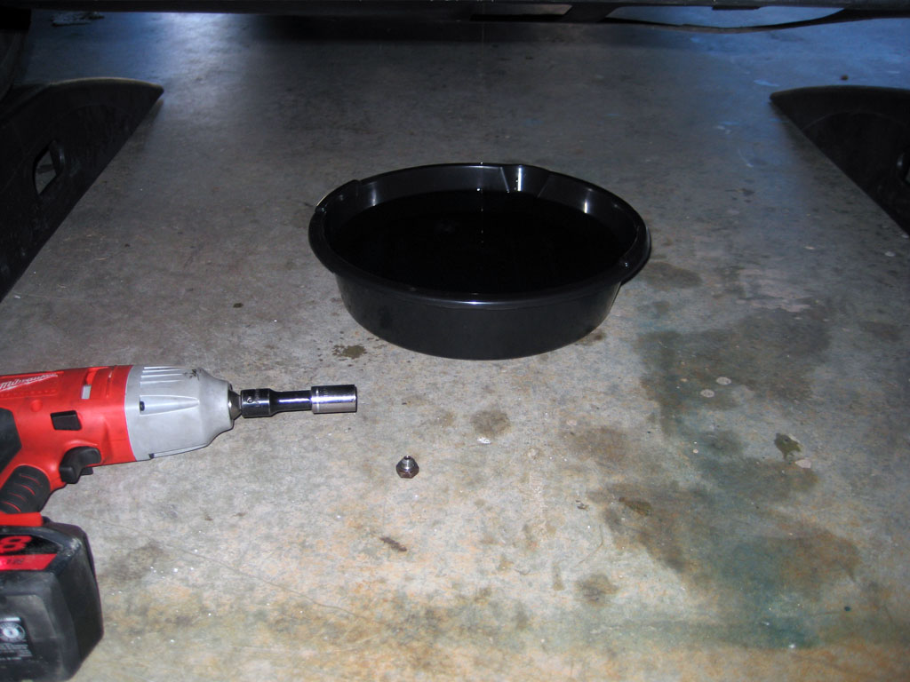

    I went to remove my oil drain plug, and half of it decided to stay in the oil pan, the nut and about 1-2mm of thread came out. The oil is currently draining out SLOOOOOOOOWLY. Hopefully I can drill a small hole in the remaining portion of the drain put, then use a screw extractor to pull it out.

      Here are some pics. The oil is almost done draining.

                Well, it wasn't near as messy as I thought it was going to be. The drain plug that was in there was hollow in the middle, so all I had to do hammer the screw extractor in the middle, then turn it out.
                The aftermath: :D

                  Did you use that cordless impact to remove the plug!?
                  Keep it slideways!!
                  • oldskool3
                    • Mar 2005
                    • 401
                    Thats what I was going to ask. I don't think it's a good idea to use power tools when removing/ installing any drain plugs.

                      It doesn't sound like he was using power tools, but it looks like he was. Whats the verdict?

                            I had to use the the impact to get what was left of the plug out. It had to spin fast enough for what was left to the plug's threads to bite.
                            That impact will put out over 260ftlbs of torque, it would NOT be wise to use it to do an oil change.
