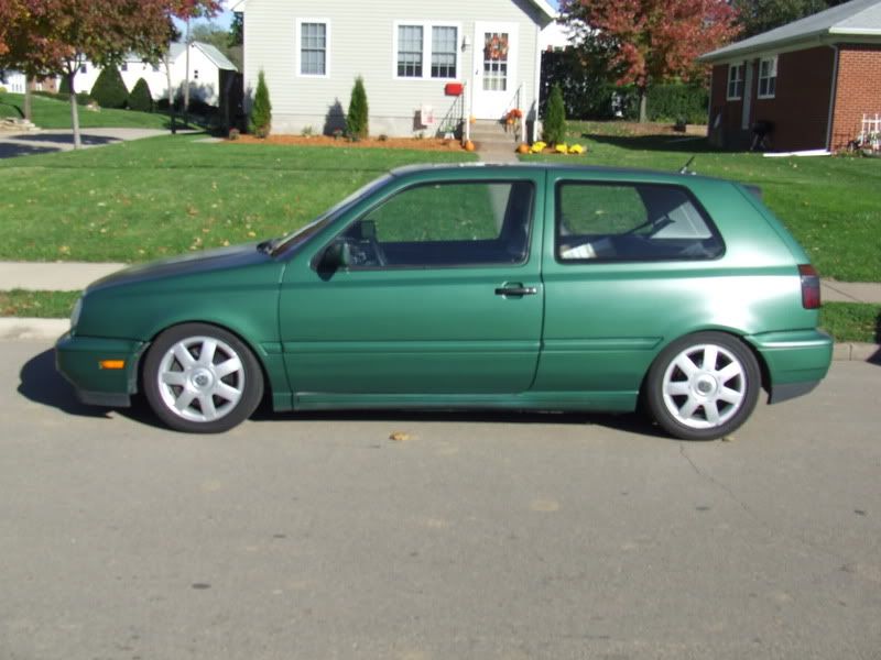

      My friend and I did my VW in his garage, no makeshift booth. We just moved some things out of the garage and sprayed away. It helps if you wet the floor to keep dust down.
      The VW was painted a flat color also so there was no buffing it, and it turned out good with minimal imperfections.
      The car is alittle dirty in these pictures.
