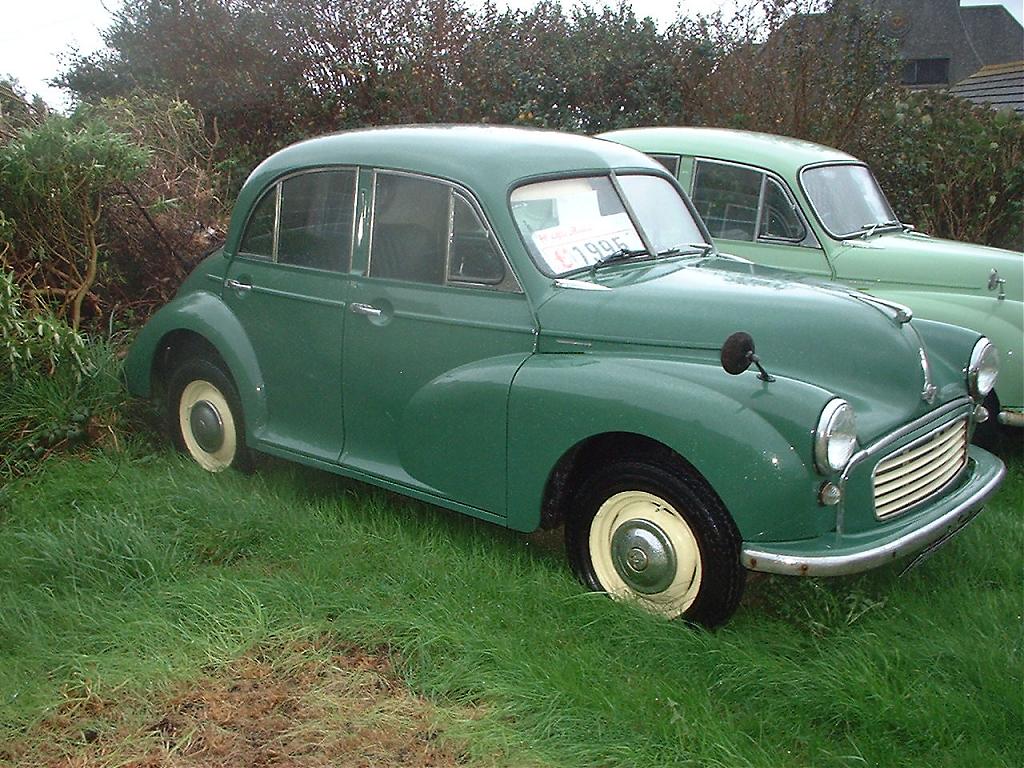

                            I used to own a Austin Morris Minor 1000cc back home. heavy as hell, but shell was strong.
                            mine had the light green color as in this pic
