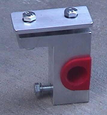

I have the ST rear sway. When you hold it up to mount it it looks like they should have made it a half inch wider. With some muscle and a Ryobi impact gun i was able to gey it mounted. Took about 3 hours and was not fun. I think you'll through off the resitance by changing the pivot point if you drill new holes. Get some of these. Should make it alot easier to mount.

Originally posted by einstein57 View PostI have the ST rear sway. When you hold it up to mount it it looks like they should have made it a half inch wider. With some muscle and a Ryobi impact gun i was able to gey it mounted. Took about 3 hours and was not fun. I think you'll through off the resitance by changing the pivot point if you drill new holes. Get some of these. Should make it alot easier to mount.
