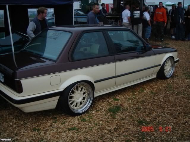

    Has anyone ordered these from the dealership? I called the dealer today and the guy I talked to said there was US and Euro skirts. I am guessing the Euro skirts would be the Mtech kit? He sent me a fax of the parts they can get so I could see what he was talking about.
    Here is what I want...

    Does it look like I have them paired up right? I am looking for the ones in the first picture and just I want to verify them with everyone else.

    yep those first ones are is skirts.

      So the first fax that says USA on it, those would be the IS skirts?

          Yes, the first ones are IS skirts. I ordered them for a guy named Steve. His username on here is blunt and he's a legit seller of OEM parts. I also ordered a euro plate filler, euro bumper trim and some other random parts from him. I'm pretty sure the total for everything needed for the skirts was $301. Here are the part numbers for the skirts and all of the needed hardware for mounting:
          51 71 1 947 063 covering, Left (1)
          51 71 1 947 064 covering, Right (1)
          51 71 1 947 059 cover, Left (1)
          51 71 1 947 060 covering, Right (1)
          51 71 1 922 599 clamp (2)
          51 71 1 933 719 clamping Bolt (2)
          51 71 1 927 439 clip (2)
          51 71 1 939 302 sheet Metal Screw (2)
          16 13 1 176 747 plastic Nut (2)
          51 71 1 932 996 grommet (10)
          51 71 1 959 929 clip (10)
          51 71 1 938 940 clamp (10)
          51 11 1 942 789 rivet (4)
          Hope this helps.

            I just let a set of IS skirts go for $150. They are NOT that rare. They are TOO short, and really don't look good on anything besides a white car.
