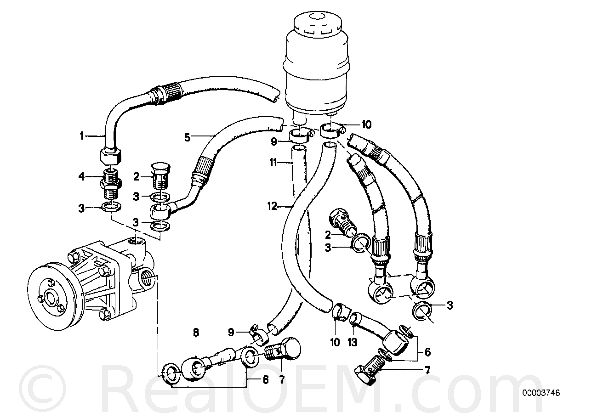

        Unhook the line off the rack, stick it in a drain pan and turn the wheel back and forth a few times with the car running. Hook the line back up, pour in new ATF while you turn the wheel again with the car running, it will self bleed.

                          can some1 show me which hose to take off to bleed the old fluid out?
