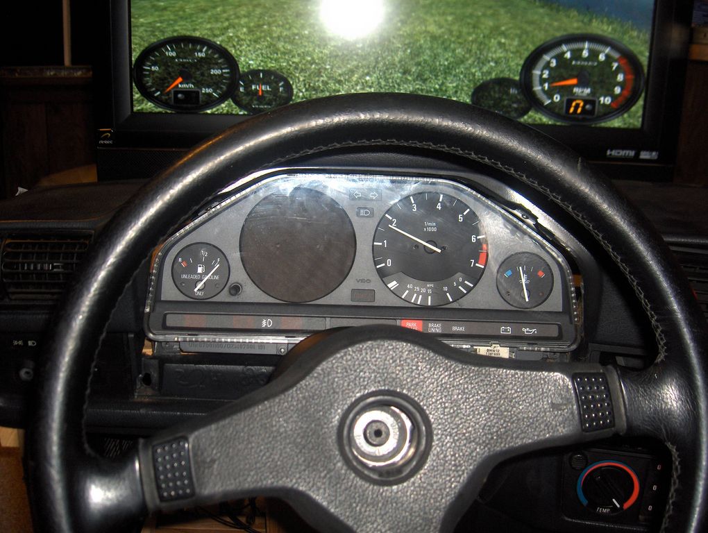

        Gauge cluster installed, need to trim the wood to make it fit better though.
        And yes, the park brake light does work properly, and I put resistors on the temp and fuel gauges so they appear realistic :) Also ended up buying some cheap aftermarket tach, ripping the guts/armature out and installing/modifying a spare e30 gauge face to work with it.

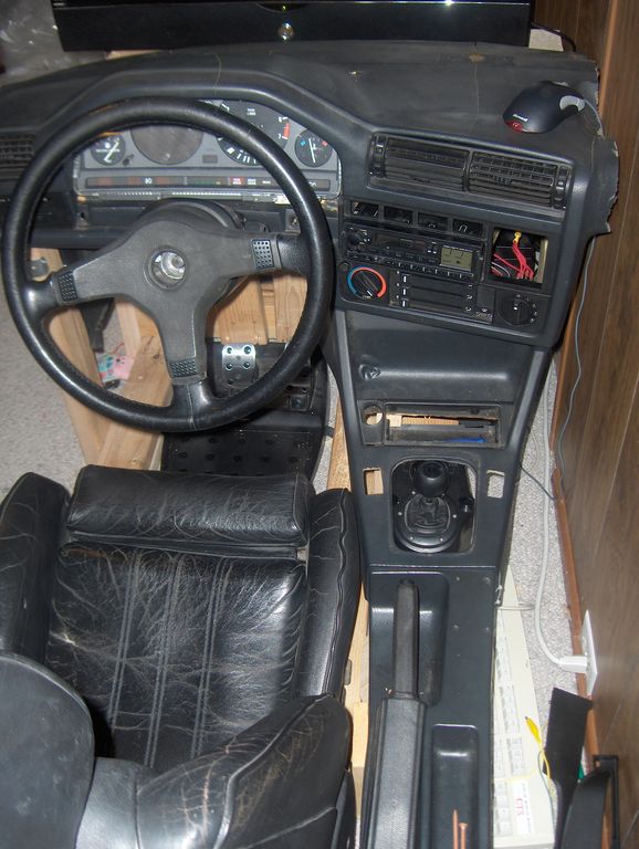

          Dammit gimme that headunit...I'll put it to good use!

            The tach is off and no speedo? Come on, you're better then that. ;)

              My only question is how you interface the pc to the vehicle controls ie horn, ebrake, etc
                    Can't work with the speedo yet, waiting for Beta Innovations to release the interfaces for that.
                    The tach as it climbs the sweep is more accurate (where it matters)
                    who cares about idle? :p

                      Originally posted by thull
                      That is great man.
                      The Tachometer is interfaced via a simconbase
                      And the horn, ebrake etc, are ran through a series of relays (to turn on lights and such) and also interfaced with a I-PAC VE

                                looks like you'll need to hook up power steering before you burn out the logitech gears.
                                you are insane as it stands but if you added the PS, you'll need to be admitted to the nuthouse!
