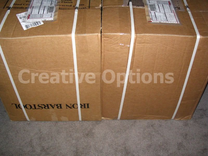

                          Here is how I ship them with 1500lb plastic band strapping. I do use U-haul wardrobe boxes though. Do the same with duct tape.
