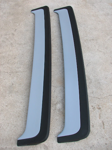

What are one of these worth?
    They are for a 535is but the seller claims they will fit E30's

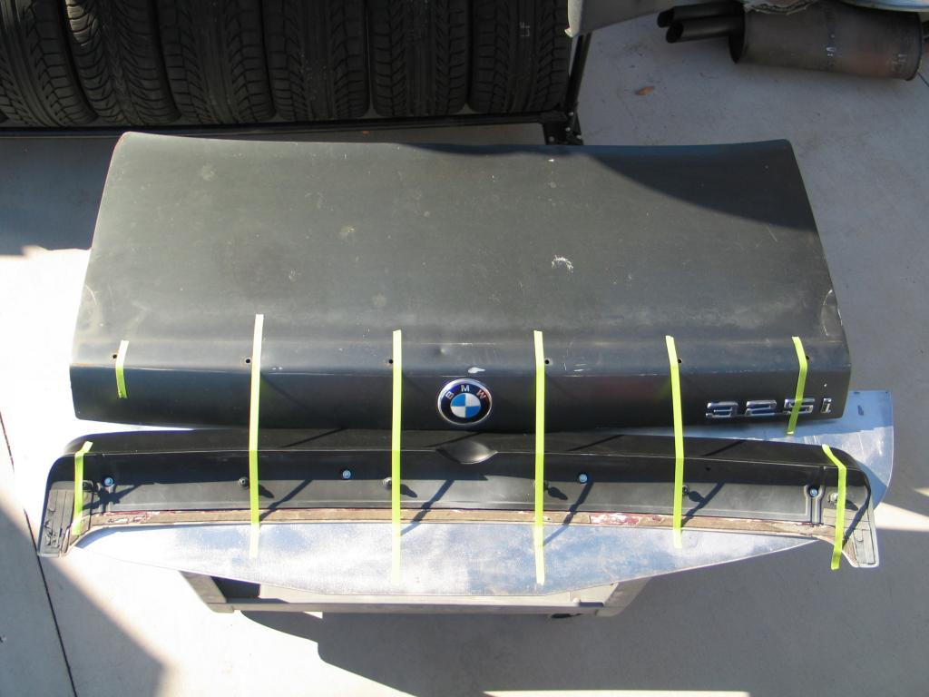

    100-175. they will fit an E30 but the last outside bolts are a little further out so you will need to redrill two new holes.
      I'd love to have a new one if you have an extra.
        Saw it advertised elsewhere. They are not new. Seller wants $140.00
          Each or for both?
            Originally posted by Turf1600 View Post
            Each or for both?
            Each. If it were for both, I'd buy them and sell them.
            Here's the link if anyone is interested:
            I have no affiliation with the seller. Was just wondering what they were worth.

              those look to be in great condition. 140 isint bad imo

                It's more then two holes. All the holes need to be redrilled.

                  Seems like a pain. Not the drilling new holes part, but what after you do that?? How are you gonna access the studs from the inside? You have to drill through the inside frame too?
                  Also, are these the same dimensions? (Width)

                    No, they aren't the same dimension. The e28 one is wider than the trunk.
                      Jason /\ not all the holes need to be redrilled, only the outside 2 need to be redrilled.

                        that price is a good price for the e28 Mtech1 spoiler in what looks to be good condition. I have the e28 one on my car.
                          I have seen them for for 200 with good paint when i didnt know what they were but I would ask him if he would take 125$
                          You're confusing the outside holes with having to cut the two outside studs off. All of the holes have to be redrilled. And some poeple cut the outer two studs off, and others don't.

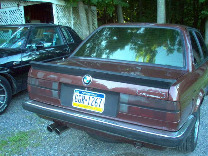

                          Here's a crappy picture of the e28 spoiler on my 85. You can see how much it hangs over the lid.
                            some one in my thread about it put up a pic where it shows that all the holes are on the same spots but the last ones on the outside. if you had to redrill new ones in a lid that had standard holes I believe you but the picture was rather convincing. you should take a look at it
                              this is the pic im talking about
