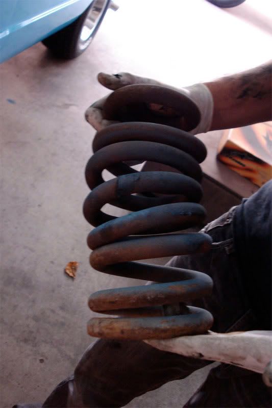

    This is why you don't...
    These springs were pulled from my buddy's '69 Suburban. The previous owner heated them to lower it. These things look like Roseanne Barr had 'em for a snack and spit 'em out. The suburban seriously feels like a new ride.

      But don't these things look like they're straight out of Alice in Wonderland??
        heating coiled metal to cut it? that's retarded.
        Anyway, factory cuts them to size too, and custom coils are cut to size. You just have to do it right.
          and in no way i support that action on an e30.
            Dude looks like he put a torch to those while they were on the vehicle, that's tarded.
            I've cut springs before, fronts on a Corolla, and there were no ill effects (rears were leaf). The coils were however evenly spaced throughout, making it possible. I cut 1 coil out with a cutoff wheel. Lowered it 2" and stiffened the spring a tad. That was 25 years ago. Went many years.

                  They heated them whilest still on the car. That's what you get for buying a 'burban in South Central...
