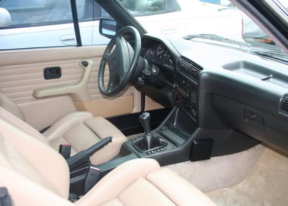

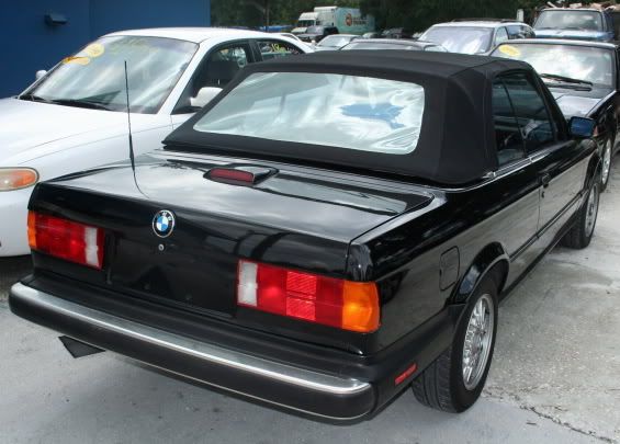

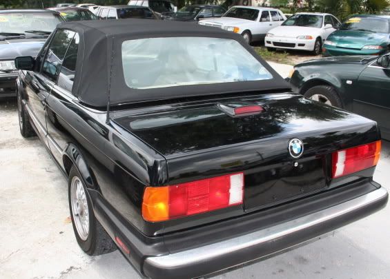

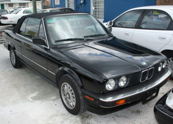

                Here's the 325 that I am thinking about with the broken odometer..
                What do you think, I guess all you can see is the body..

                  That would be a 325e (don't think they had an m20b25 in the DBs). If it comes down to 325e vs. 318i, I would go 318i.

                    • 318isbmw
                      Yes they did. 1987 325ic was a divingboarded m20b25 powered car. Also, the motors changed from 325e to 325i in 1987 in US models, although there was the super eta motor, which lived on in the 1988 325. Note that one doesn't have either an i or an e at the end of it.

                        Just checked carfax though and it says 325ic.
