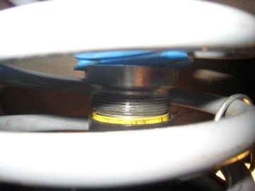

    so im driving along and i start hearing a clang clang clang from my right front strut tower. so im like i shit what the fuck is going wrong now! so i drive home and park the car. next morning i lift it up and take a gander. so im lifting the little blue protective boot up the bilstein strut when i see something missing. can any one guess what it was?
    needless to say i felt like a dumb ass when i saw this because it means that i did not tighten it down to speck when i installed the shit!

    ooooh missing lock collar? Don't worry man, it happens. I did it once on my very first suspension job. Just pull it apart and fix 'er up.

      huh? i dont see anything missing. looks like you didnt tighten that collar nut enough though. did you only hand tighten it?

        Put her back together and get back to rollin.

          yeah. not really missing but it is not where it should be! pissed me off! i didn't want to spend all day doing this. i dont even have an impact wrench to take the spring assembly apart.

              long flat head screwdriver+hammer... done in 25 minutes

                  Mine did that even after I tightened it properly.

                    i got it all apart, and am fixing it right now. wasn't that hard. just annoying.

                      i wish i had thought about that before i took everything apart! well i guess i know for next time...

                        Mine did it too, and it took me forever to track down the clunk, because I had pretty much replaced every front suspension component before realizing what it was.

                          Just tighten it with a pipe wrench. You can fit the pipe wrench through thr spring, and it's more leverage than trying to pound on it with a screwdriver and hammer.

                            Pipe wrench all the way. I should probably check mine as I just finished up the new suspension.

                              Yep, Jean has had it happen twice and so have I.
