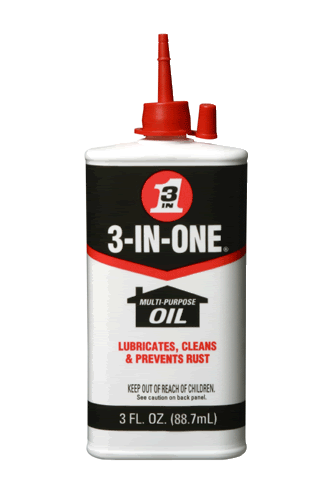

          bro, what you need is some 3in1 oil, penetrating oil, 50/50palmolive and water or some sort of good lubrican..yeah thatone probably works too. be generous, let the shit drip all over you, the floor, the CA and CAB.
          Hopefully you are man enough to lay on the floor and twist the CAB/lollipop onto the CA, twist back and forth as you press in, will take a good 5-10min of all your strength per side...otherwise, take the CA off, and place on end on the floor as you force the CAB on the top.

              So do you guys think I basically need a better lubricant? As far as the 3 in 1 lubricant you were talking about Luis... Did you make it yourself? I got some grease that I got from the store, and I have water of course, but what do you use as penetrating oil? I just mix these all up and drip it all over the place basically right? Thanks.

                pbblaster, 3in1, wd-40. any *single* one of these will work. i've had good experience w/ water and palmolive
                palmolive/water is the best option becuase it will dry out giving you that "stuck"... but in any event, the CA will not slip out of the CAB. my last e30 sat on empty lollipops and there's no way it'll come out...its impossible to drive like this though, don't ever try it, im just making a point if you're worried on the slyglide. pz.
