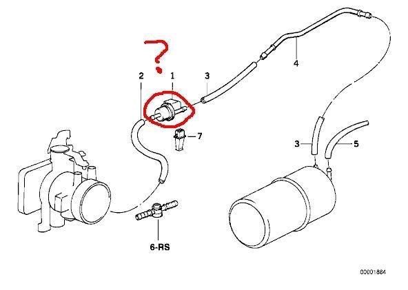

          Alright, so we did some investigating and found a couple loose hoses connected to what appears to be the fuel tank breather valve. Please correct me if I'm wrong on this. Anyway, we bought a couple hose clamps for the fitted piece between the valve and the throttle body. We also replaced the 1-inch hose coming out of the other end of the valve and put on some spring clamps we had laying around. After we did this, the connections were much firmer.
          I drove it around last night and it idled just fine. Today it bounced on probably two occasions, but less than usual and for a shorter time. Could this have anything to do with my problem, or was it just a coincidence?

              I would say no that is not your problem. The fuel tank breather valve is used strictly for ventilation of the fuel tank. No affect.

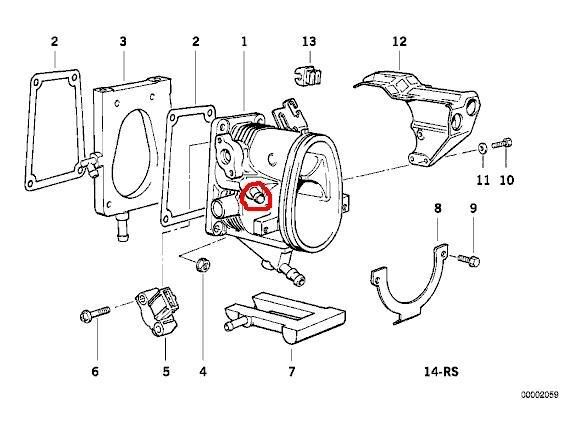

              For a lumpy surging idle, you'd want to look for replacing the idle control valve. I'd also check the specs of the throttle body as well and make sure its opening and closing properly and has enough clearance. Check bentley for the clearance.
