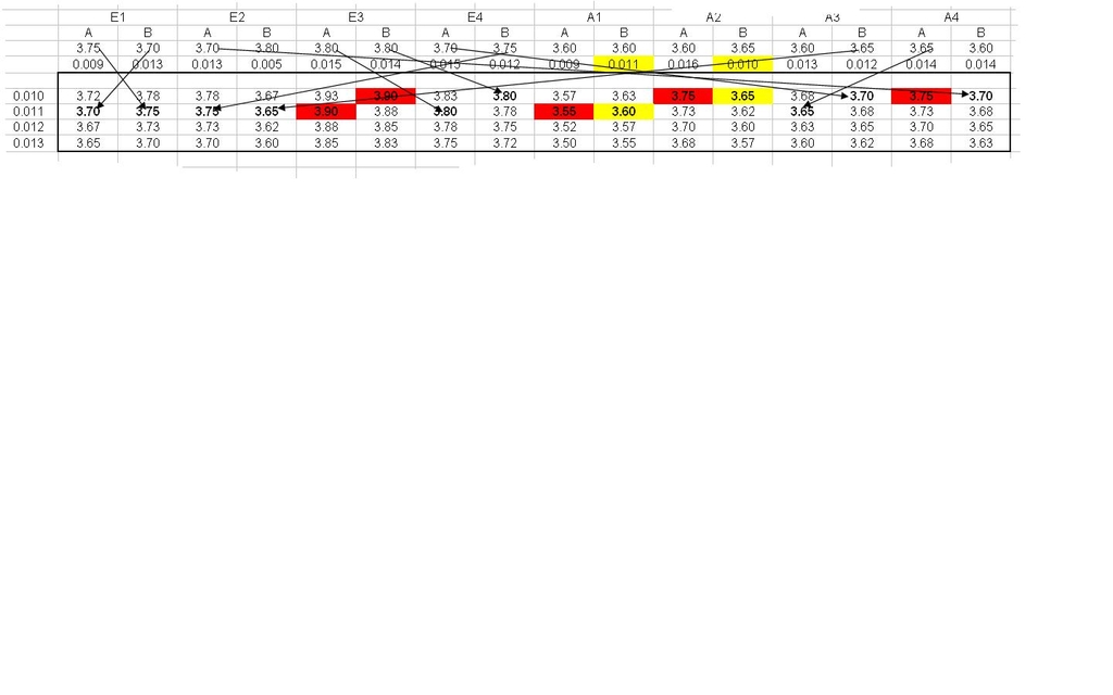

                        Oh come on. This is a one hour, two hour job max. Youre telling me you cant spare two hours once every 6 months? You can usually swap shims around so you only end up having to buy a few, I only had to put in 3 new ones last time. The shim bucket tool is a one-time investment. In this case it is an investment in the truest sense of the word, since its going to cost you 300$ every time you need to get them adjusted if you continue to take it to a shop.
                        So we're talking between 15$-20$ for shims and two hours of your time(again, I dont count the tool cost). But instead youre going to pay a shop 300$ and trust them to be as anal as only a car's owner could be. Come on man, dont act like the Porsche guys.
                        Since Im surely coming off as a dick, I'll be nice and email you my spreadsheet, which makes figuring out how to buy as few new shims as possible, very easy.
