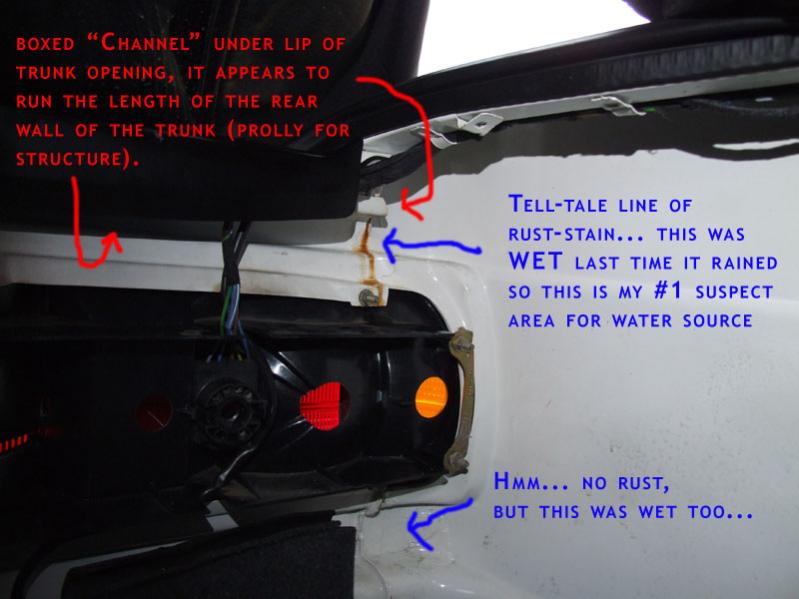

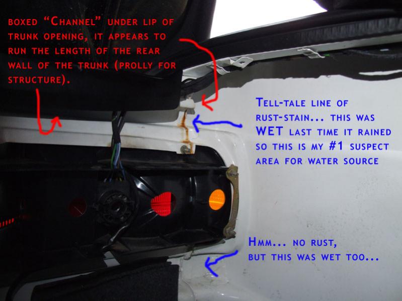

    The PO replaced the taillight gaskets, and I see a thin line of rust on the driver's side under the trunk opening lip, where there appears to be a boxed section forming a channel under the opening. the jack compartment FILLS with water, and the only place I see where it could be obviously getting in is about a 1" gap in the top half of the trunk lid gasket itself (like the top of the gasket "tube" was torn off), right in the center where the lock is. Thing is, this is under the lip of the trunk lid itself, and it "looks" like it would hit the lid, and drain off the edge onto the rear bumper. is it instead following the line of the closed trunk and seeping into this gap in the gasket? anyone seen this before? I was going to get some RTV and try to rig a patch type deal for the area, see if that works before springing for a new seal....

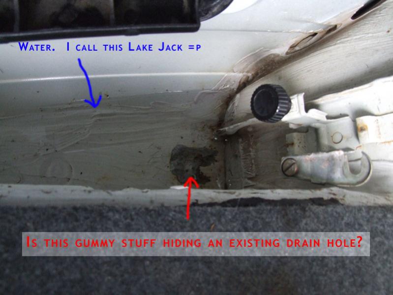

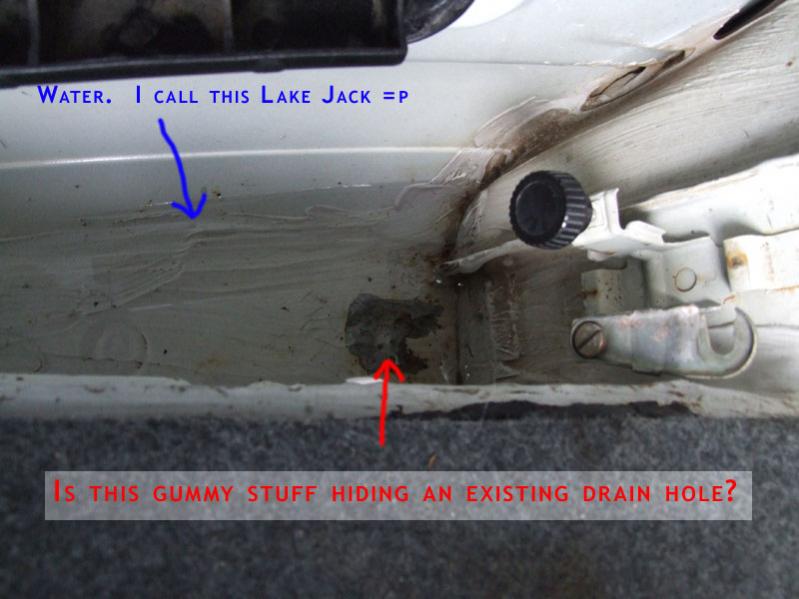

          nah its sitting more or less level. once i get the engine oil leak fixed ("pipe" running between block and intake mani) it will move to driveway, but by that time it will probably be getting hit by snow, not rain. the thing that is clear is that there is that line of light rust that shows from that boxed "channel" just inside the trunk, above the taillights. is it true that area (jack compartment) should be draining anyway? i didnt see any obvious drains, and was considering drilling my own but thought I should fix the leak rather than create another rust opportunity...

                      OK, duh pics:
                      any thoughts?

                          Clean the "gummy" areas, those are the trunk drains.
