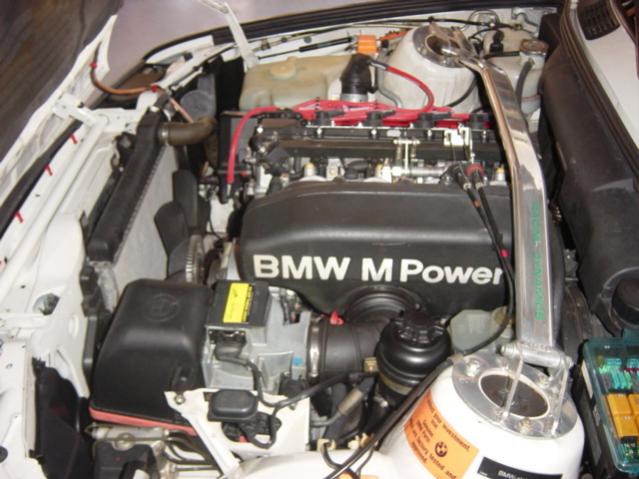

      Any picts of your front strut bar in aluminum?
      Any picts of your front strut bar on a 325i? (site pict is 318i). Trying see distance to firewall.
            That's steel, right?
            How much for steel one unpainted? I want to get it powder coated.
              Yes, the only shot I have of an aluminum one is on an M3.
                That'll do....Is it bare aluminum, brushed or anodized?
                          Raw aluminum.
