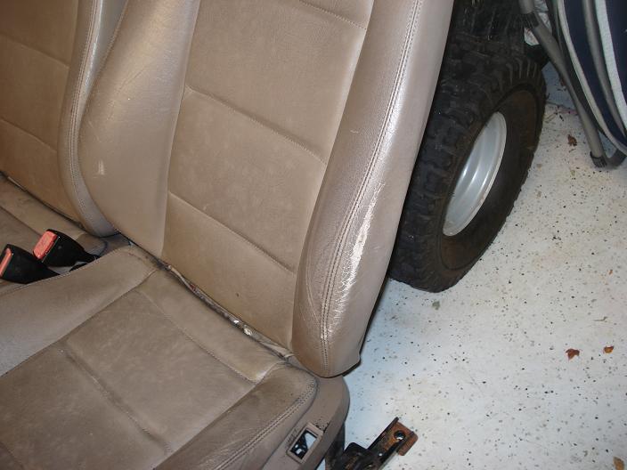

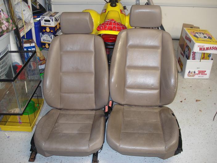

    im not sure right now what the deal is, the seats keep slipping and falling back, is there a simple way to fix it like just a gear problem? i also read a few things about putting e36 seats in an e30, i found a pair of e36 seats near where i live for 100$ ... im wondering how easy it is to put those in and or if they are worth 100 dollars?

    those look nasty, I wouldn't buy those

      yeah i backed off they werent worth it and my seats do work occasionally so i can live with that
