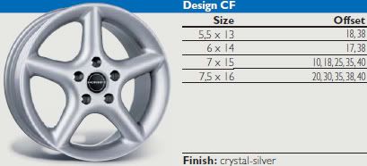

    Wheel Spacer
    I have these rims on my ix and wanted the tires to be closer to flush with my fenders. what size wheel spacer do i need?
    15x7

    Well, youre going to have to tell us which ones, there are quite a few listed there.
    Then, ask in the tires and wheels fitment thread
    Assuing yours is a 40 offset, it should probably be a small spacer

      I wasn't sure what the offset is. They are 15x7. Do we usually run 40 offset?
        no but IXs have higher offsets

          grab a tape measure and measure the distance from your tire sidewall to where you want it to be. Thats all there is to it.
            Let's not get people confused: iX's use wheels that have higher offsets. The offset is on the wheel, not the car.
            In any case, best way for us to suggest something to you would be with two things: 1-) Offset of the current wheel and 2-) Pictures with the profile of the car, that can clearly show the distance between the wheel and the fender (so no side profile shots)

              Ok, I will check the offset of the rim and snap a few shots.
