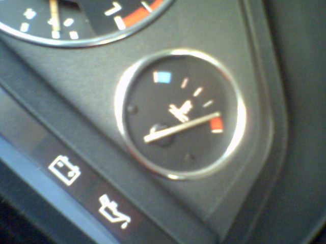

    Car has been running a little hot lately when standing still, runs at dead 1/2 when moving. I was at a red light and I could see how fast the gauge was moving, was waiting for radiator or a hose to pop...but it didn't... These little m10s just don't die....head/gasket time ftl

    I drove home with it firmly in the red once when the thermostat broke. Quite a stressful trip.

      I was just speaking to a guy who had the exact same situation with his M44 (fine while driving, but any time spent standing made it get hot quickly. So I guess you ruled out the possibility of it being a water pump or one of the radiator lines?

        My 84 has been doing that for years. Still runs strong though. Tough lil motors.

          fan clutch time

            Hoses are all less than 2 years old, same with t-stat and water pump. Radiator replaced last year (put in a new one with hoses/belts/water pump/tstat 2 years ago but the top part of it blew after a year and a half). Not using a fan clutch, electrical fan on at all times. It's never gotten this hot and nothing changed, so I am thinking it's the head/gasket....it would always stay in 1/2 zone and would it would take 20+ minutes before for it to get to 3/4 , but now it takes a few minutes. Once I start moving and turn the heater fan on, it quickly goes back to 1/2.

              I'd bet you a new headgasket that your problem will be fixed when you replace your fan clutch. Try sticking your hand (or a rolled up newspaper) into the fan when it is spinning. If it stops easily, your clutch is toast.

                Read again, not running a mechanical fan. Electrical fan has been working just fine for over a year, same config, no changes made.

                    You win, I should read closer. But if I had read and did see that you didn't have a fan clutch, I would have said that your electric fan wasn't working hard enough. So I'll bet you a headgasket that your electric fan sucks.

                      try your waterpump first. it doesnt make any sense that the car would run hotter at idle with a bad headgasket. the coolant isnt circulating well enough.-- possibly the belt is slipping on the pump pulley?
                      I agree, fan of thermostat/waterpump-- but not the headgasket.-- try tapping on the cluster (by the temp guage)to when it creeps up-- sounds stupid, but I had a M10 car that did that- the needle would drop right back to the half mark.

                        i would like to gamble with a guy like you. so his electric fan has worked fine in california summers for a year and all of a sudden its not working hard enough?
                            I'm going to go with this, same thing with my old '90 i
                              I'll double check the water pump / belt (belts are also new). Cluster is 100% working, i just recently put in brand new odometer gears, newish si board with lithium batteries and made sure the two nuts on the back of the cluster are there.
