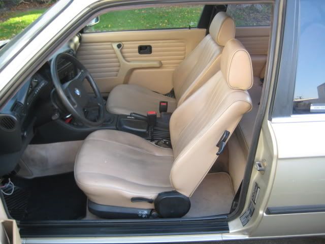

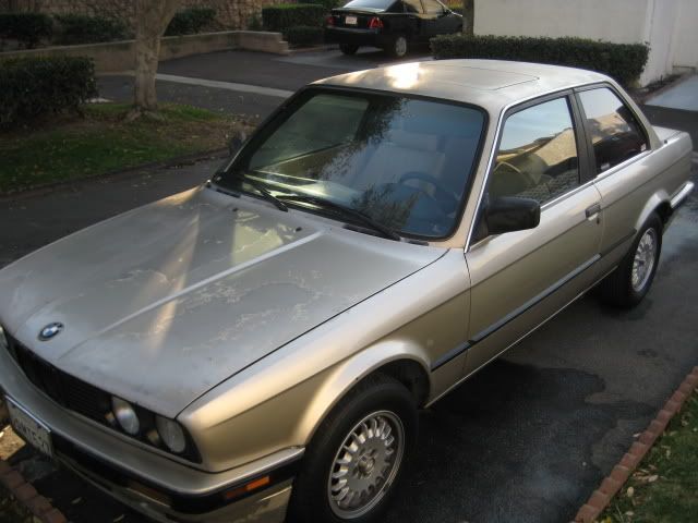

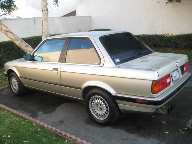

                    Post some pictures so we can see what your working with.
                      thank you everybody for all of your great advice. i am so grateful!
                      heres a few pics of my baby.
                        not bad, now do some work

                          yes. i need to do some engine work before i start working on apperance.
