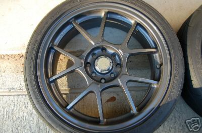

                    heres a picture
                      yeah, those are two different bolt circles.
                      i'm gonna guess that the smaller set of 4 is 4x100.
                      pick two opposing holes in the bigger set and measure center-to-center.
                      if you get 4.5", your 240sx guy is probably good to go (but it's worth having him check what width/offset he wants). don't worry about center bore, 240's are lug-centric, not hub-centric like e30s.
                        Yep, the smaller set is 4x100. I need to figure out the other holes now. Thanks for your help
                        Edit: from the rear of the wheels from center to center of the larger spread holes they are about 4.5"s apart
                          Originally posted by vlad
                            Originally posted by Joe318is View Post
                            Yep, thats what I did and the one part is the 3.93 (eyed) and the other is 4.5". I'll get the caliper to make sure tomorrow.
                            I obviously want to be 100% sure so the caliper will help and does anyone know of a printable template?
                              the other set is 4x114.3.
                              there isnt really a 4xanything else as far as i know.
