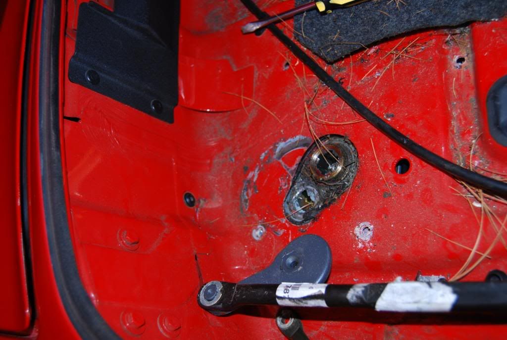

                  The same thing happened to mine... I ended up replacing it with another one... here are some pic's ..the broken one...
                  Try to test the motor without connecting these two rods just to see if it is turning... also make sure that inside the trunk, the motor itself has a little release that engages the gears of the motor to turn. If you do not hear any noise coming from the trunk when you are turning the up and down switch, there must be a cable not connected or it could be a fuse too.
                  Just make sure that you have all 3 wires connected and the release handle (the black one in the motor on this picture below) it is engaged with the gears of the motor. Hopefully, this will make sense 8)
