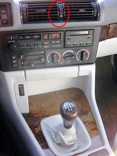

            anything you can tell me about heating problems? blower motor works fine, but the heat is always on. im assuming the heater valve is bad, but it could be the temp controls.

              Joe, check the dial next to the center vents (pictured below, circled in red) as that is a commonly overlooked reason why the temperature might be off.
              If that isn't it may need a freon recharge, outside of that, I don't know much about that sort of thing. The locking issue might be a driver's door lock barrel or lock actuator, of it could have to do with some of the wires in the door jamb being pinched, thus resulting in some functions not working. Your passenger door lock situation sounds like it may be a bent rod somewhere, pull the door panel and see what may be obstructing it.
