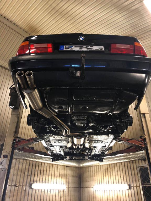

    I began collecting parts to bit by bit try to make the car better than it came out of the factory in some ways, as I use the car year-round and in the mountains. A stainless steel exhaust was installed to replaced the crusty original one and also upgraded the emissions system from a Euro1 cat to Euro2 (helps with vehicle taxes here and a little better for the environment).

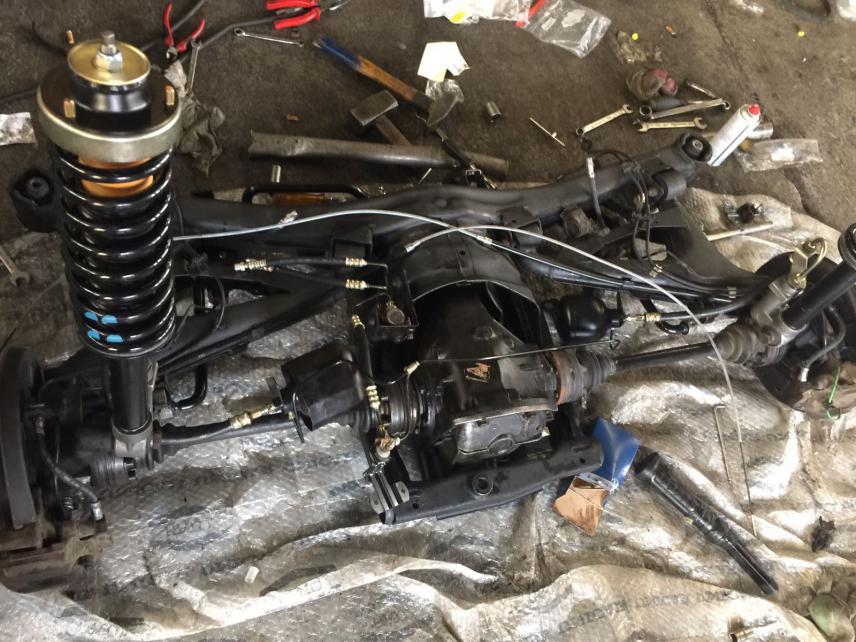

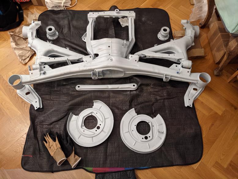

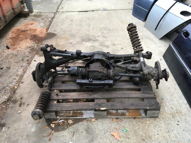

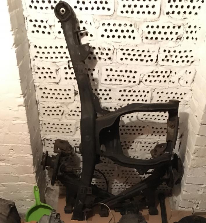

    This ended up turning into a much bigger project: Along the way, trying to find some used rear trailing arms, a good, used rear diff that was very clean, and rear subframe to restore nicely so that the car wouldn't have to be off the road for weeks and months.

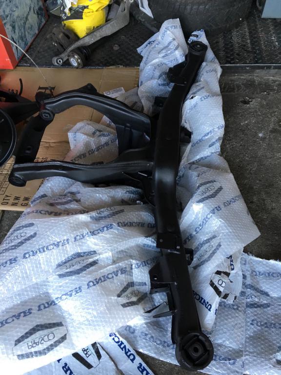

    A local independent BMW recycler and repair shop said they could sand and beautifully paint the spare parts I had and it all sounded good. It was only later that I learned they hadn't changed the 25-year-old rubber bushings with the new ones I gave them, or even bothered to cover the wheel bearing when sanding and painting and their 3-stage painting really turned out to be just 1. Nevertheless, we set out to install everything and ended up replacing all of the old SLS lines which at the time were still available. Also installed the 26mm front sport swaybar (regular is 24mm) and the 20mm rear swaybar from the M5 Touring Nürburgring edition which is Eibach made for BMW (the regular bar is 17 and the sport bar for the 525ix is 18mm). This is actually quite a nice upgrade to the handling.
Name:	Axle Carrier copy.JPG
ID:	10014617 Click image for larger version
Name:	Trailing Arm copy.JPG
ID:	10014621 Click image for larger version
    In with the "new" out with the original.

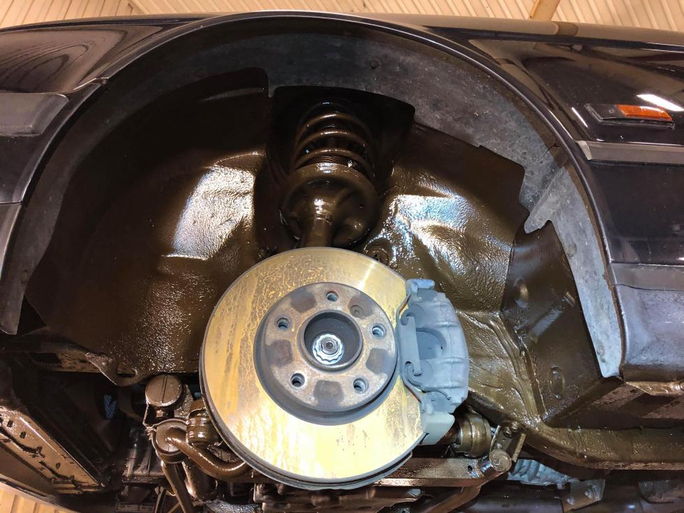

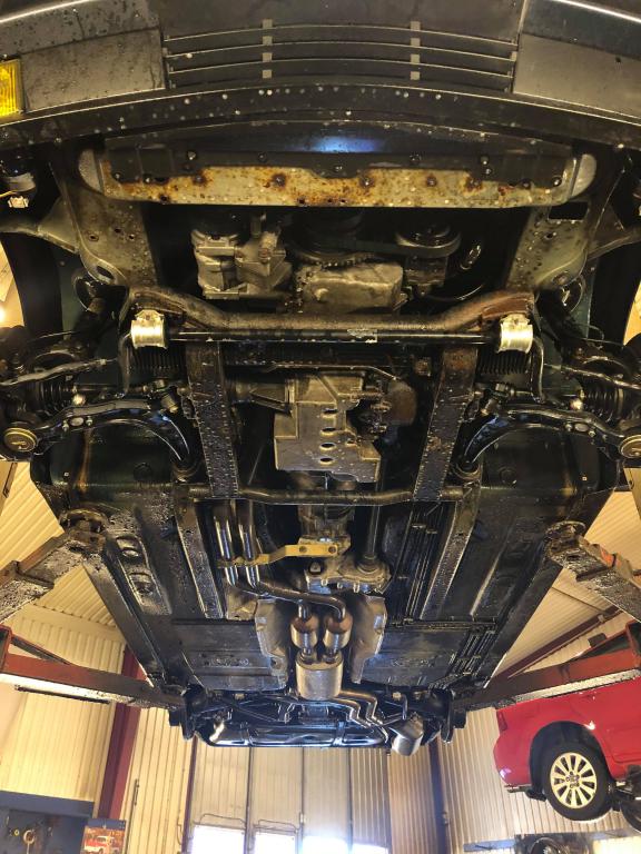

      Proper underbody cleaning and sealing:
      Click image for larger version  Name:	73113451_486816058713553_1993232483134472192_n 2.jpg Views:	0 Size:	83.6 KB ID:	10014622 Click image for larger version  Name:	74226551_631778144223803_6048212163573579776_n.jpg Views:	0 Size:	90.2 KB ID:	10014623
      Converting the minor surface rust:
      Click image for larger version  Name:	image_160050.jpg Views:	5 Size:	84.8 KB ID:	10014624
      Sealing and cavity wax:
      Click image for larger version  Name:	76654444_424687478147692_3996519544838422528_n.jpg Views:	0 Size:	115.9 KB ID:	10014625

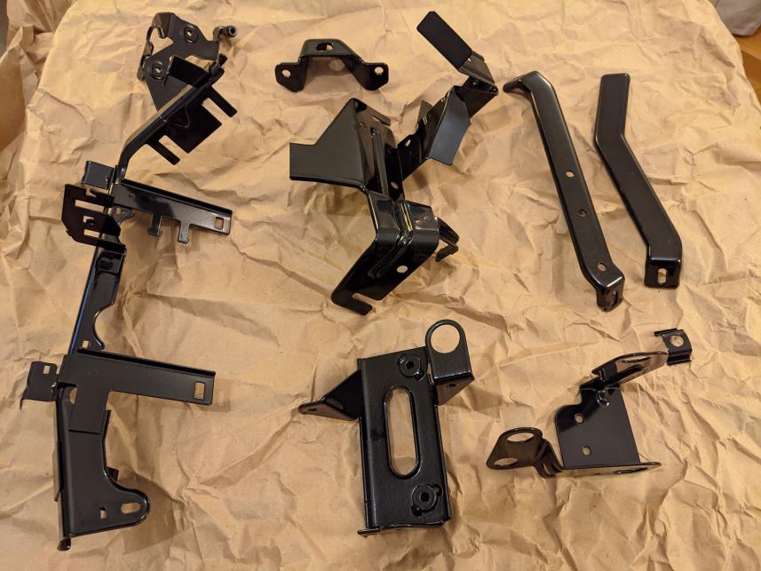

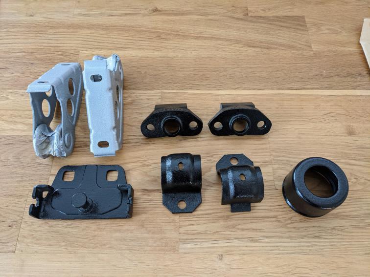

          Had some calipers and brackets powdercoated and then rebuilt them all:
          Click image for larger version  Name:	IMG_5956 copy.jpg Views:	0 Size:	75.0 KB ID:	10014634

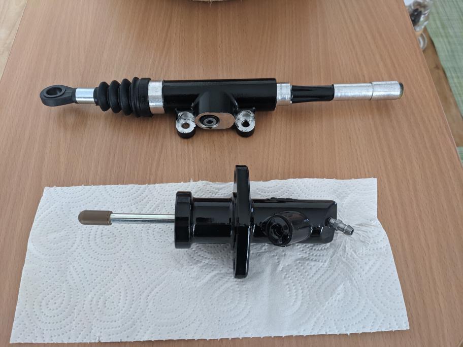

          Painted some clutch hydraulic parts (not installed yet):
          Click image for larger version  Name:	PXL_20201018_091916105 copy.jpg Views:	0 Size:	73.2 KB ID:	10014635

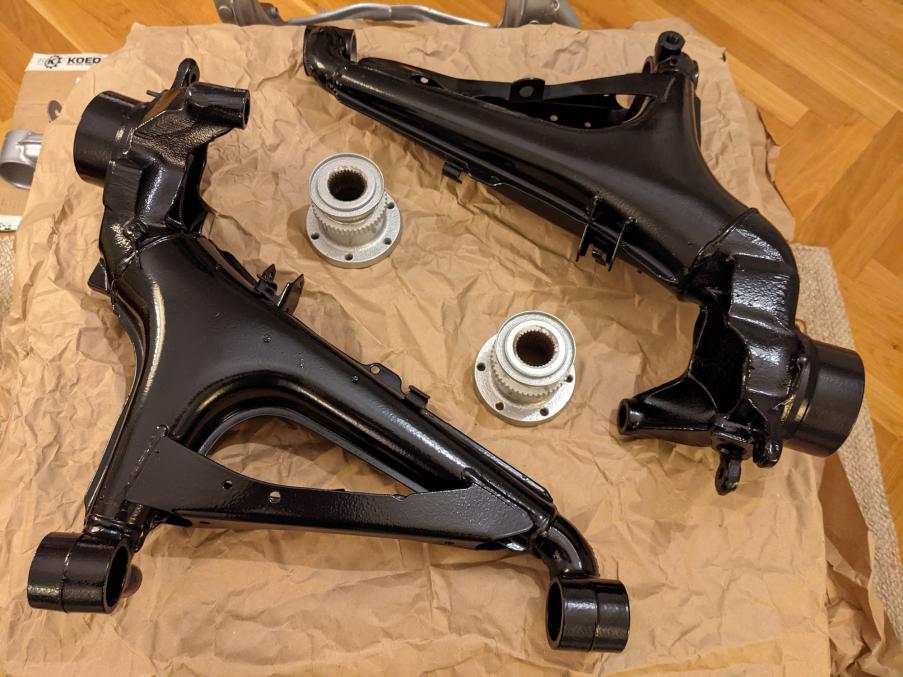

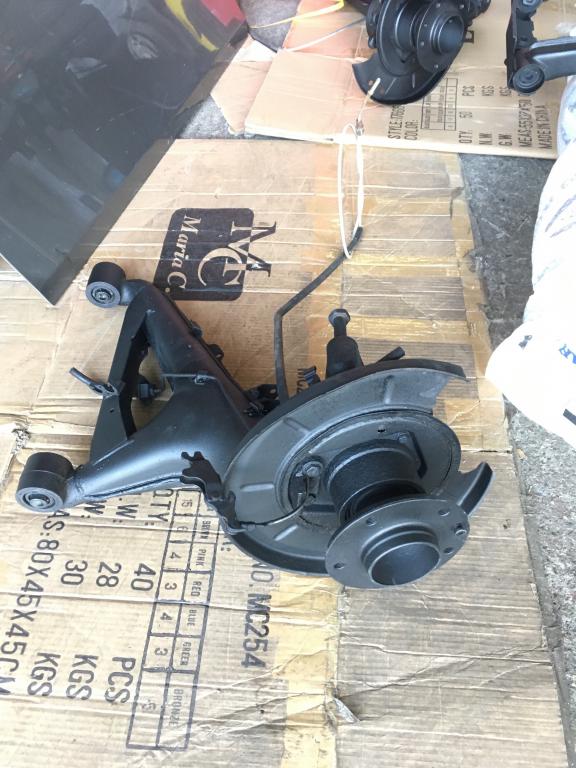

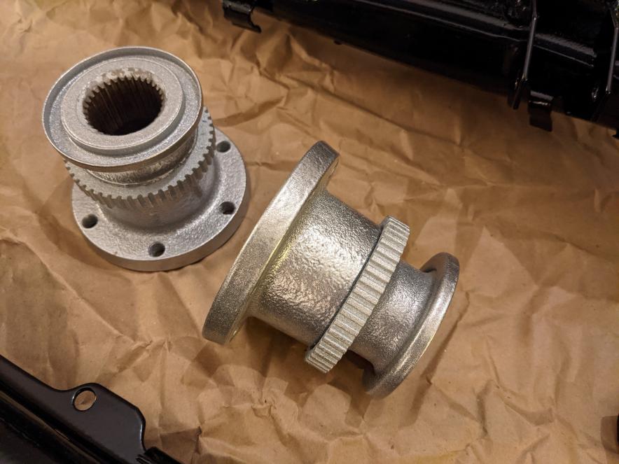

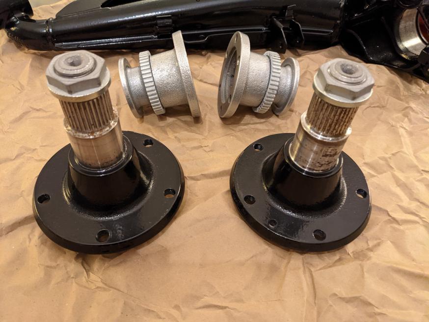

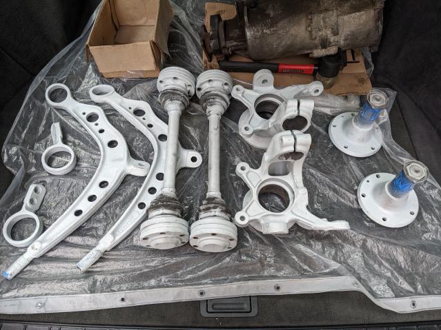

          Over the past months I've taken the original rear suspension apart and acquired other very well used spares like front control arms and spindles and CV axles etc. There is a great local business that does sandblasting and thermal zinc coating for very reasonable prices. This coating can then be painted or powdercoated over directly which results in very strong corrosion resistant parts.
ID:	10014642 Click image for larger version
ID:	10014643 Click image for larger version

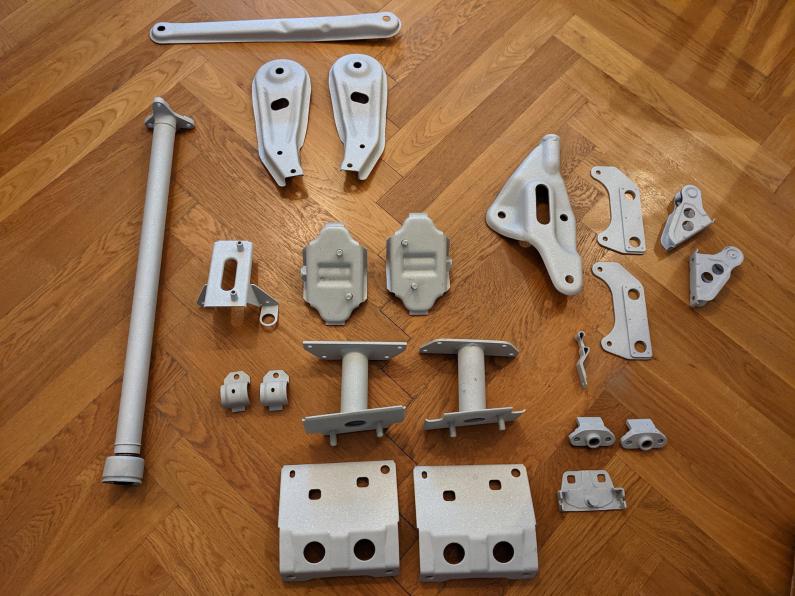

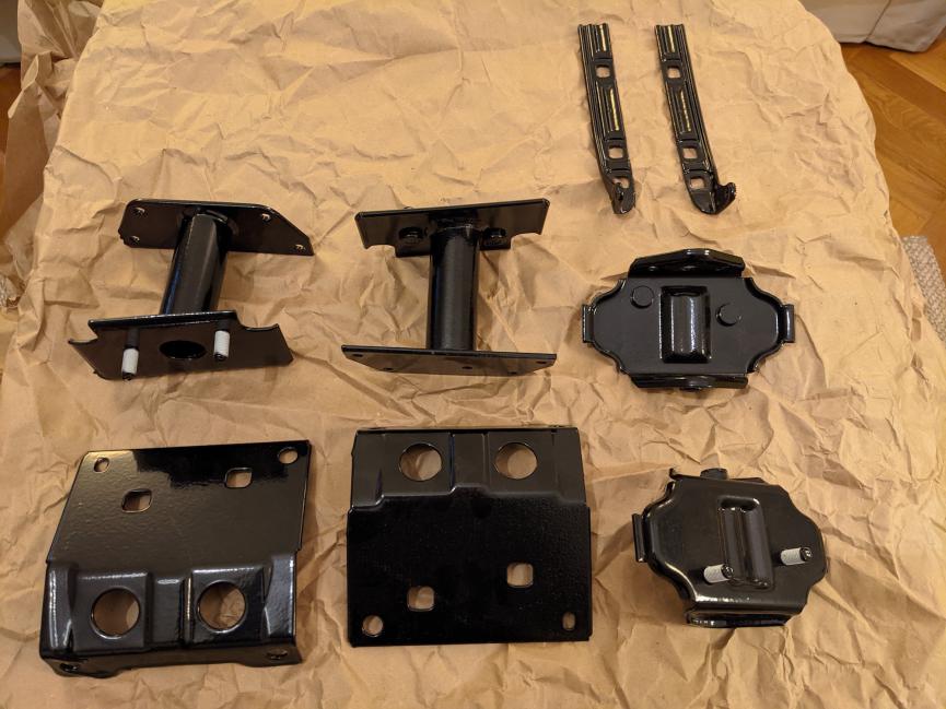

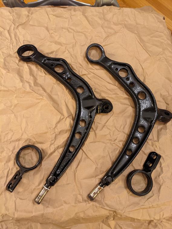

            And the rest powdercoated by another terrific local business:
ID:	10014650 Click image for larger version
            • Big Will
              • Apr 2021
              • 17
              More powdercoated parts:
              Click image for larger version  Name:	PXL_20210414_200213978 copy.jpg Views:	0 Size:	76.1 KB ID:	10014652
              Click image for larger version  Name:	PXL_20210414_202227411 copy.jpg Views:	0 Size:	77.5 KB ID:	10014653 Click image for larger version  Name:	PXL_20210414_194901611 copy.jpg Views:	0 Size:	79.4 KB ID:	10014654 Click image for larger version

                Still trying to find a solution for the control arms. BMW no longer stocks one side and the ball joints aren't available separately. I'm trying to find a ball joint that will fit properly. The closest I've come so far is the Meyle HD ball joint for the E36...the problem being that i the tapered sleeve that fits into the front bearing holders is a bit too narrow. I'd like to find a cost-effective solution so that 525ix owners have an option in the future when their control arms need replacing and there is no aftermarket.
                Click image for larger version  Name:	PXL_20210414_202730272 copy.jpg Views:	0 Size:	69.7 KB ID:	10014659
                Click image for larger version  Name:	PXL_20210414_202523533 copy.jpg Views:	0 Size:	80.5 KB ID:	10014658
                It's a project. Eventually I'll get around to installing it all and set of rebuilt SLS sport shocks and springs that are ready. I'm in the process of rebuilding axles and recently found a shop in Poland that could manufacture a copy of the short driveshaft that goes between the front differential and transfer case or a much more reasonable price than buying a BMW one. I just have to figure out exactly how long the splines should be as the original design only engages a small amount of the spline in the transfer case. It would be better to engage more or all of the splined flange. "Improved" copy vs. a worn original:
                The new splines will have to be cut at some compromise between the original and the copy (76mm long spline). The original splines are 26mm but only 18mm are actually engaged based on the wear both in the transfer case and on the driveshaft. The splines inside the transfer case flange are 44mm long. Therefore the "improved" driveshaft should have splines that are either 44 or 52mm long. If anyone has insight into this I'd be grateful. This could be a good option for E30ix and E34ix folks in the future.
                Click image for larger version  Name:	PXL_20210415_171045571.jpg Views:	0 Size:	66.7 KB ID:	10014660
