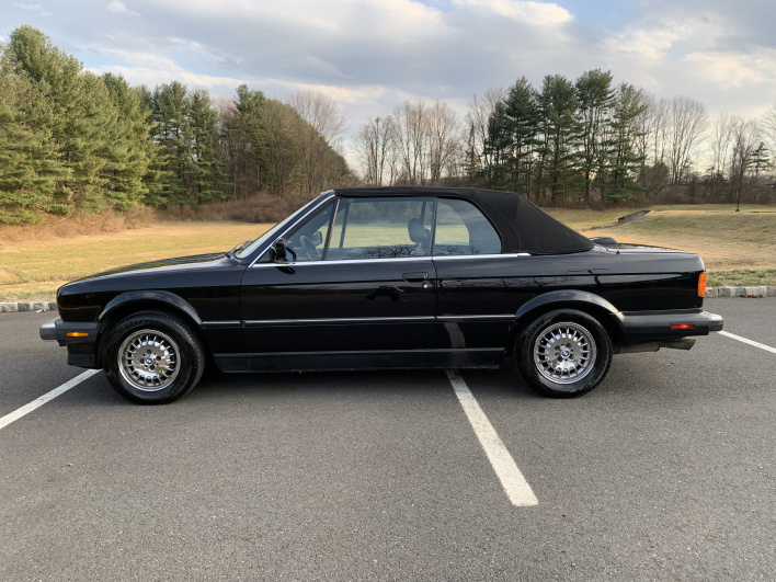

    Here are some pics from when I picked it up
Name:	Inked e30 before.jpg
    ​Click image for larger version
Name:	Inked e30 before 2.jpg

    Here is how the car sits now after a quick wash. Can't wait to do a real detail to see how the paint looks at its full potential.
Name:	Inked e30 front.jpg
Name:	e30 driver side.jpg
Name:	e30 pass side.jpg
Name:	e30 int 1.jpg
Name:	e30 int 2.jpg

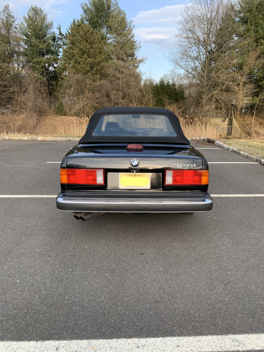

      Here's one more from the back, cleaning that plastic window was so satisfying. Also, a pic of the F30. I love having the same car so many generations apart. Its nice to pick up on the similarities.
Name:	340 top view.jpg
