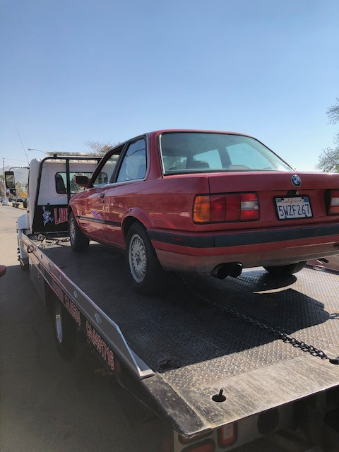

    The beginning of the story with the Unwanted Ginger begins in 2019. SALVAGEDTITLE, I picked this car up in Costa Mesa CA, 115k on the clock ran horrible, dents everywhere, cracked front and rear bumpers, paint oxidized and burnt with a buffer but it had some poly bushings, black interior swap, 4.10 LSD, stainless exhaust, new fuel tank, euro clock, a tight 5 speed but most importantly great panel gaps, drove straight, and it paid just 3 grand. My plan has evolved slowly with this one but mirrors my other plans with my cars. I look to get the most out of each one without going overboard. Sometimes I fail at this As I am aware you do not live forever. So far this one has had a replacement engine with every gasket, seal and wear component changed, crankscraper, new rebuilt head with Bimmerheds 274 cam and valve train. squid chip, New OEM bushings at the trans, engine and differential. Differential swap to a medium case 3.73 LS unit. new control arms, treehouse FCAB, balanced driveshaft, DSSR, Koni sports, H and R sports, rear drive shafts.

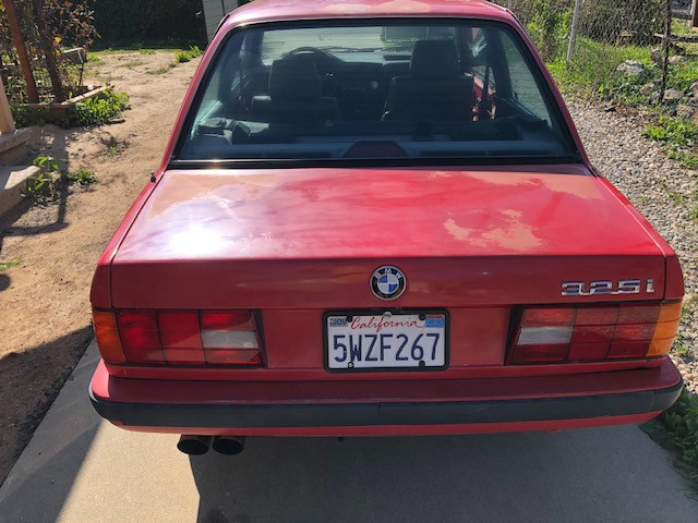

    Unwanted Ginger Pictures,

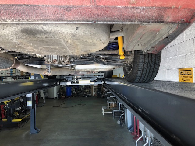

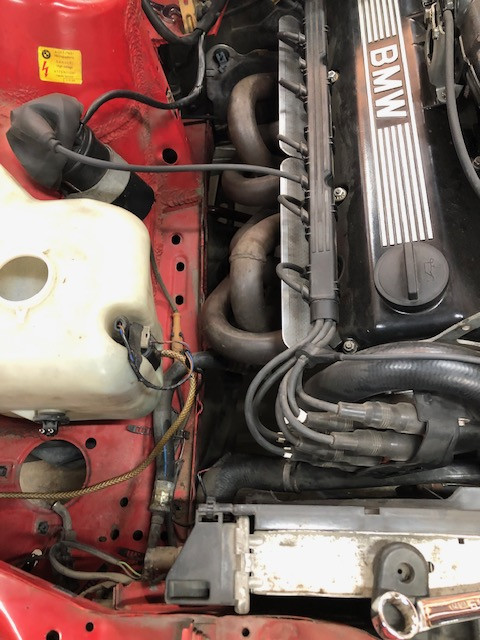

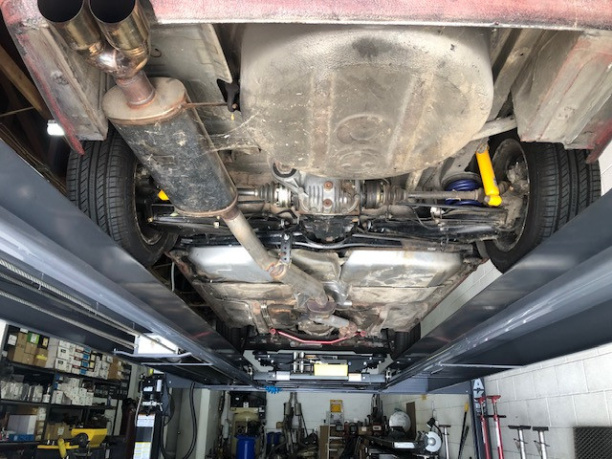

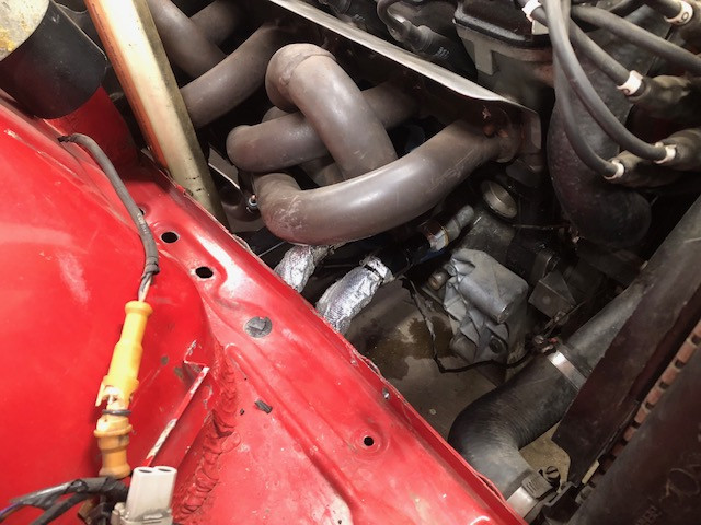

        Ginger is having a more driver friendly exhaust adjustment. the PO installed this exhaust and its constantly hitting things. Looking under it it appears to be not tucked up in the provided space. I picked up some RD shorty headers and have Hector at extreme mufflers in Riverside ca working on it. Before pictures

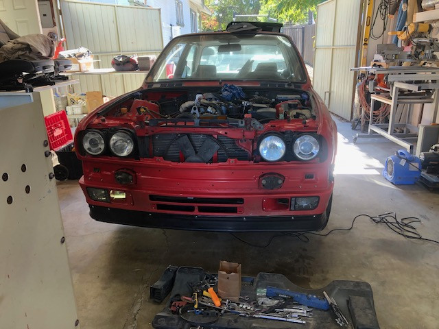

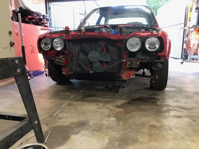

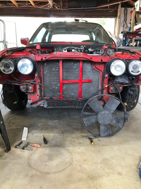

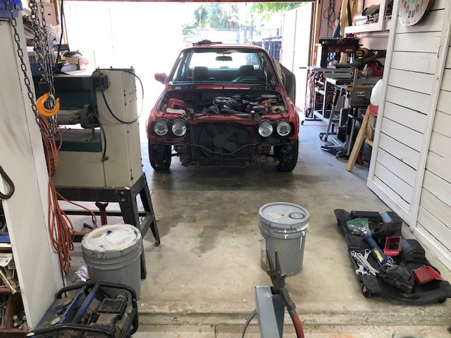

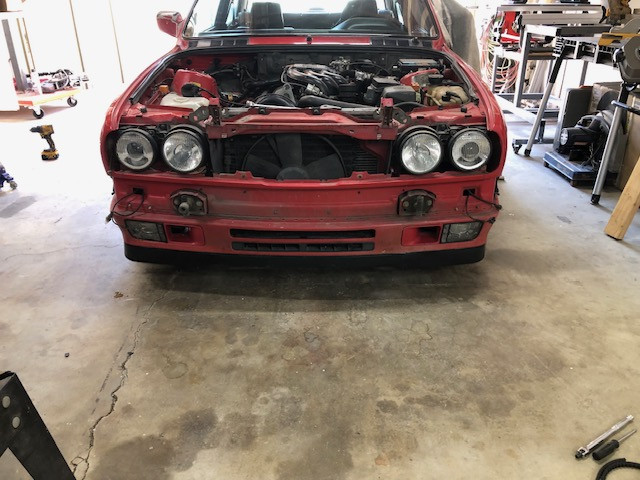

                Using the Labor day weekend to do car stuff. AC delete as the lines are touching the front header.
                • OSAH racing
                  • Apr 2022
                  • 244
                  A.C delete is almost complete. This is because I do not use the AC in this car. When its this hot it stays in the garage. My 2017 Silverado has proper AC. The 20lbs it lost is not a thing either. I am not chasing weight loss. The back seat is staying in too since it looks better in than out to me. I used steel strap and the O.E.M rubber bushings.
                  Next up is to cap the lines in and out of the cabin and a heat shield for the washer fluid tank.

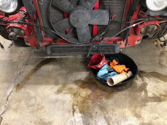

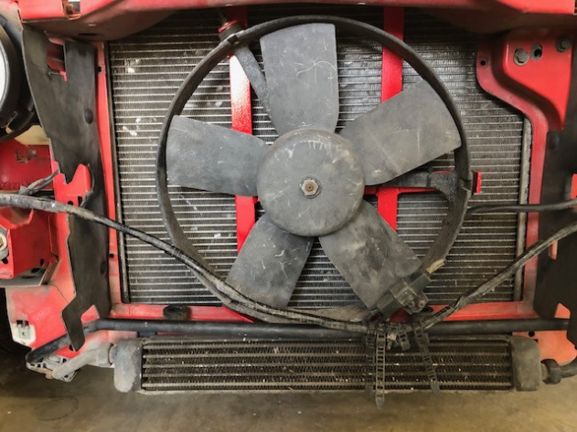

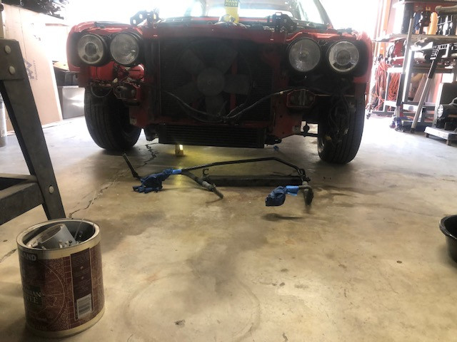

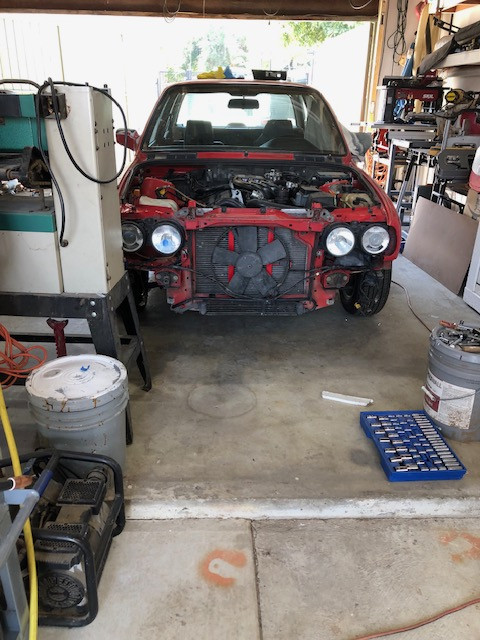

                      While your in there. A New CSF DTM oil cooler came up for sale near me so I decided the timing was perfect since the front parts are off Ginger. That decision rolled into several others.
                      • OSAH racing
                        • Apr 2022
                        • 244
                        Click image for larger version  Name:	IMG_5011 (1).jpg Views:	0 Size:	151.6 KB ID:	10130646 OEM fan and Oil cooler
                        Click image for larger version  Name:	IMG_5050.jpg Views:	0 Size:	113.8 KB ID:	10130647 Click image for larger version  Name:	IMG_5056.jpg Views:	0 Size:	84.1 KB ID:	10130648 Click image for larger version  Name:	IMG_5070.jpg Views:	0 Size:	99.5 KB ID:	10130649 CSF Oil Cooler Click image for larger version  Name:	IMG_5071.jpg Views:	0 Size:	100.4 KB ID:	10130650

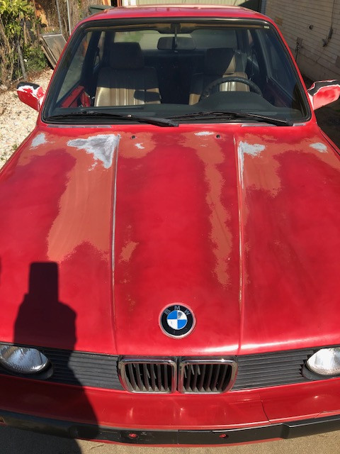

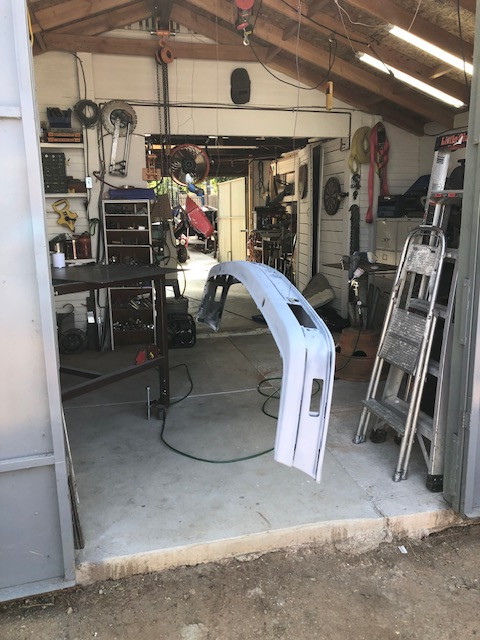

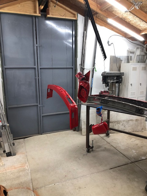

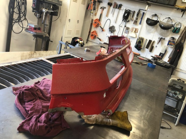

                          Click image for larger version  Name:	IMG_5021.jpg Views:	0 Size:	108.8 KB ID:	10130652 Replacement front bumper cover. One small crack instead of the broken OEM piece is an upgrade.
                          I took on the task of painting it along with the peeled paint on the mirrors, grill pieces and the chrome rain gutter (more on that later as I had a difficult time getting a good result). Click image for larger version  Name:	IMG_5036.jpg Views:	0 Size:	91.1 KB ID:	10130653

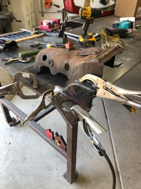

ID:	10130655 Side project. My friend with $ from the Porsche world loves to buy restore and resell Porsches. Welded on a replacement corner for him.
