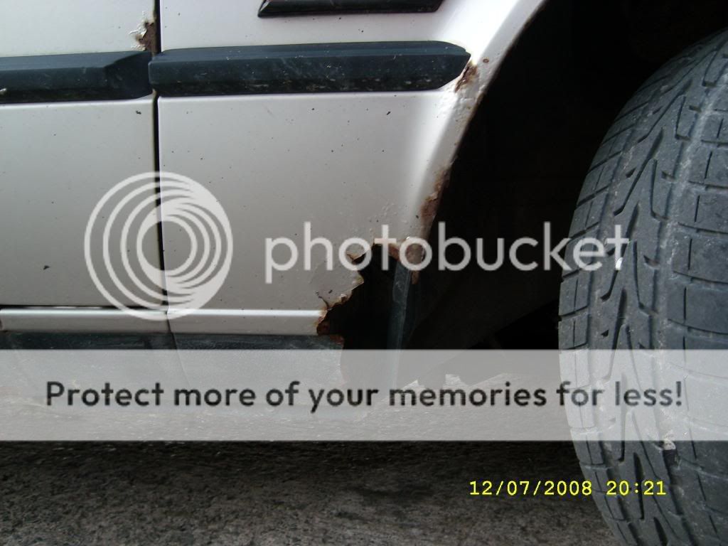

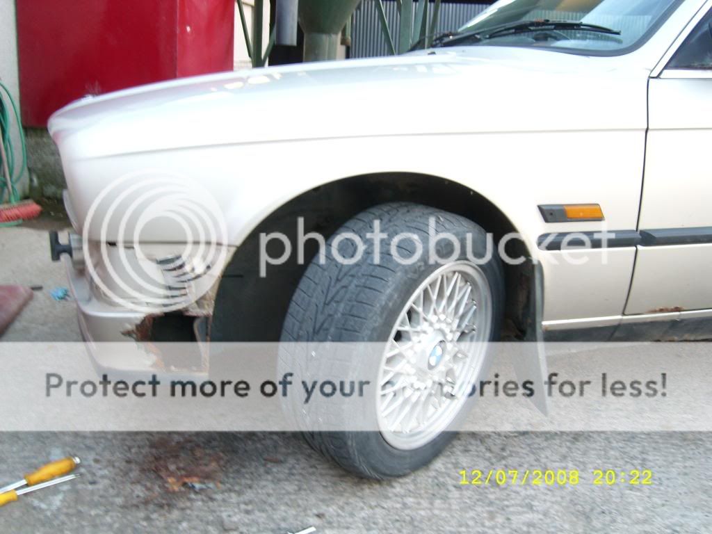

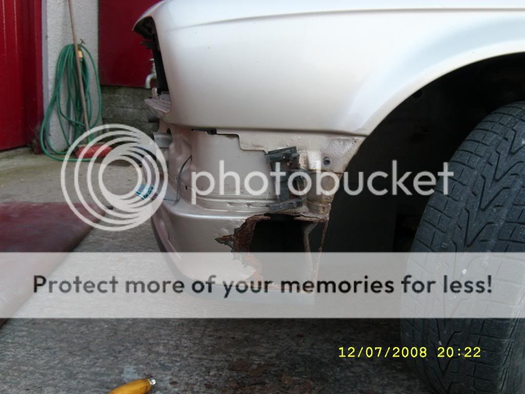

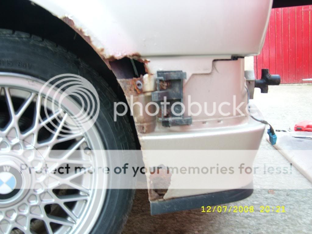

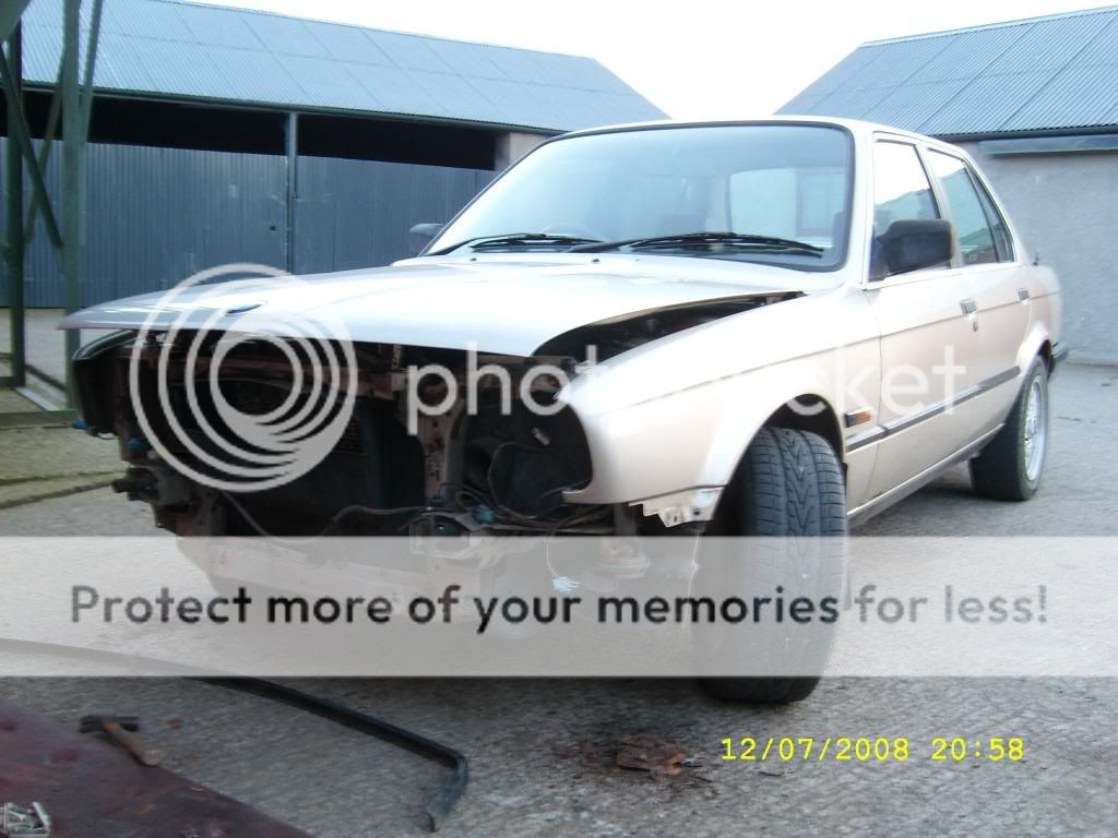

    Here she is, in need of alot of love, but shes come to the right place!
    Bronzette beige 1989 320i.

    Looks like the cancer got you good on that one, Best of luck!
    • shmutzigE30
      • 1680
      i hope your replacin the fenders and valence and not just patching shit up.
      good luck

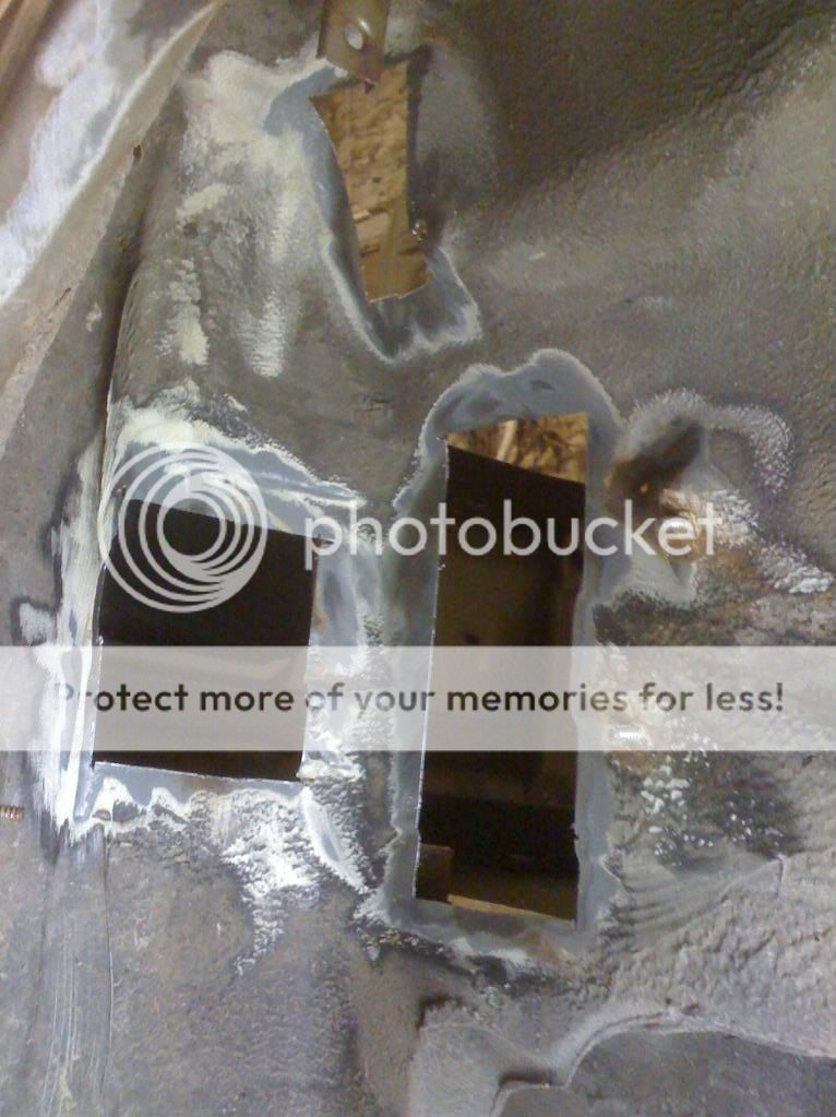

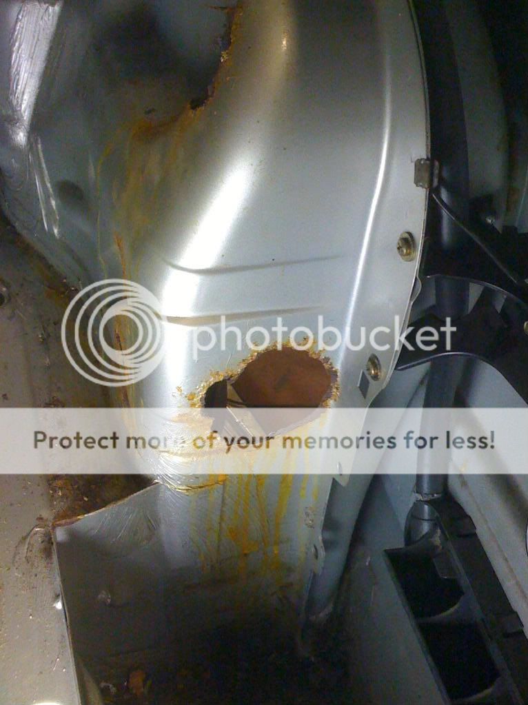

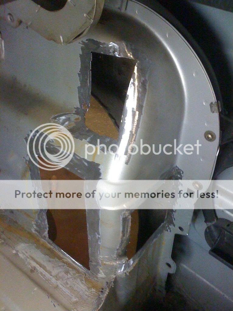

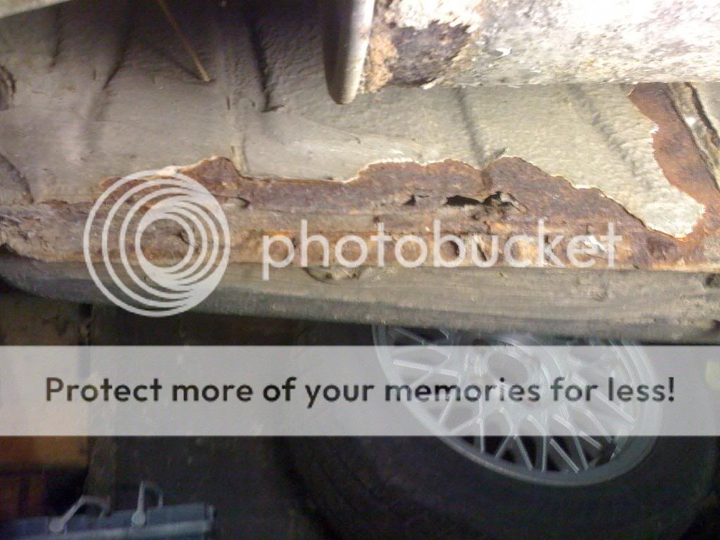

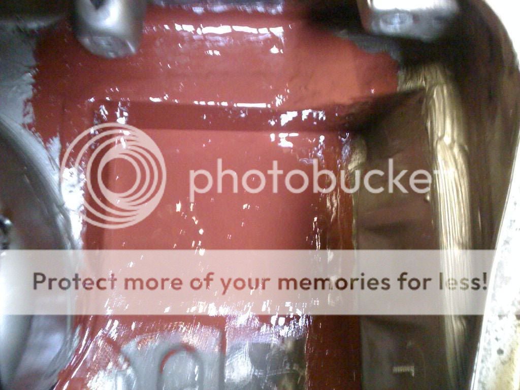

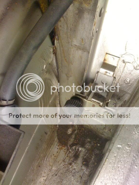

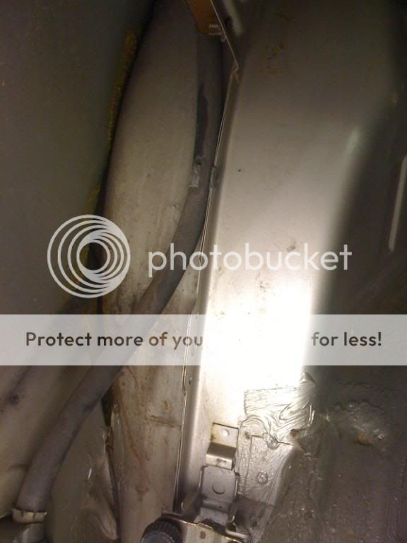

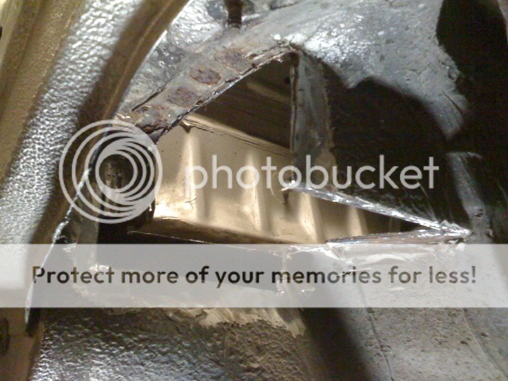

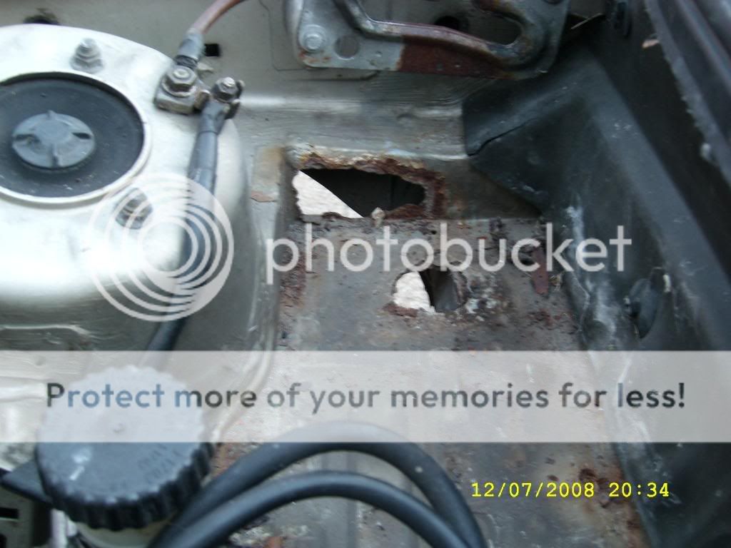

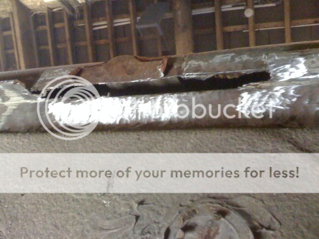

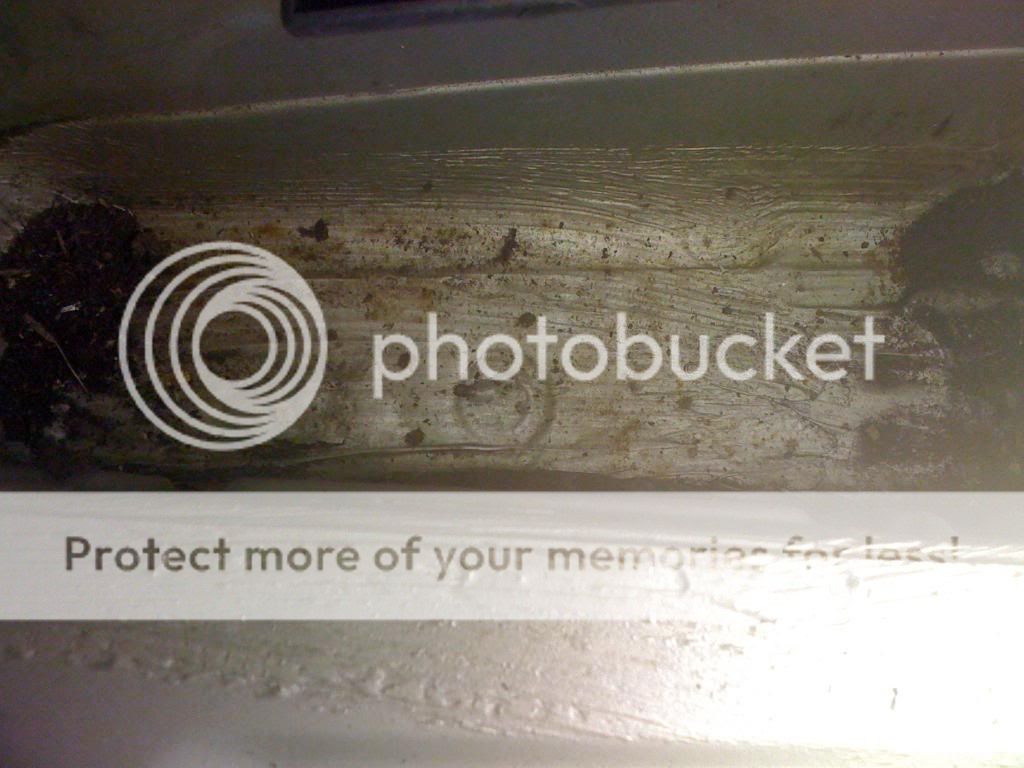

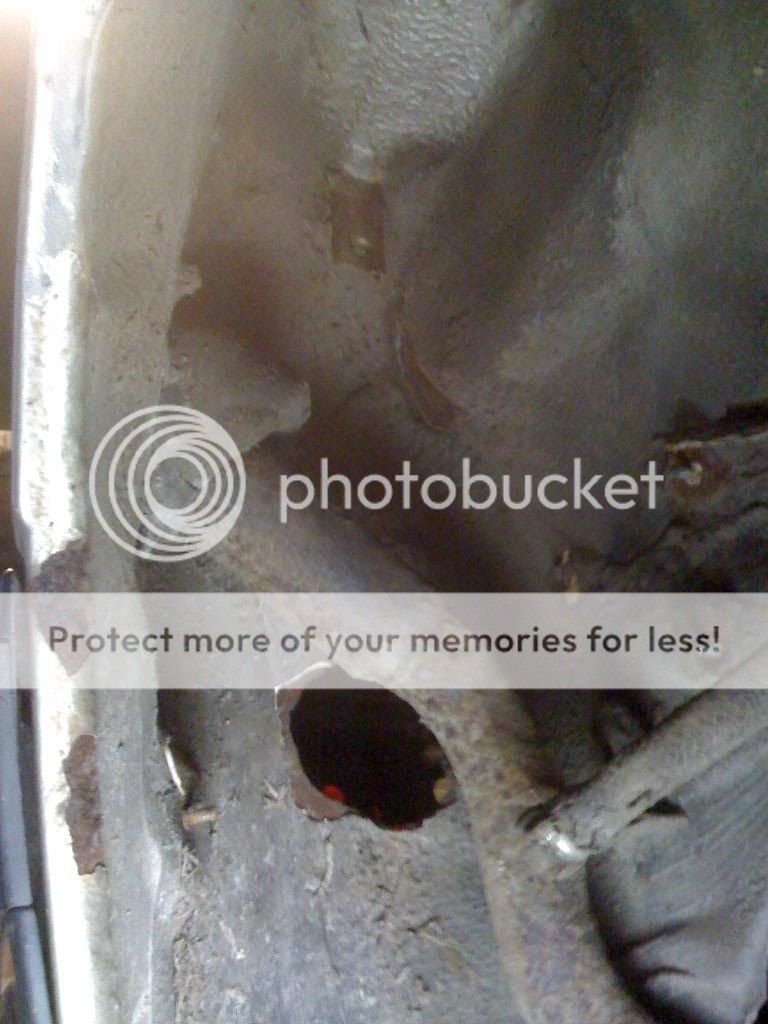

        Heres a few more

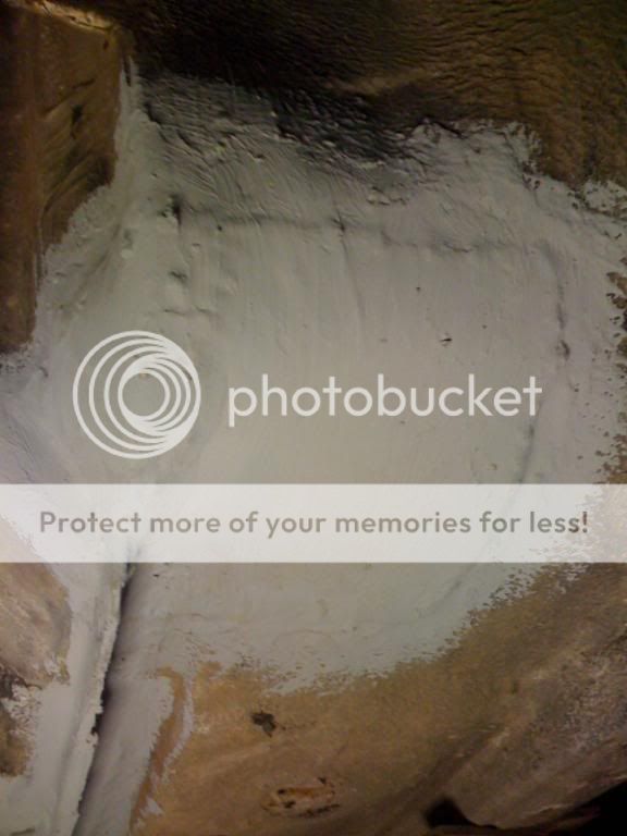

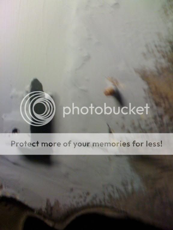

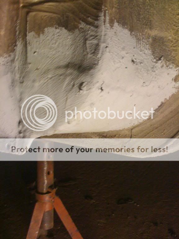

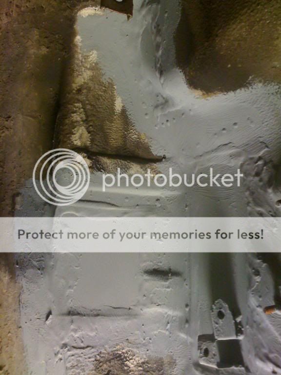

        Battery box cut out and ready for patching.
        This is battery box patched and primed.

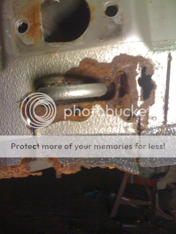

        Small patch needed on the sill.

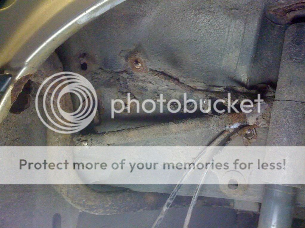

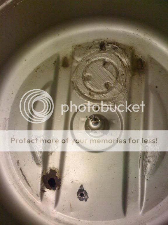

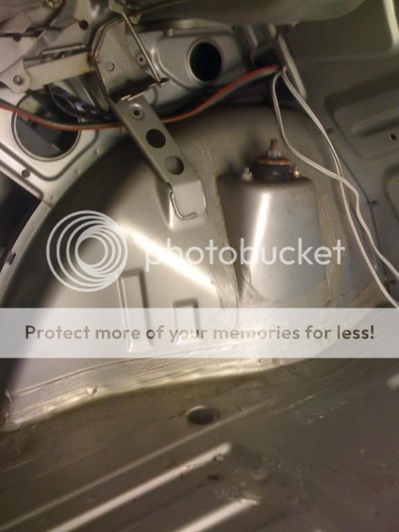

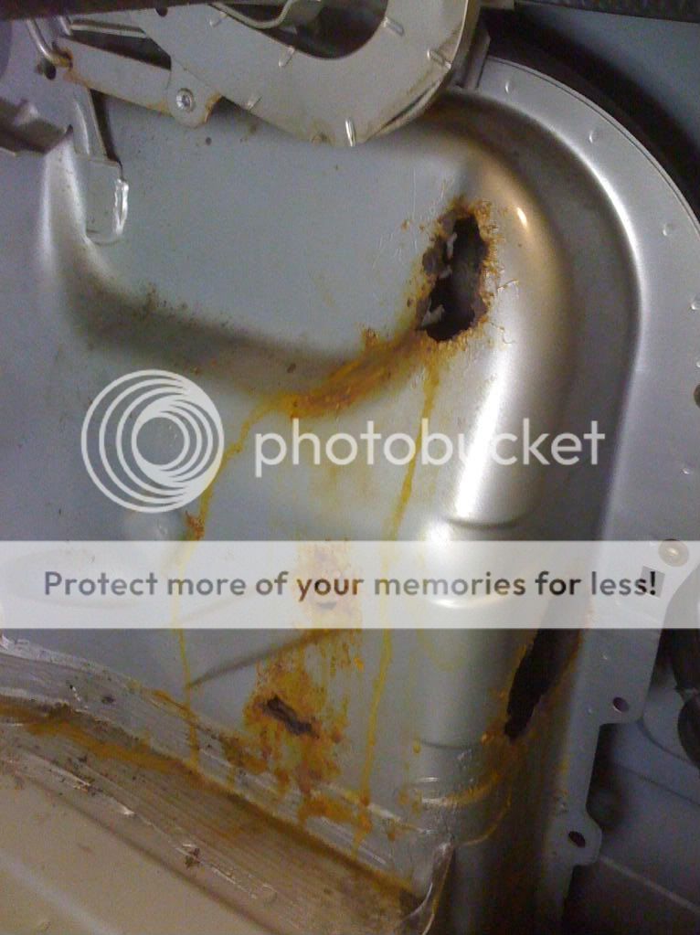

        Didnt think the back end was just as bad, but, when I got the boot carpet pulled out there were a few horrors :shock:

          Looks like it. Nice work so far, Keep us posted, I'll be watching!

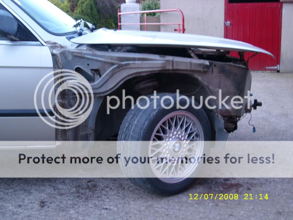

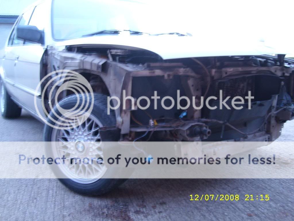

            Cheers guys, yes I've got a valance and wings for it. This is what you get after 20 years from having salt on the icy roads in winter

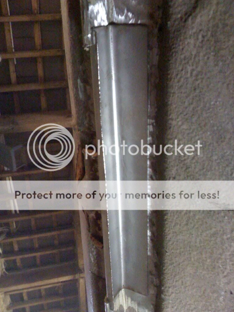

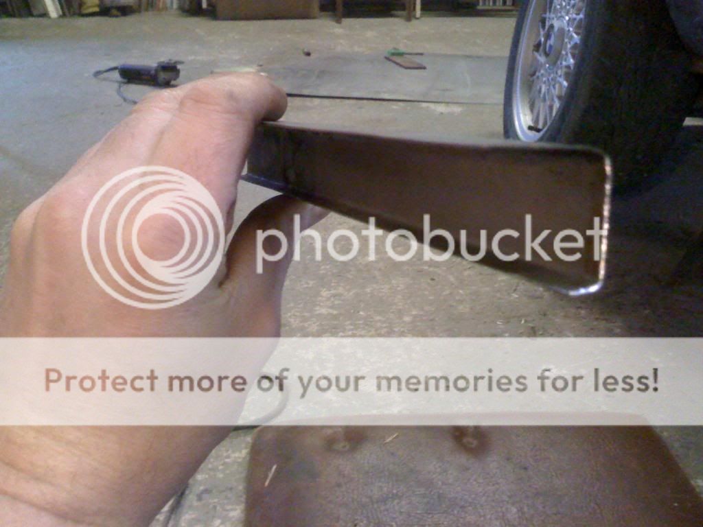

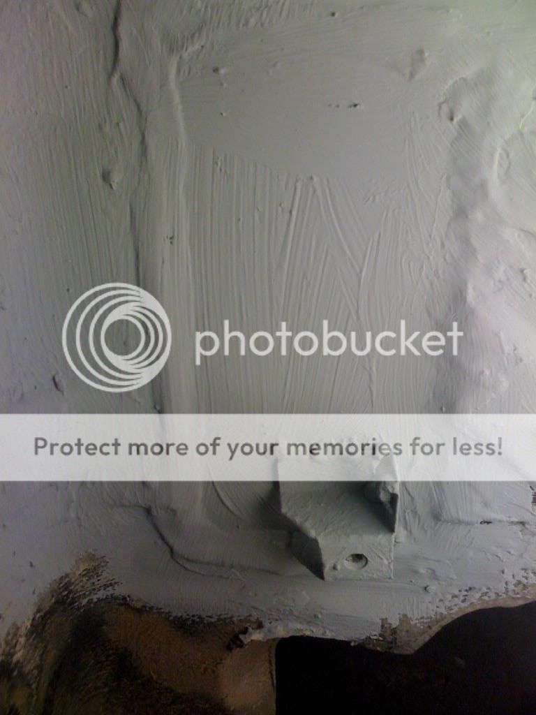

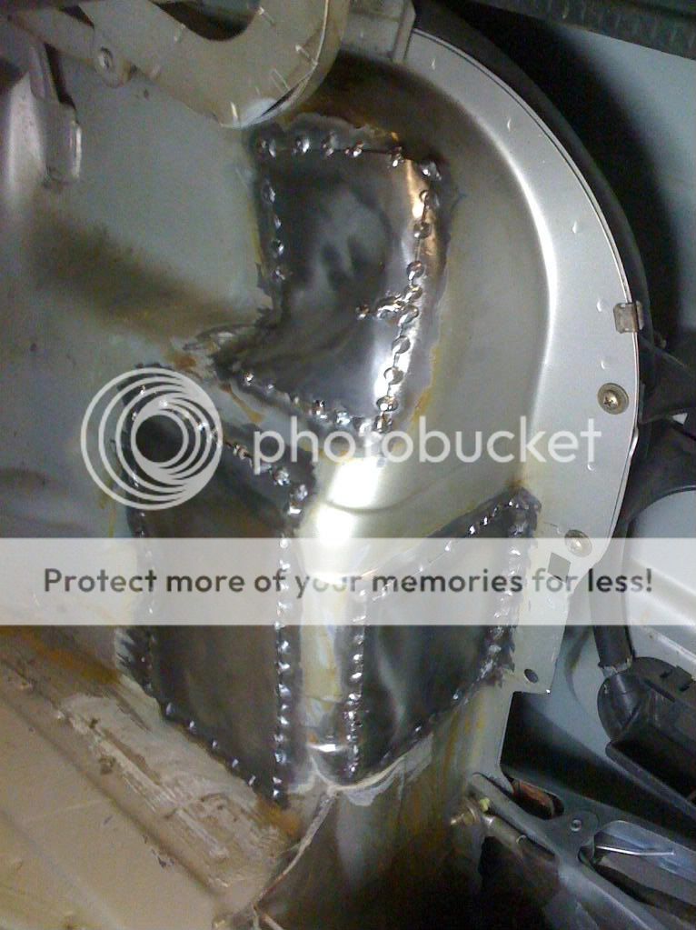

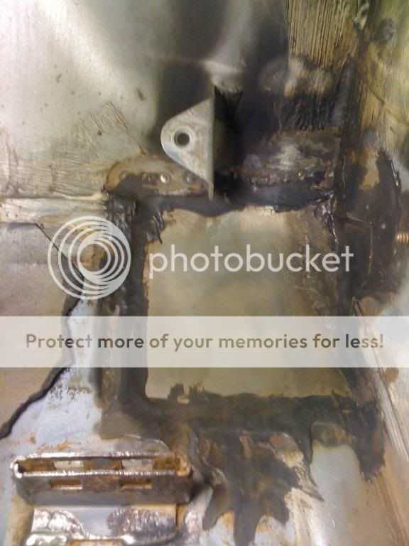

                Rear wheel housing patched and primed with new bracket made and fitted

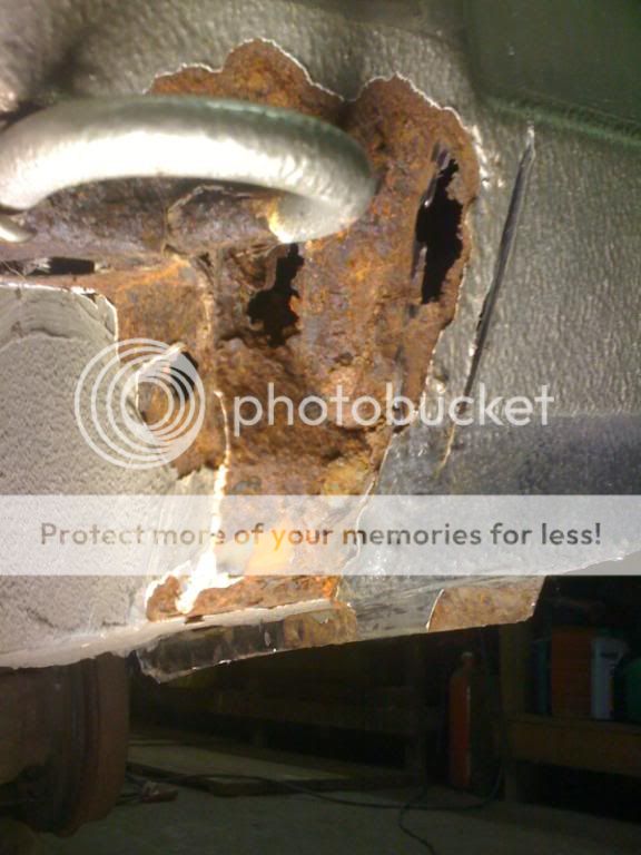

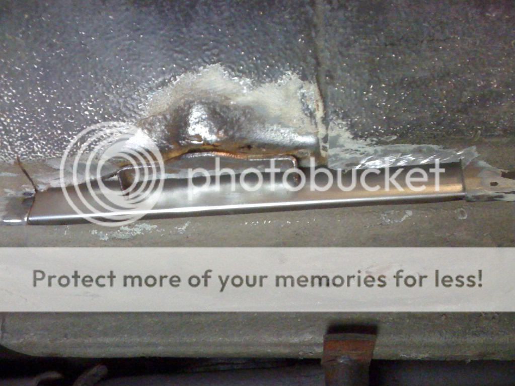

                Drivers side jacking pad cut out and patched, I didn't replace the pad this time as it only holds dirt and will rot again and it will be more stream line
                Rear valance is pretty bad, was going to cut one from a scrap car just below the bumper but it was worse than mine so I'll try to form one myself
                The boot floor and near side arch and wheel housing is very good, the bottom of the pocket is good but the side needs patched. I've taken a shot of it but haven't started to it yet.
                I'll get more pics up when I get more work done.

                  Yep it is, but I'm doing the work myself so its not costing me anything for my its about keeping another E30 alive 8)
