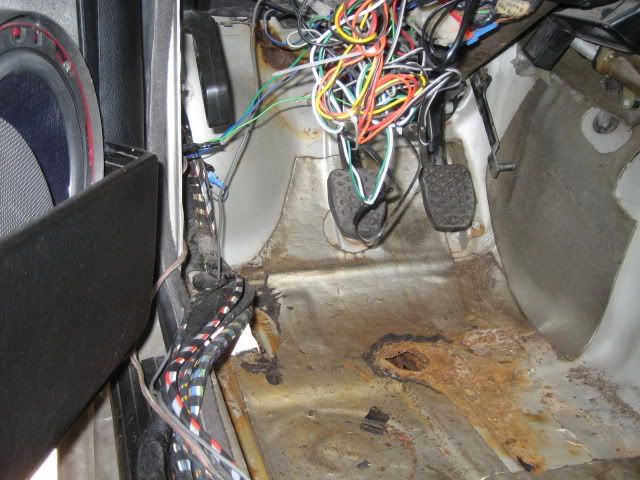

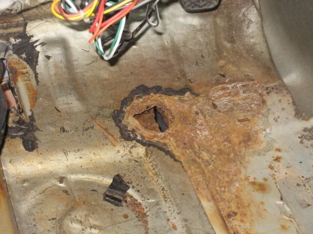

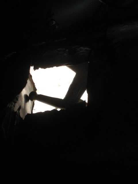

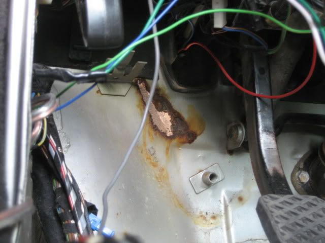

    Fast forward to this spring...the car clearly needed some work so I tore out the carpets to see the damage. Here are some carnage pics:
    (Same hole, other side)

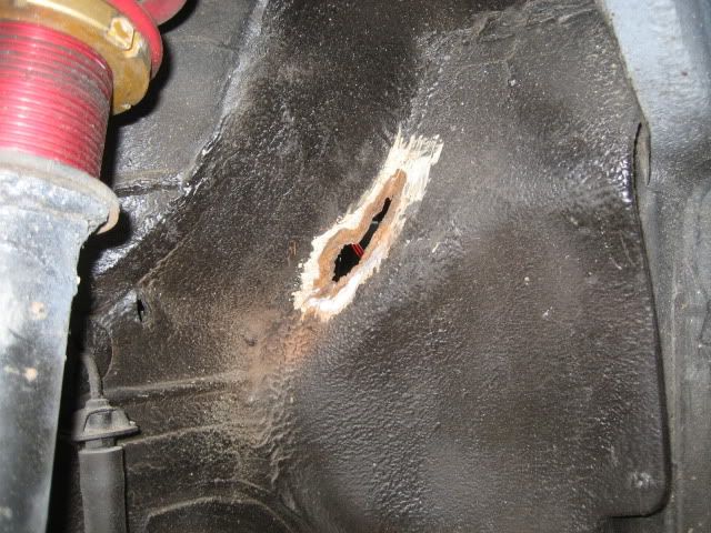

    (Underneath this hole in the floor was a hole in the frame)

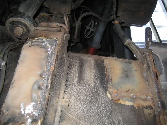

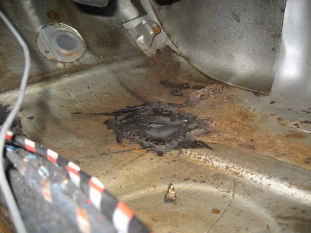

    (This is after we cut all the garbage metal from this area)
    (Family pic)

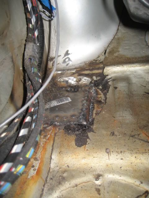

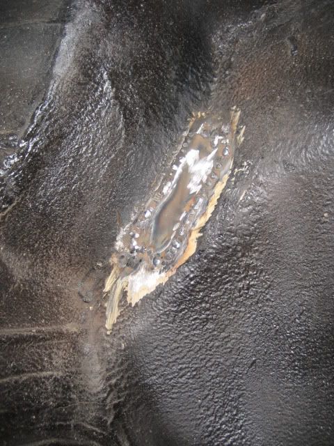

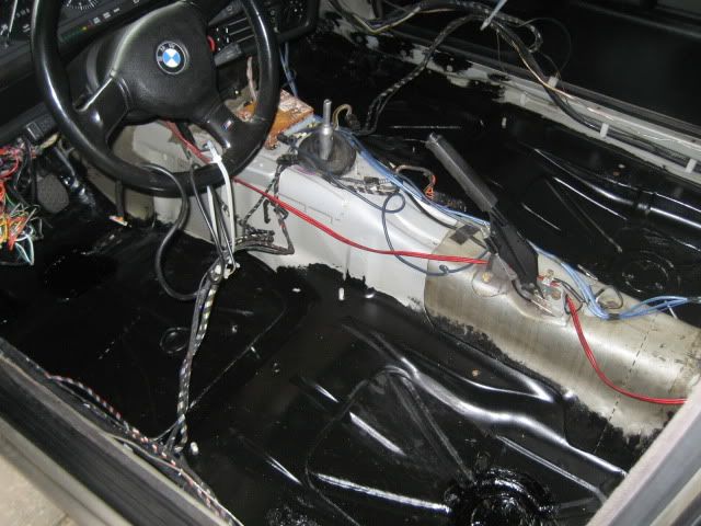

    My old man is a jack of all trades so he went to town with the mig welder and some 16ga steel and we ended up with this:

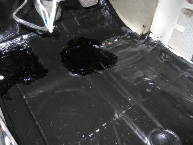

    So I never ever have to deal with this again everything was sealed up with POR-15 and all the patches got a treatment of undercoating:

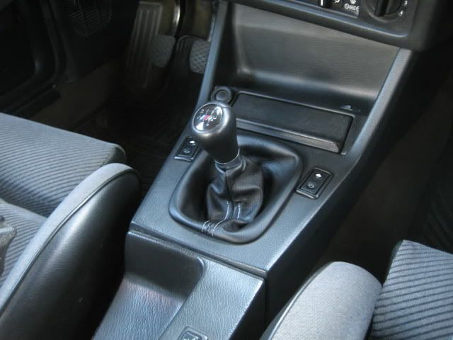

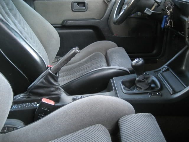

    My brother bought me a new shift boot and e-brake boot for my birthday so it went in when the interior was reassembled. While the centre console was out I figured why not retrofit some E36 window switches.
    Here are all the leftover bits after reassembling the interior. The black plastic nuts and white inserts are there because I bought too many, the window switches because they were replaced, and the rest I just plain forget where they went.

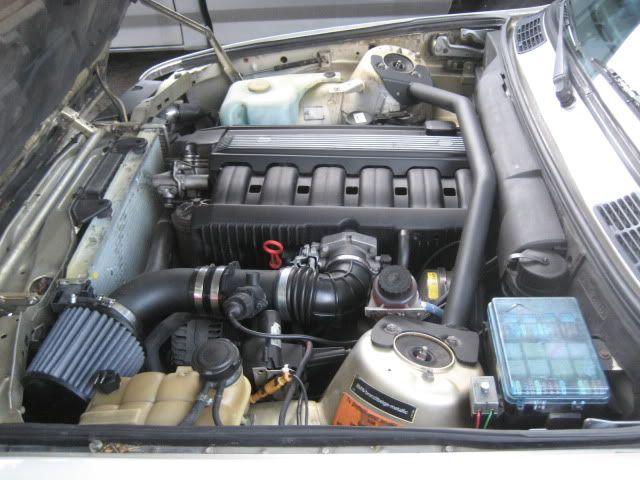

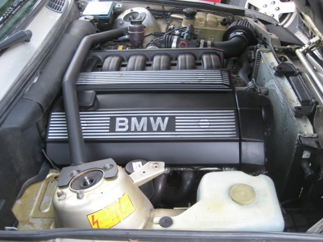

    The engine bay got a little love also. I got a new cone filter, black coupler, proper M50 valve cover cover to replace the S50 one it came with, and painted the strut brace and intake arm textured black.
