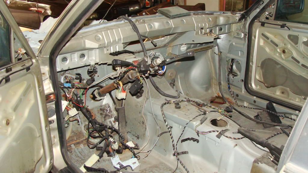

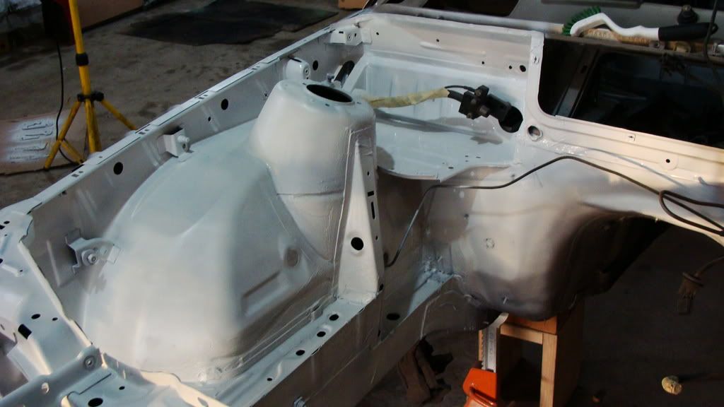

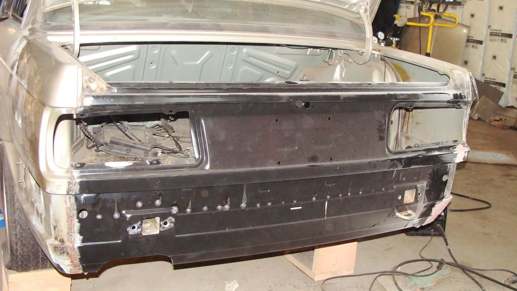

    I quickly dismantled the entire car. Front to back, top to bottom. I erected a sandblasting booth around it and went to town. Rust? Yeah right.

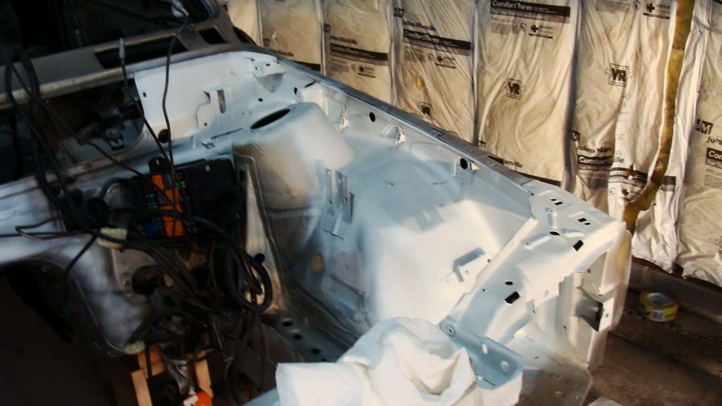

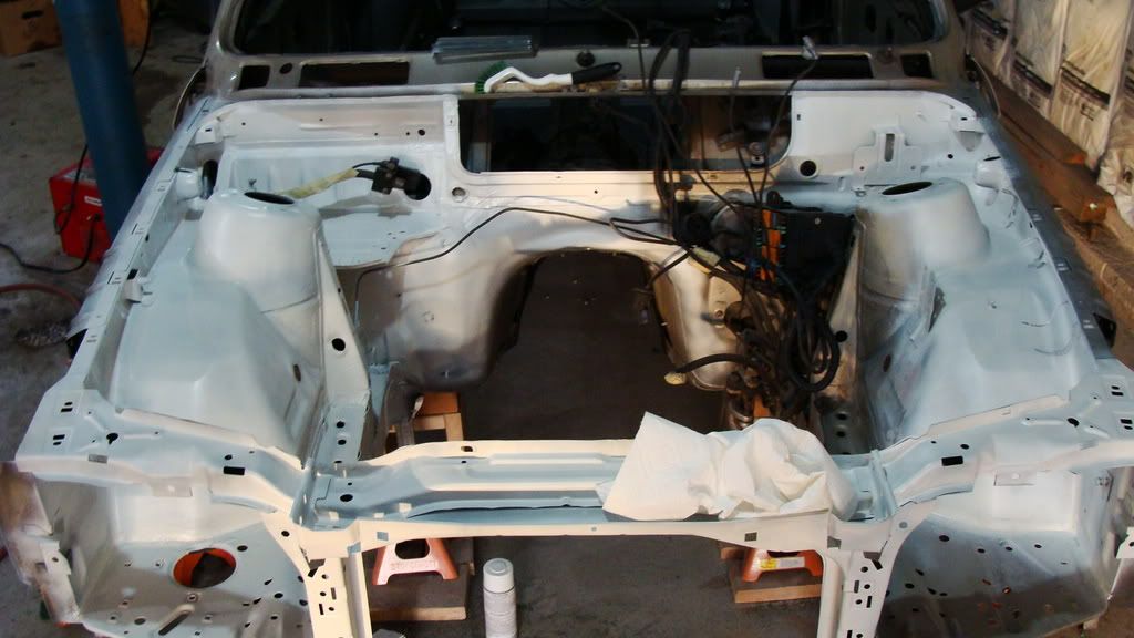

    I patched up the floor and cut off the rear body panel. Seeing as how I worked for BMW at the time, parts were cheap and readily available. So, a brand new rear body panel I welded on. Next, I removed all unattractive bracketry from the engine bay itself. Then laid down some primer and painted the crap out of it. White was going to be it’s new shade.

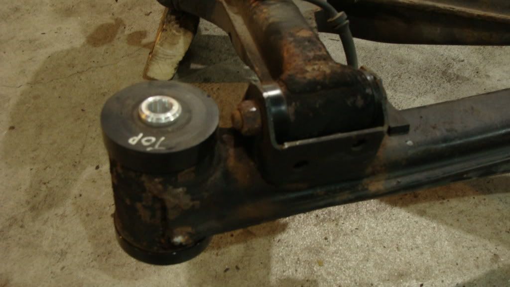

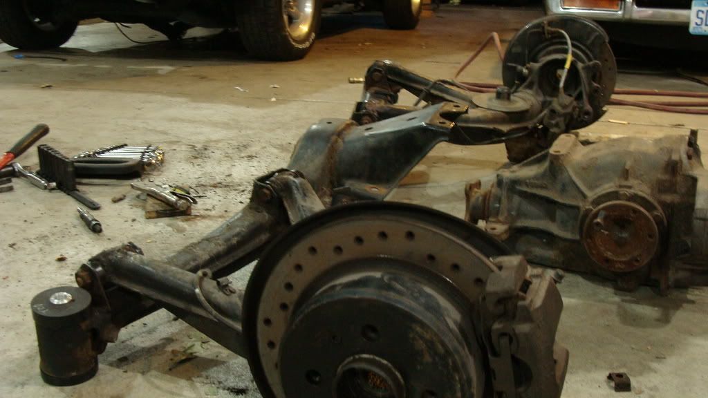

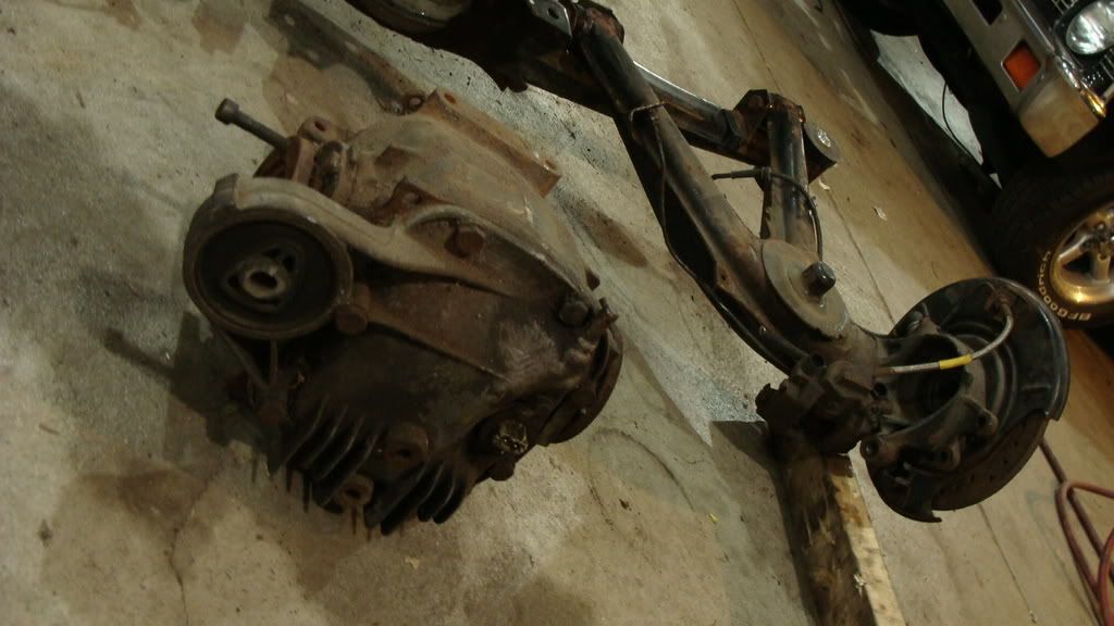

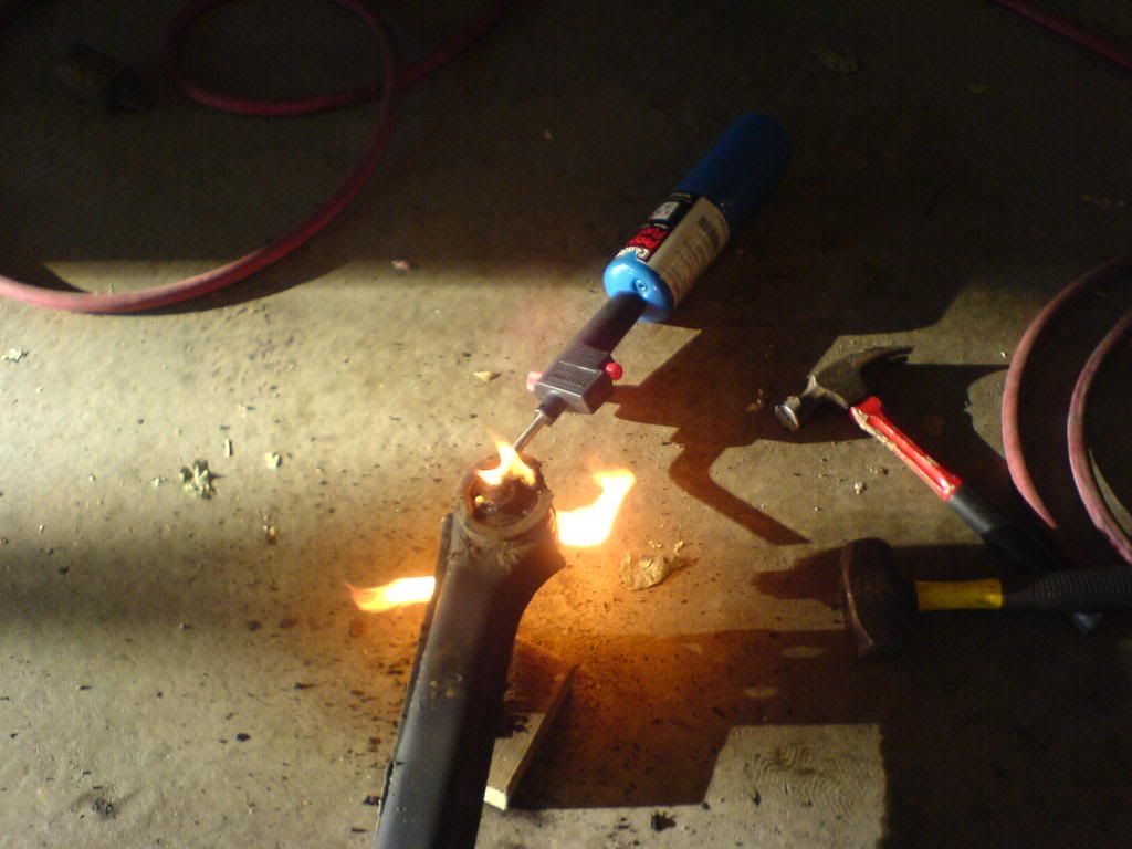

    Next was the rear suspension. I had problems with my old E30 and having terrible rear end issues. So, to make sure I never had to deal with that again, out came the rear subframe. Of course being from MN the inner bushing sleeves broke off in the chassis. That was a fun few hours getting that out. Every bushing in the rear was replaced with shore 75D polyurethane from AKG. Even the diff bushing on the new 3.73LSD I found for $100.
    Stainless lines, new e-brake cables, and Bilsteins also found there way into the mix.

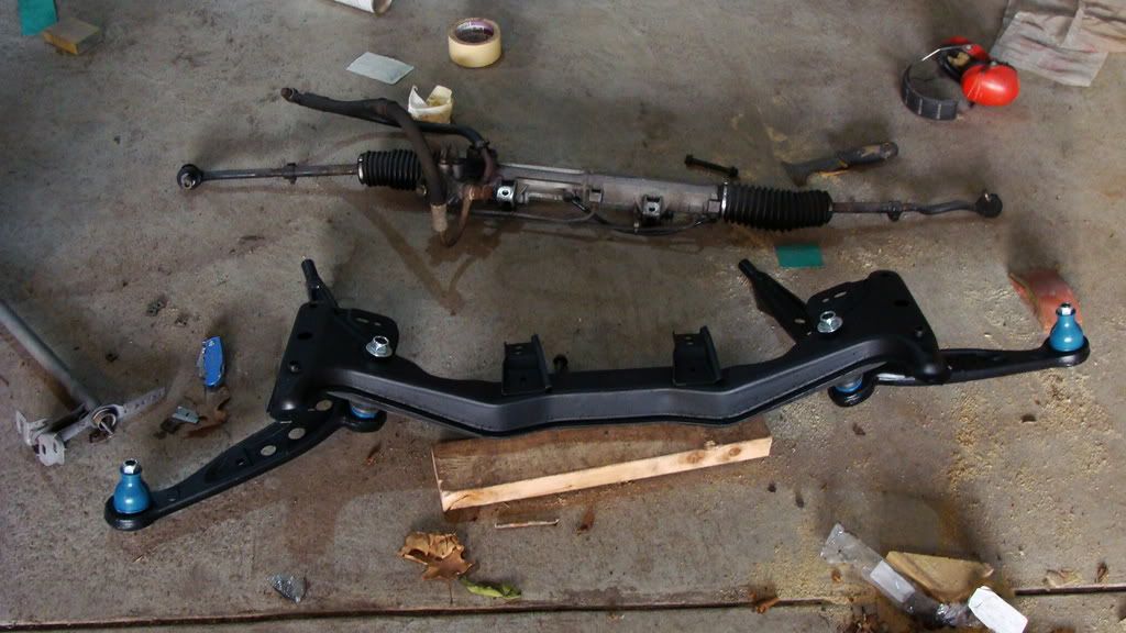

    The front subframe was next. It was removed, cleaned and painted. It also got new inner and outer tie-rods, new control arms, and Treehouse Green CABs.

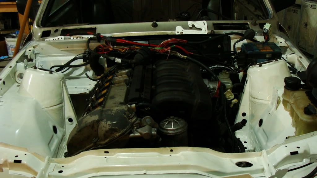

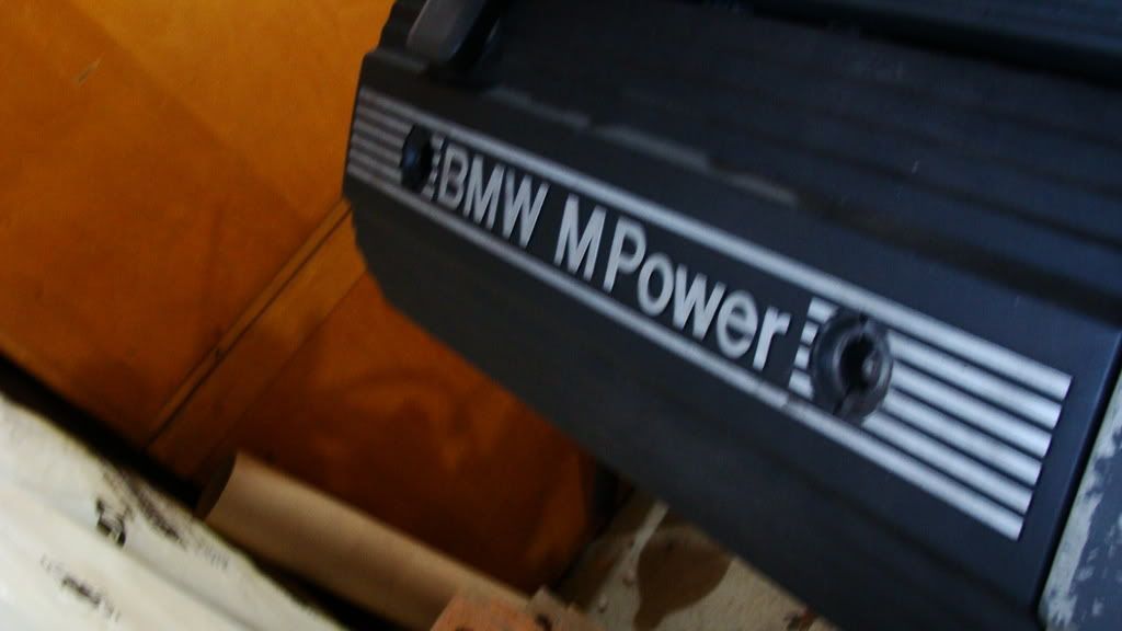

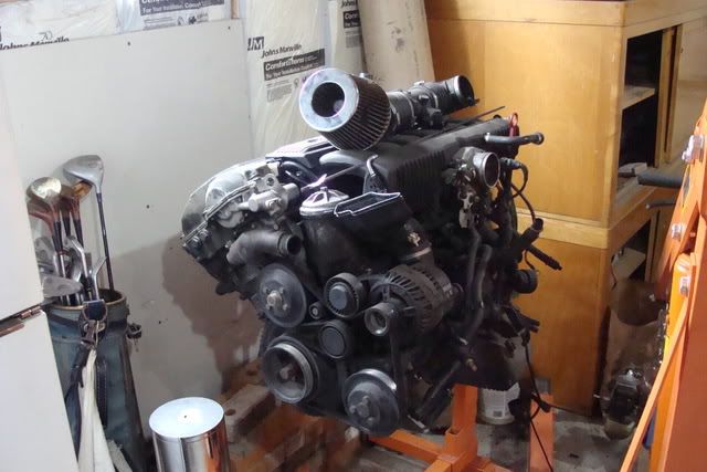

    Now, what you weren’t aware of yet, is that I have a full 95 M3 drivetrain in my garage. Radiator to diff cover. I received this jewel for performing a Euro S50B32 swap in my friend’s M3. Complete with 6-speed and Euro polished gear race diff. That car was insane for more reasons than just that. But, I digress.

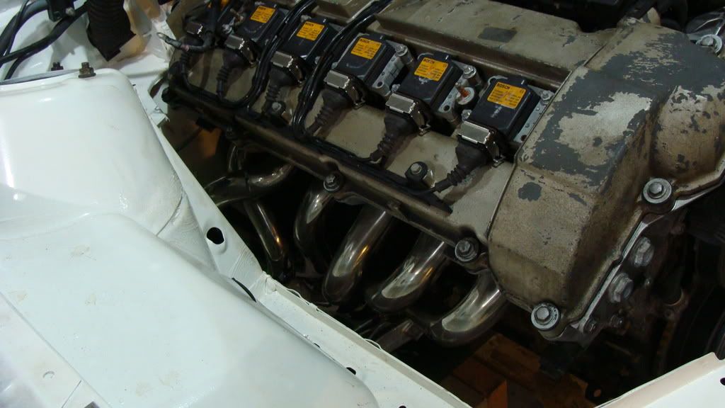

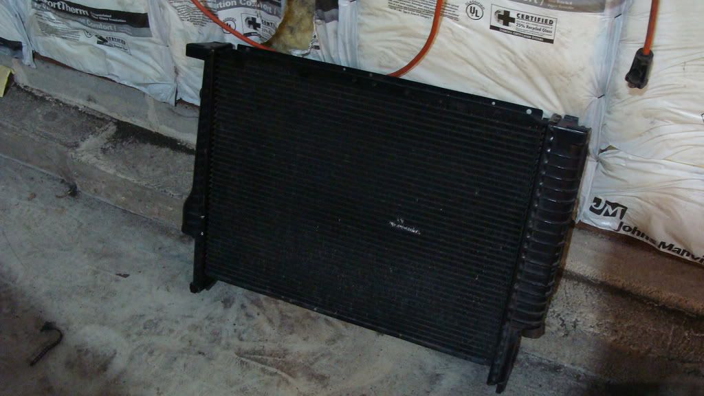

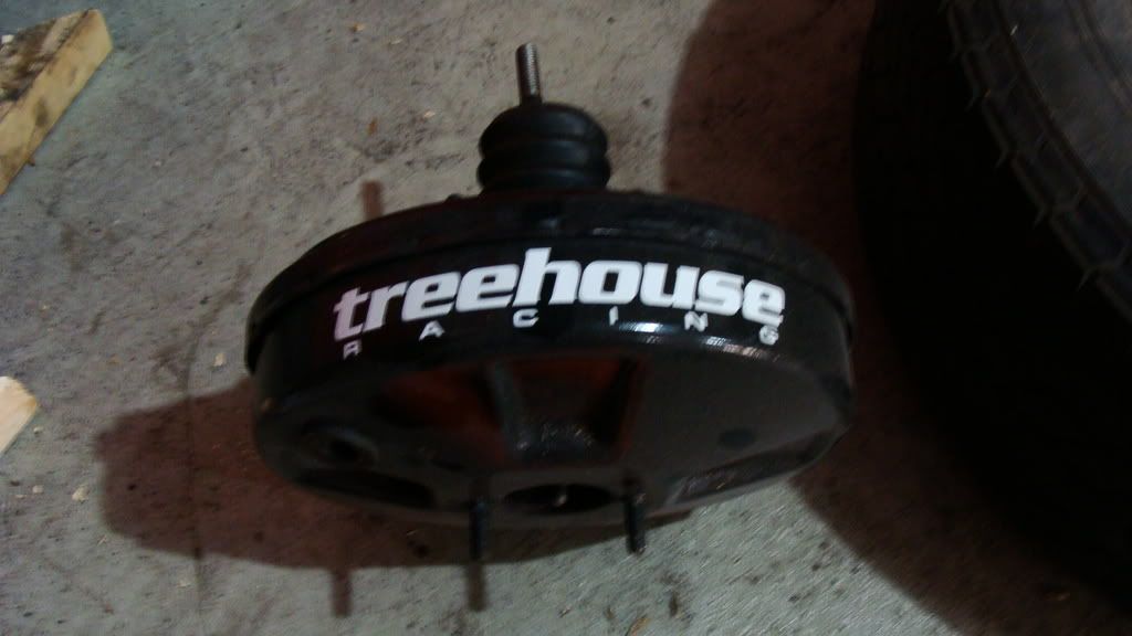

    So, I purchased mounts, booster, oil pan, electric fan, and a few other misc bits and pieces. Driveshaft! Sh1t. Well, I had a perfectly good E36 M3 driveshaft and diff. I know! My friend with a 98 328is would love him some limited-slip goodness. So, I did the install, and scavenged his old parts and bought a new CSB.

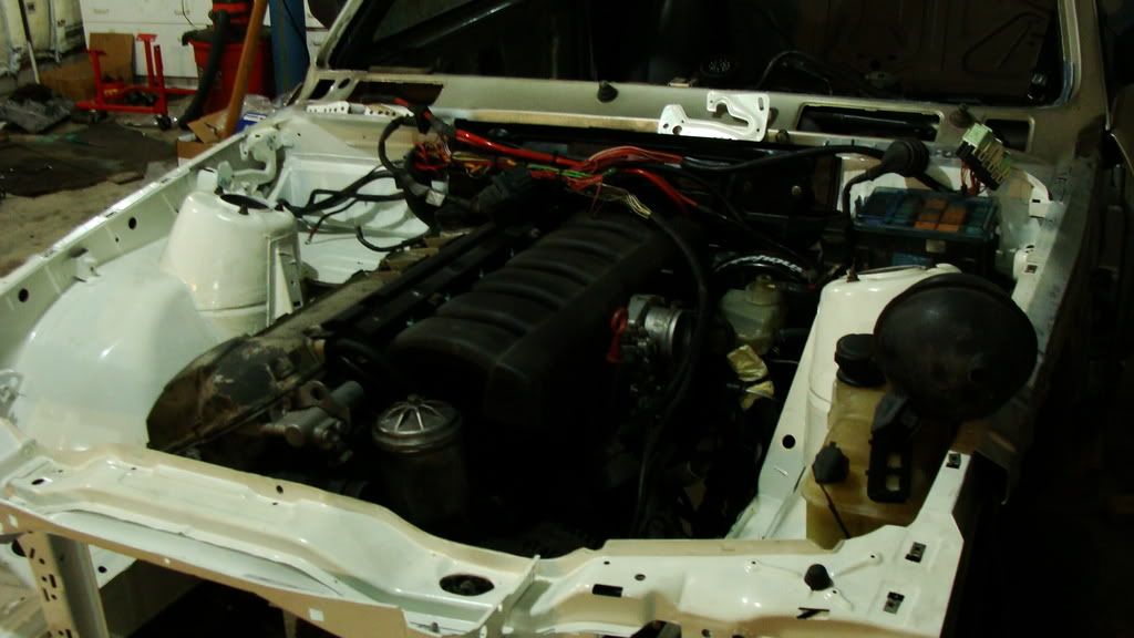

    The engine went in pretty painlessly. But, that’s all I did for quite some time. I was lucky enough to become one of the unemployed. So there that car sat with an S50 completely assembled and ready to go….mechanically. Wiring was left. I did research upon research to make sure I would only have to do this once.

    Picked up the E30 M3 wiring covers and proceeded to test my research. It proved fruitful, with only one minor glitch. At first it wouldn’t start. I checked and re-checked my wiring. Finally! R3V has come through. Apparently on 88 and older, you do not hook up #7 small green wire E36 side. Snipped it and fired right up. Idled great with NO Check Engine. I could not believe that. So, I pulled the plug on the MAF and the CE came on, so it does work. I just didn’t have any codes being thrown. H311 yeah.
