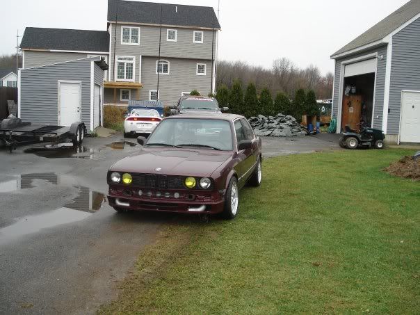

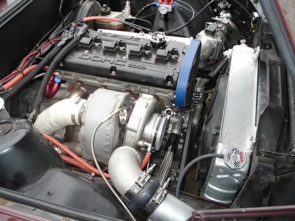

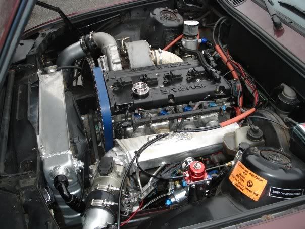

                            Havent been on here in a while heres some updated pics I will have Dyno numbers Saturday. So far I have driven it twice. Living in New England sux I dont want to take it out on our salted roads. But I couldnt fight temptation and drove it twice in 30 degree weather for a total of about 3 miles and both times got towed back to the shop due to CV- joint failure LOL. All I can say is she loves to spin the tires at 50+ MPH I can do rolling burn outs going way too fast to feel comfortable so I guess I was asking for it LOL. Video's to follow soon, the weather on Saturday supposed to be nice so I will shoot some video's if I make it off the dyno in one peice.
