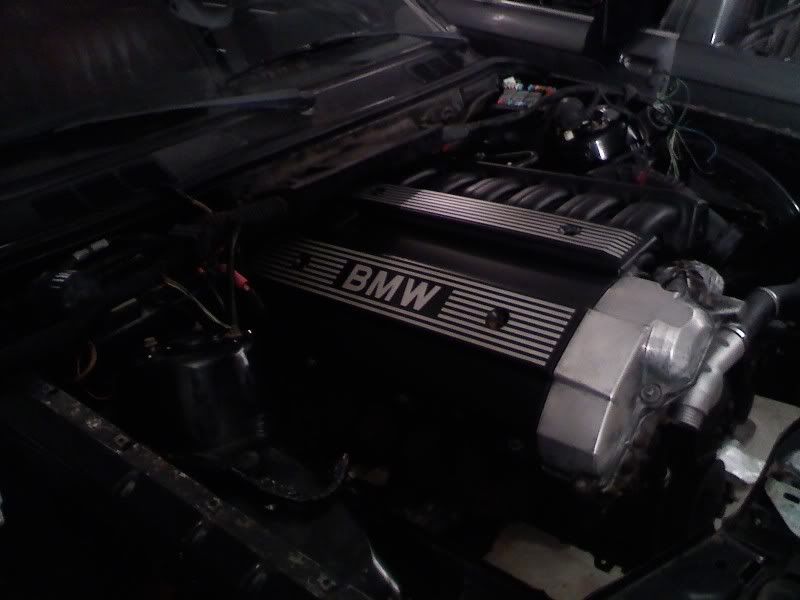

    i know many people do the m50....but mine is in and running and im pretty excited, my roomate who is on here, is a beast and helped with everything so far everything on it is new, thermostat, water pump, all new gaskets, radiator, ect it has a conforti chip...car used to be an m10...so its going to be a huuuuuuuuuuuge upgrade......im worried about brakes, i have the m20 front brakes...but in the back im stuck with drums, anyone have any ideas so i dont have to swap trailing arms ?
