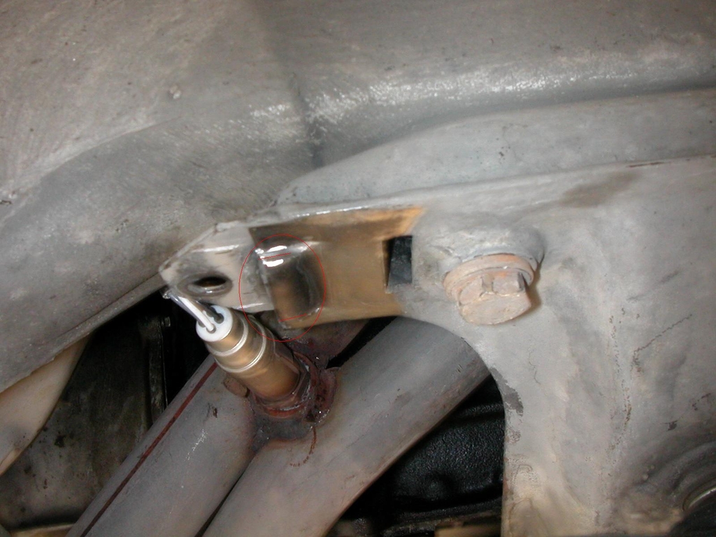

    Well i finally got my IE 25mm/22mm sways in. i also put in poly sub bushings and trailing arm bushings. haven't had a spare moment to adjust the links correctly since the car has to be on the ground, so ive had to take it a little easy since they could bend or break if not adjusted correctly. but the couple of times ive romped on have shown amazing results. the car just launches in the direction i point the wheel. i tried to do a little 1st gear drift last night and the car just rocketed barely leaving any rubber down.
    Here are some shitty pics
    You have to drill 4 holes in your trunk to reinforce the sway mounts. the sound board or what ever it is is a bitch, one side came off in big chunks whilst the other didn't.
    This pic shows where the front sway mount attaches to the front subframe . mine is a rare design were there's a little protrusion on the SF. i was told very little e30s have them and i could just get rid of it. so i made some relief cuts and hammered it down flat.

    The iX's have that protrusion too. The sway bushing has the relief in it. I assume it's meant to keep the bushing in place.
