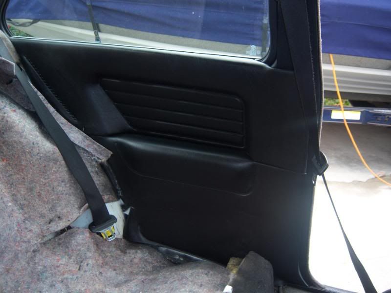

    New rear cards:

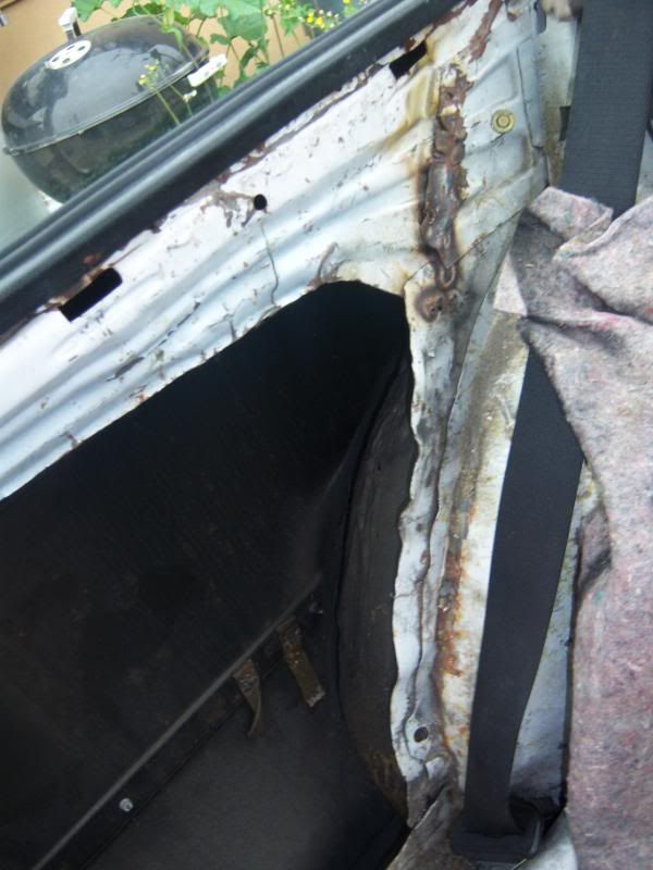

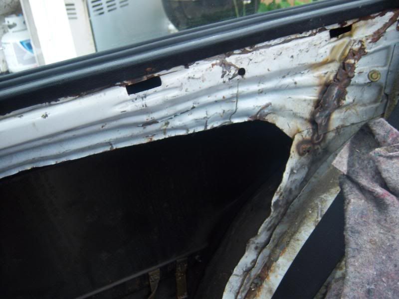

    Is this bad or serious?

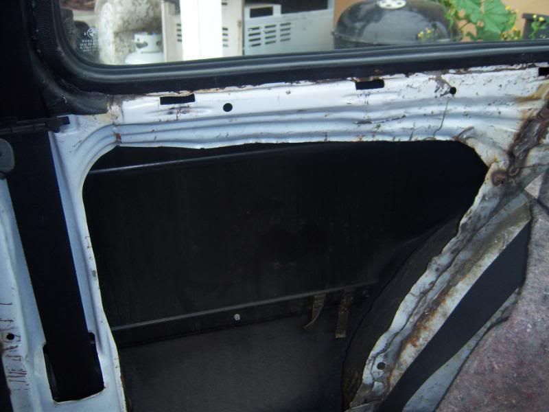

      It doesnt look too good
        Woah! That doesn't look too good man, looks like it was welded long long time ago and the rust spots are horrendous. Is it only on the door panel?
          It's only on the inside in that spot. Its weird. there is a little more up on the b pillar I think thats waht pillar it is not sure. But that inside stuff isnt that serious since it isnt affecting structural support?

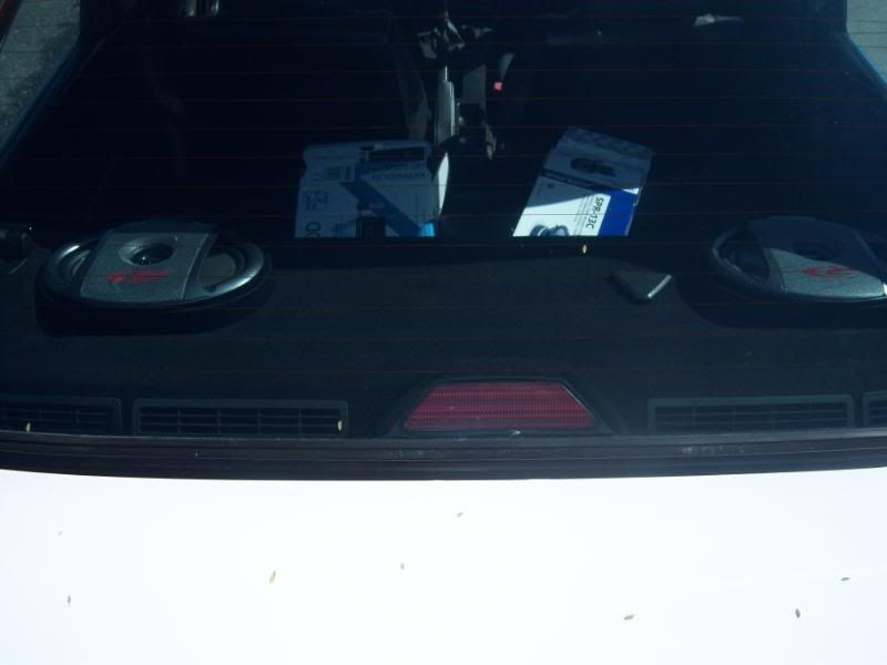

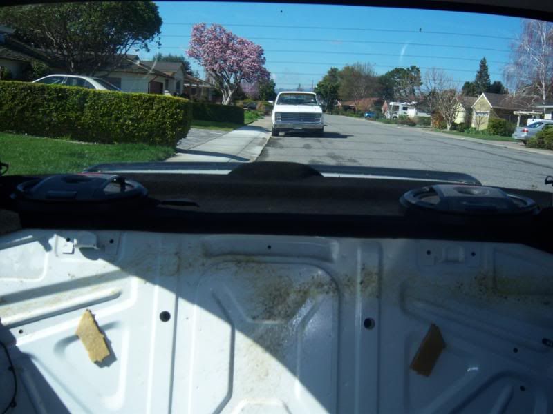

            got my black rear deck and speakers in today...now just need the head unit installed!

              Post pictures of your rear deck with the 6x9's mounted!
                Okay! Ill go snap some in a second!

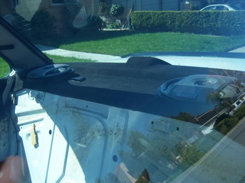

                  Black rear deck with 6x9's

                    Wow that came out really good! Where did you get the 6x9 spacers/mounts from? Imma have to copy your set up
                    RIP
                      Pick one of these places to buy from
                      Depending on the depth of your speakers, you may have to grind the sides of the spacers to move them as close to the side of the car as possible, so the magnet of the speaker doesnt hit.
                      I used a bench grinder and that worked nice. I also sprayed mine black, so they were matte and not shiny.

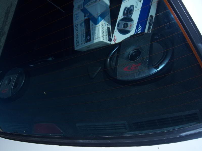

                        Stereo fully installed! Sounds amazing!

                                Originally posted by g.ruff561 View Post
                                Where did you get the black rear speaker shelf from????? I'm looking for a black one myself. You are doing a great job. Thanks for sharing pictures of your build...........................................G.
                                Thanks a ton man!
                                What I did was go to pick n pull (junkyard) and bought the cleanest tan shelf I could find. Then I bought 2 cans of black duplicolor vinyl and fabric paint.
                                I hit it with about to coats let it dry for like 20 or so mins combed it..then hit it more ..
                                Its just a process of spraying then combing, until there is no more tan. You have to get it from different angles sometimes too. I am unsure if they are sold black
                                very simple!
