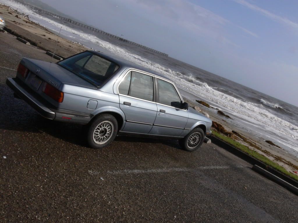

    Yep, it's still slow...
    But not quite as slow as it looks. ;)

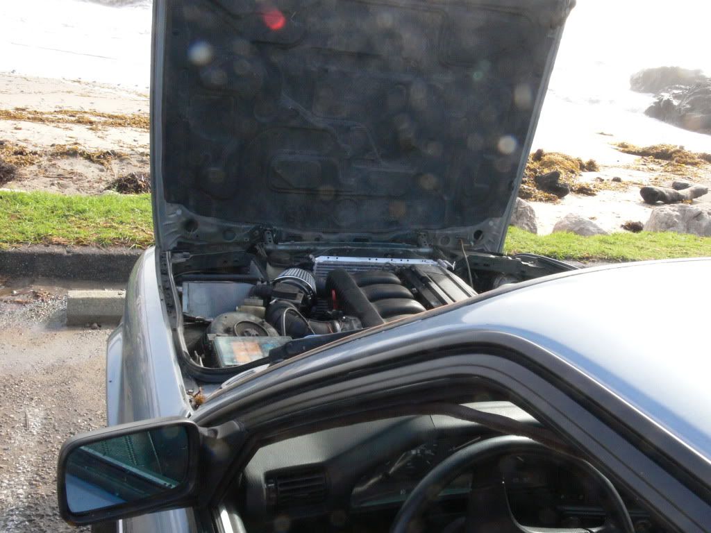

              Glad you finally got it on the road. I think you have your filter on the wrong side of the heat shield tho. :)
                Working on shaping the intake and a Mark D. Then unless I decide to do cams I'll probably be done with it until I scrounge up some cash for an S5x or an alloy M52/S52 cams.
                For anyone interested, here's the full laundry list of what's done.
                M50NV with lightened M20 flywheel and G260, rebuilt Z3 shifter with delrin bushings
                S3.73
                UUC swaybarbarians (22mm F/19mm R)
                Stock blown suspension otherwise
                New (Lemforder) LCAs, M3 CABs
                E36 steering rack and new E36 tie rods
                E32 brake booster and MC
                14" weaves with 195/60 RT615s
                It goes, turns and stops pretty well :)
