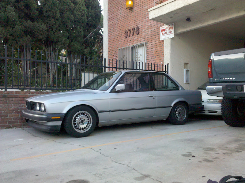

    I'm bored and I don't think I have ever started my own thread before so why not now?
    I finally got around to having my Ireland Engineering Camber Plates (for stock diameter springs) installed, I knew going into this they are about 10mm taller than the stock strut mount. I am broke so saving my tires (even just the front ones) is important to me and they are installed to correct my front camber. I however want to be lower.
    Current suspension setup:
    LowTec 60/50 springs
    Bilstein sports
    IE Front Camber Plates to bring front alignment back into spec.
    My question is: if I were to un-mount my strut, slide the spring out and removed one of the dead coils from my front springs, would this throw my fresh alignment off enough to matter? If I were to move the camber plates out just a pinch more to even the camber out, do you think my steering alignment might correct itself?
    Either will throw off your front toe significantly.

        I may have to just re-install the rear spring pads, get some spacers for the rear and call it a day.

          Are your shocks blown or something? I'm on lowtec 60/50s and bilstien sports as well and your car appears much lower than mine. esp in the rear, and we both have early models.. I have no spring pads.. wtf I want another 10cm knocked off my ass.

            How long have you been on them? Cant remember when i put mine on, at least 2 years ago, they have settled a bit.
            I think I have about 30lbs of shit + the full spare tire in my trunk in that pic.
                  +1 Looks good, just get rid of the reverse rake and call it done.

                      what year is that thing? what you running for spacers???
                        and having toe out of spec will kill off a set of tires far quicker than too much camber. You can run 2-2.5* of camber and still wear tires well if your toe is set well.

                              I had Lotech 60/60 springs on my ride for a while. I was bouncing off the bumps stops constantly so I wouldn't think about cutting the springs. I'm not sure about the IE camber plates but many of them reduce travel pretty good.
