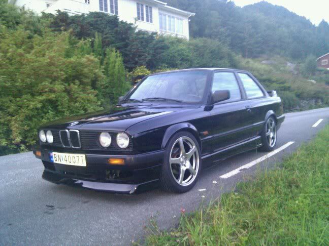

This is my starting point for this project :)
I then found a set of 9.5"/10.5"x16" Hartge 3pcs rims.
The M20B20 had to be replaced so i bought a Weber powered race spec M20B23 engine ;)
The power output is about 260+ hp, and the transmission is a close ratio, dogleg 5 speed.
A package from Turner Motorsport arrived today.
Alcantara M-Tech II steering wheel, Turner Motorsport pedal set and UCC short shift kit and DSSR linkage
The suspension is FK Highsport coilovers, powerflex bushings and K-Mac camber and caster plates on the front struts and reinforced rear strut bearing.
The interior is not my first priority at the moment, but I'm planing to do a custom E30 M3 interior.
