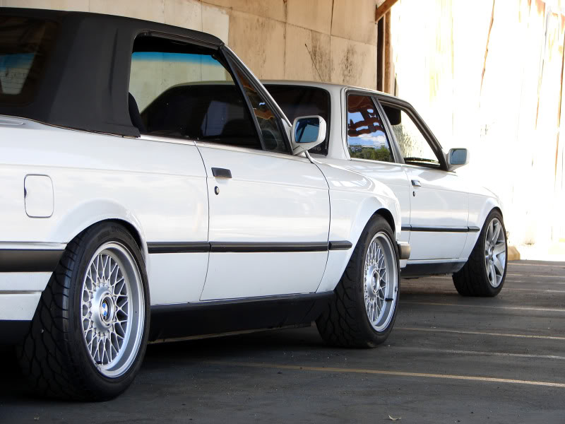

    drop specs and Im think those are e38 wheels ? (on the vert)

            e38 style 5s.
            • e30trooper
              • 11576
              ITS ..DK
              Hes from around this area
              I pretty sure thats hims.
              318i vert with hardtop. e36 5lug swap, style 5's rapped in KDW's . and some goodies under the hood :d

                  yup, that's mine, taken bimmerfest weekend.
                  haven't updated the thread here in a while... did a euro single-mass m42 flywheel and spec stage-2 clutch since then.
                  suspension is an e36 5-lug swap with z3 1.9 trailing arms in back, e36 non-M brakes in front. springs are H&R sport, for a z3 1.9. shocks are tokico blues, which elicited a negative response originally, but after a year and a half they're still good as far as i'm concerned. the only thing i'd do differently is look harder for 318ti trailing arms, as the outermost edge of the sidewall rubs the inside of the fender on hard bumps on the freeway. (you can see where it's shiny in the pic OP used.)
                  tires are 225/45-16. i think they suit the e38 weaves well, and they have shitloads of lateral grip, especially for the price i got them at, but i am planning on azenis' next, since the e36/z3 brakes with good pads (porterfield r4s) are well-capable of locking them up if i brake too enthusiastically.

                    very nice, classy vert dk. gives me much motivation for my soon to be daily driver. I recently sold our 97 740 and I always wanted to get a new set of wheels for it cause the weaves just didnt do it justice....but it was my wifes car and she didnt need anything fancy anyway. But on an E30 they look wicked, esp with 245's and that stance. Nice car man. awesome alpine.
