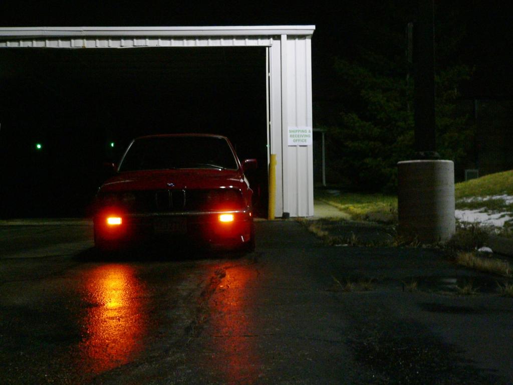

    Hi guys.
    I've been lurking for a while now. I first saw an E30 when I was looking for a car over a year ago. I loved the lines of the car and it would be affordable for a high school student like me. :)
    Fast forward to 2 months ago. I'm working 4 days a week part-time, but I still didn't have much money to purchase a car. My parents agreed that since we will need another car for this upcoming summer, I could find the E30 I've wanted. I had a thread in the classifieds that ended up leading me to the car I now have. For how much we paid it is unbelievably clean and well maintained. I love driving it.
    1987 Zinnoberrot 325is
    138,xxx
    Full black sport interior
    Automatic:(
    Basketweaves
    The plan for the car right now is to learn basic maintenance and some more advanced things through it. The only thing I have done until now is oil changes on our Miata. I already have things to start on. The E-brake isn't connected. The speakers don't all play until you pass a certain volume and even then one side will play and the other won't.
    I also have a question for the other auto drivers. With your pedal floored, does the car still shift and under 3k? I really do not want to use the 1-2-3 shifters to get it going.
    That's all I've got. This site is a fantastic resource and I like the people here, regardless of how you treat each other. Hopefully I don't get too much flak for being 17.
    Thanks
    *Last thing. How can I post attached photos up using the [img] tags? Sorry for the dark shots, I'll get more some time soon.

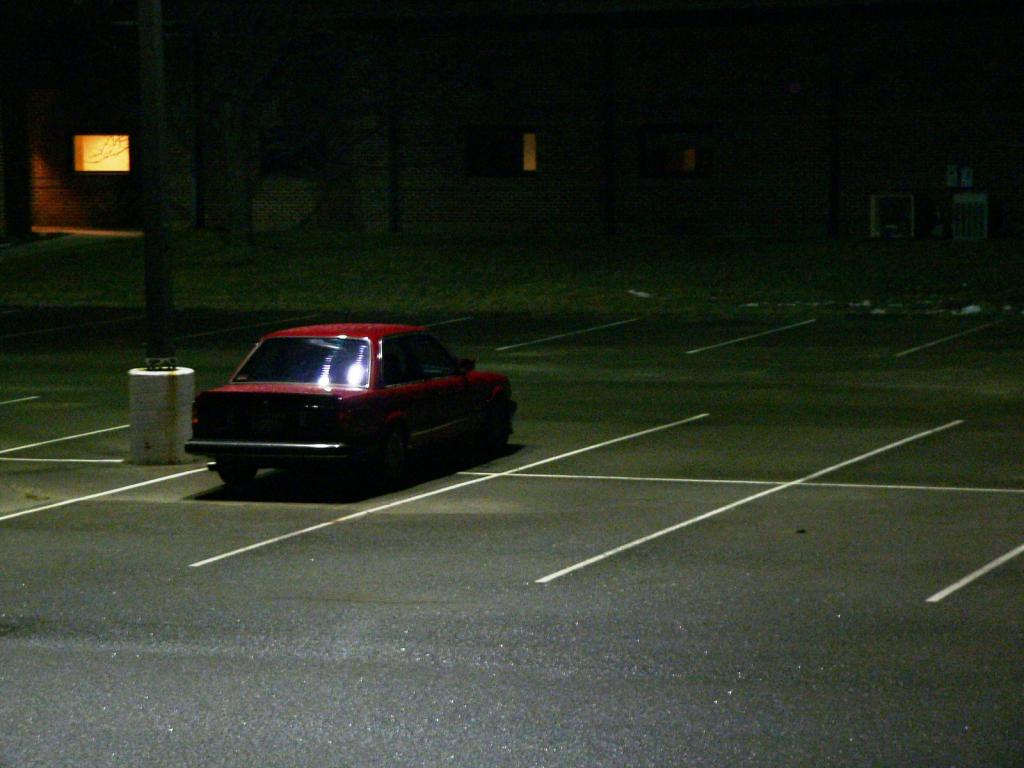

                  Get some better pics in the daytime! And congrats, Im 18 and there's 3 e30's at my house right now ;)

                    CAnt see anything with the pics... All you see is darkness and lights............................................ .....
