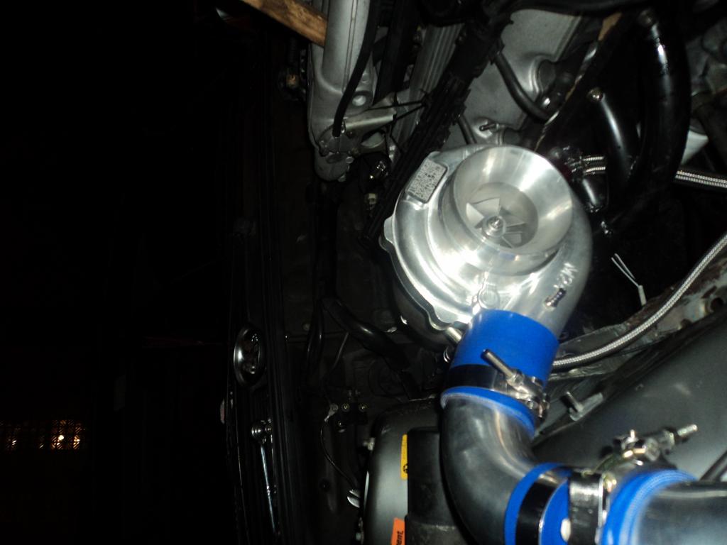

    Finally some boost

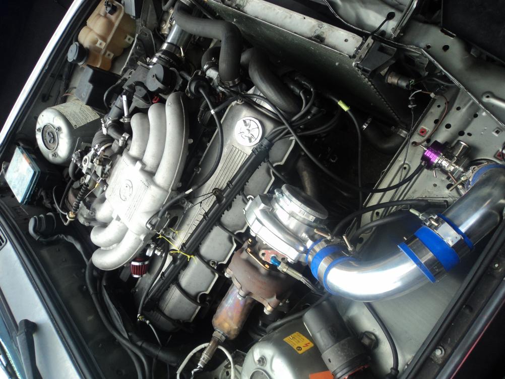

    i took my a while... almost a year and a half to complete this project due to my shitti as salary, living with my wife and being 21lol....
    Engine mods:
    T3/T4 60-1 ebay turbo
    cxracing 2'5 i.c pipes with bov
    38 turbonetics deltagate wastegate
    ebay intercooler
    custom manifold (bought it from a firend)
    walbro 255
    complete rebuilt heads, all seals etc etc...
    Rear main seal
    Vac A'rps
    Mls cometic headgasket
    Vac aluminium flywheel and broze clutch...
    24lbs injectors on tuned motronic..
    M20 maf its maxed out.. depends on gear it cuts at around 3500- 4000 rpms, boosting 7-8psi. I got a m30 maf on the way to tune it again and see what happens... it should be good for 10-12psi. im planning on run it like that 6-7 months till get enough funds to install my megasquirt and 42lbr injectors and be on 15-17psi, but first im gonna do suspension(not sure what combo yet) and every single bushing.

    Can you post more pic's of you header...?
    What wall thickness is it? that flange looks alittle scary..

      dont have many detailed pics.. first turbo build here man

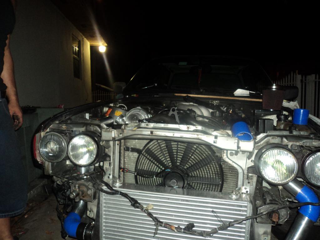

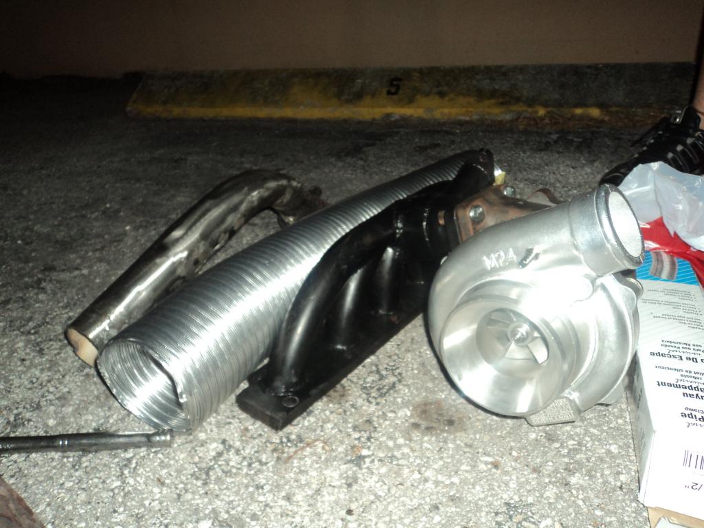

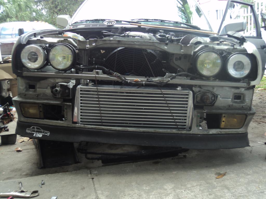

              more pics.... after intercooled we finished with intercooler i brought the car to my apartment and start mounting manifold,turbo,wastegaste, oil lines etc.. it was a long night but it was ready to go the next morning for tuning :).... didnt hook the pipe that connects the i.c with the afm till i got to ft.laudrdale to tune it.. (like 30 min drive)

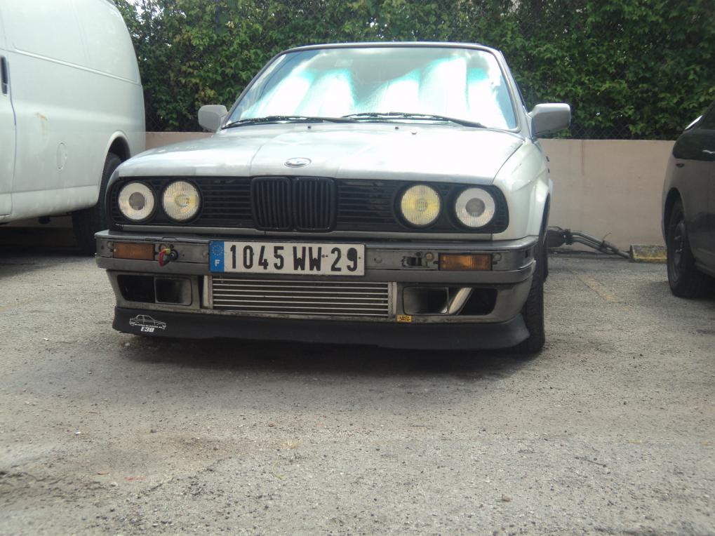

                        fresh pics..
                        Nice weather today in miami so take two pics lol
