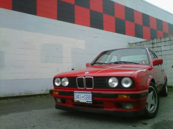

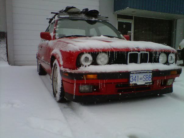

    Anyways, thought I'd introduce myself here as well as my 2nd e30 I've owned
    To start, its an 89' zinno 325i that I bought from a buddy about 8 months ago.
    So far as mods and maintenance go, here is the list:
    5 spd swap from my m20 2.8 stroker that got crushed
    4.10 LSD
    H&R Race springs, e90 drop hats, bilstein sports
    325ix rear sway bar
    euro plate filler
    modded stock airbox for more induction noise
    brand new oem catback
    suede shit boot and ebrake, with e39 leather handle.
    momo steering wheel (not sure of what design)
    Racing Dynamic 15x7 et26 rims, with Falken Azenis 1st gen 205/50/15
    modded fogs to run without low beams
    Super Blue ate brake fluid
    and all the maintenance to go with it...soon to do timing belt and water pump.
    and here for a couple pictures. Ill upload more tonight when i get home..

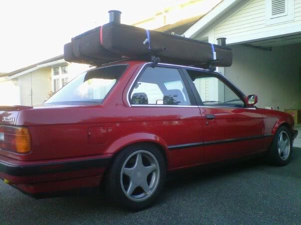

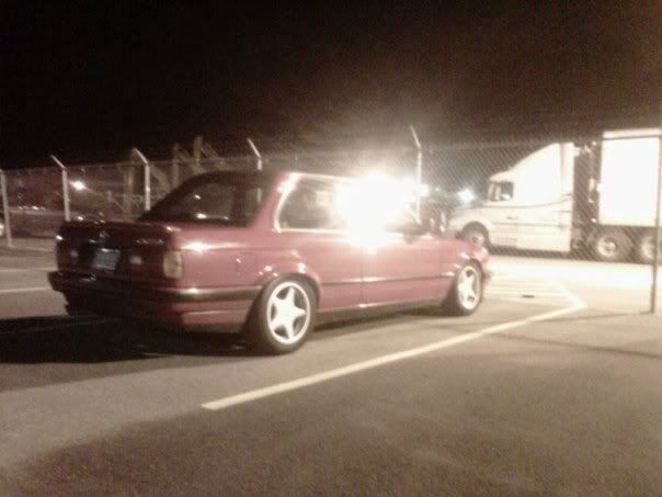

    This last picture is with e30 m3 springs...before i got the H&R race in..
    After I get back from mexico, Im picking up a tan leather sport interior to
    put in it and that will be sometime in april...Ill post pics when its in!
    Thanks for viewing my car, hope to meet some interesting people on here
    and get lots of info.

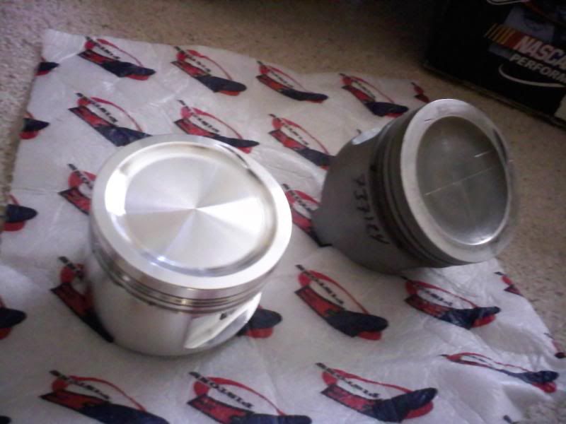

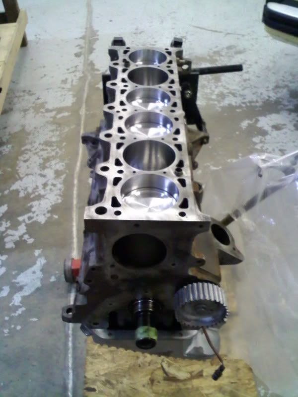

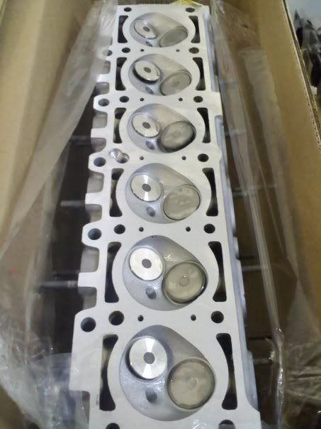

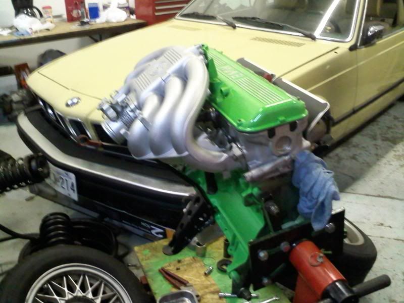

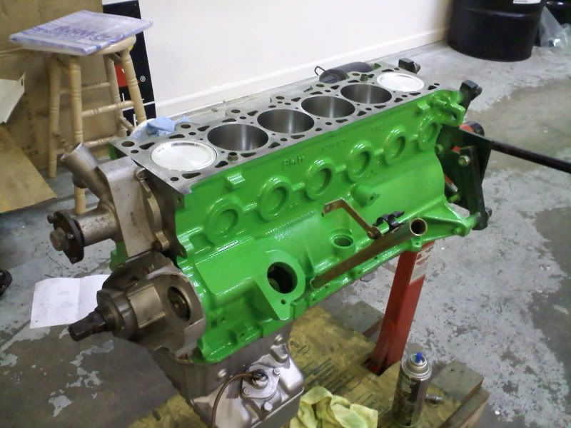

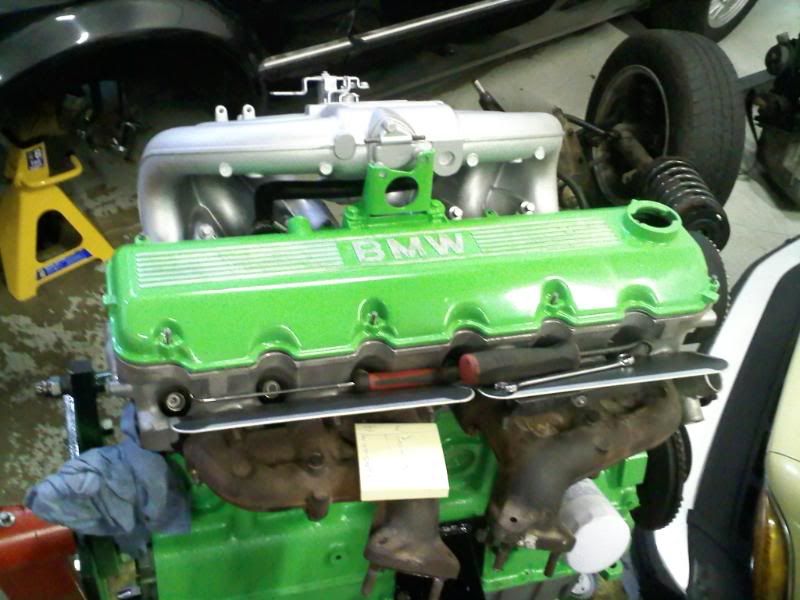

    teaser pics of my stroker engine i had built for my DS e30...unfortunatley I sold
    this engine to buy this car.
    Specs were...
    bored and stroked to 2.8L with eta crank and 85mm forged 9.5:1 CR JE pistons
    e21 323i euro spec head with 272 colt cam and enlarged valves
    e36 m3 injectors
    Miller MAF conversion
    Miller WAR chip
    adjustable FPR
    and all the "i" goodies with 1.3 motronic
    dynoe'd at 193whp and 180ft lbs.

    Good looking car. Looks just like mine except clean. Lol
    CCW- when every second counts... The police are just minutes away!
      Looks like a nice find, Zinno is easily my fav red.
      The RD wheels are one of my favs too, so in my book, that car is rockin!

          The 2.8 looks great, keep us posted

            Jealous of that rack. And also is that a 6er in one of those shots??!
              That's really low for just being m3 springs. I'd almost say those aren't m3 springs.
              Originally posted by Matt-B
                yeah thats my buddys 633csi he restored from just a body and frame.
                  no those are h&r race. the last picture with the roof rack and couch is e30 m3 springs
                    thanks, it was a really fun motor to run.
                    unfortunatly i no longer own it.
                    A friend of mine put it in his 89 325i thats running GC and a full roll cage and sticky tires. suits the car perfectly!
