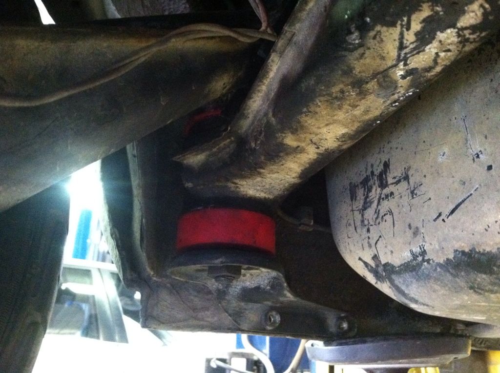

    Well I am without car tonight and for a few weeks! Let me explain. I took the car to the Ft. Jackson DIY Auto Hobby Shop today. I started at 10am, dropped the entire rearend and proceeded to R&R the subframe bushings and TA bushings. I also planned on servicing the diff with new seals and a new mounting bushing. But my time ran out! I found myself at 4:30pm close to being done, within 1:30. The hobby shop closes at 5pm on Sunday and they are closed tomorrow for the holiday. I am working Tuesday and Weds during their hours of operation and I leave Thursday morning for a 2 week trip to see my wife's family in Italy. So it looks like it will be the beginning of Dec before I get my baby back on the road!
    What I got done today:
    R&R subframe bushings
    R&R TA bushings
    reinstalled subframe and TAs
    intalled GE 650# springs and adjusters
    To Be Done:
    Bleed Brakes
    Replace rear brake pads
    Service Diff and install
    replace swaybar links
    Uhhh worked my ass off today and I have an empty parking spot to show for it! And some cold ass motorcycle rides in my near future.

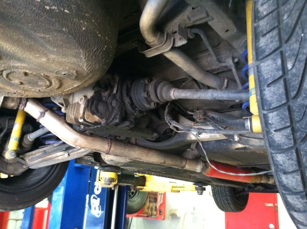

        OK I know that he exhaust is ugly but it is temporary so no hate! This is the before pic with all the ugliness!

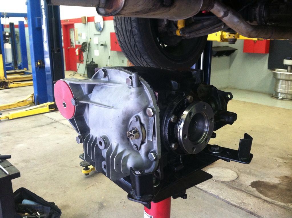

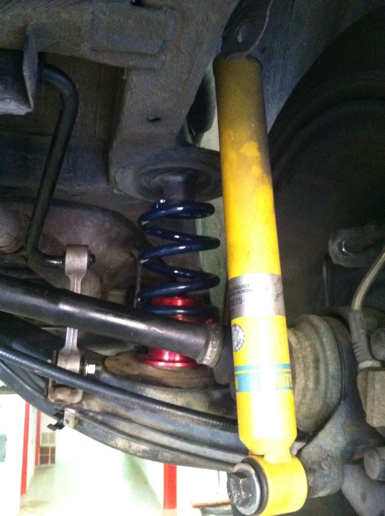

        And here is the Diff after I cleaned it up and replaced the output seals, cover gasket, and AKG diff mount. Matching subframe bushings and TA bushings are also installed. Also a nice set of GE 650# springs and adjusters.
        I also got the rear swaybar bushings and links installed today. I will be going back tomorrow or Tuesday to put the car back on the lift and replace the rear parking brake shoes and hardware. I will get some better pics then.
