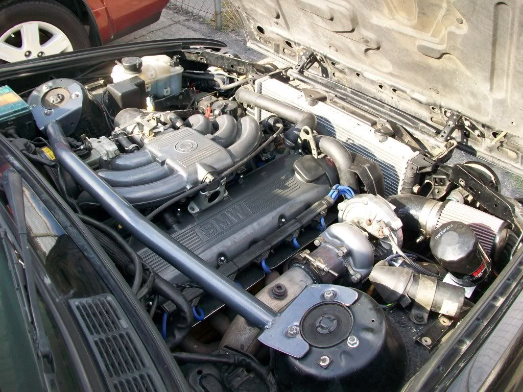

    As many of you know I bought myself a glossy black E30 back around the first of the year. Funny thing about this car is I owned it from 9/04 through 9/06. During that time I did anything and everything to it, including a turbo 2.7 stroker. Ever since I sold the car I had regretted my decision. A friend of mine spotted it for sale in December of last year and let me know. After selling one ball, one kidney, and whoring myself out as much as possible I made a deal with the seller and bought the car back!
    The fairy tale didn't go as smoothly as it should have. The seller (a shop owner and mechanic) told me that the car would need a headgasket. This is something I was OK with and I went ahead and had it shipped home from PA. Long story short, it had a cracked cylinder head and had been mixing coolant in the engine oil for quite some time. The Schrick cam was destroyed, the crankshaft was destroyed, the bearings were destroyed. Mind you this was a 10,000 mile motor.
    At that point I decided to bite the bullet. Fuck it, let's build it again and do it right. I sourced a new (used) cylinder head with a good cam and sent the cam to be ground to turbo spec. I sourced a very clean replacement Eta crankshaft from a buddy who had an Eta parts engine. Of course I bought all new rings, bearings, gaskets, etc. The engine got a full rebuild including having the block honed and decked and the cylinder head rebuilt. I went with a +size OEM BMW head gasket and all ARP hardware. I will include a full mod list below.

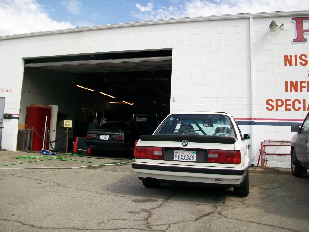

    The next step was engine management. My days of swearing that my band-aid Motronic setup was fine were over. I talked to Derek at Dederic Motorsport (DMS) and got the ball rolling. Derek built me a plug and play Megasquirt box and a plug and play Innovate LC-1 wideband o2 sensor. For anyone wondering, this guy knows what the fuck he is doing and I would recommend him and his work to ANYONE. Today (Friday) I met Derek at a local dyno shop and he went to work. Thanks to Derek I have a GREAT running and reliable turbo M20. He claims it should get decent MPGs too, but I'd have to drive normally for that I think, lol!

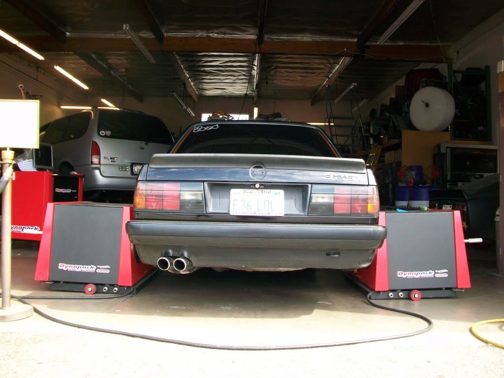

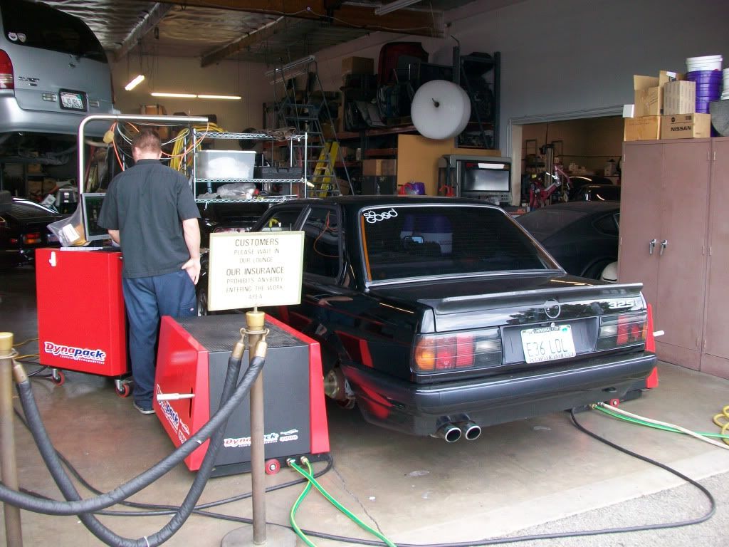

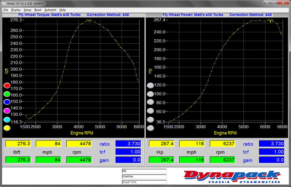

    Below are some pics from the dyno session along with a dyno sheet, a fun dyno video and complete mod list for the car. None of this could have been possible without the help and hard work of my very good friend Shant. He goes by Myster-e on this forum. A huge thanks to him and again to Derek! Now phase two of buying this car back will be getting it cleaned up! Enjoy...

    Engine:
    Rebuilt as os 4/11
    New bearings/rings
    Super Eta pistons
    Super Eta rods
    Eta crankshaft
    Balanced bottom end
    Port/polished 885 head
    Reground turbo cam
    IE HD rocker arms
    IE crank scraper
    ARP main bolts
    ARP rod bolts
    ARP head studs
    OEM thick headgasket
    Powercoated intake manifold
    Powdercoated valve cover
    Perma-Cool 18x6 oil cooler
    Summit oil filter relocation
    Steel braided AN oil lines
    Spal 16" electric fan
    A/C & P/S deleted
    Turbo Setup:
    Equal length stainless manifold
    T3/T4 turbo Exh trim .57ar/Comp trim .50
    Tial 35mm wastegate
    Greddy Type-S blow off valve
    Ford Motorsport 39lb injectors
    K&N RU-5111 Air filter
    Dederic Motorsport PnP EMS
    E36 M50 throttle sensor
    Turbo-back 3" exhaust
    Magnaflow rear muffler
    Dyno tuned by Dederic Motorsport
    Suspension:
    IE Stage III springs
    Bilstein Sport shocks/struts
    Sparco front strut brace
    UDM Motorsport rear brace
    Autopower "street" roll bar
    16x7.5 Hartge Type A wheels
    225/45/16 Falken 452 tires
    Exterior:
    iS front lip spoiler
    RyanG splitter
    European headlight grilles
    European bumper moldings
    European rear plate filler
    Shadowline window trim
    15% window tint
    M-Technic I trunk spoiler
    Hella smiley Euro Ellipsoids
    DDM Raptor 55w 5000k HID
    MHW smoked turn signals
    MHW smoked tail lights
    Body color side mirrors
    Interior:
    Euro grey cloth sport interior
    Black door handles and map pockets
    Nardi steering wheel
    ZHP shift knob
    Euro 316i HVAC panel
    M3 Maplight rear view mirror
    Ashtray delete storage tray
    E36 window switch swap
    Cocomats floormats
    Nakamichi CD400 head unit
    Polk 6x9 rear speakers

                very nice man! but I hate ASE corrected numbers

                  Thanks T! It's tip-top mechanically, now I'll do my best to clean her up cosmetically. It doesn't look quite as good as when I left it in 2006 but I'll work with it the best I can. Down the road paint will happen.
                  Originally posted by N2MYE30
                  Nice car but your engine work is pure win here. Bravo sir, bravo!
                  The engine build itself from bottom end to cylinder head is all credited to my buddy Shant. (Myster-e)

                          Quick question, do these dyno's read on the lower side or on the higher side? I could never figure out which of the styles read more optimistically..
