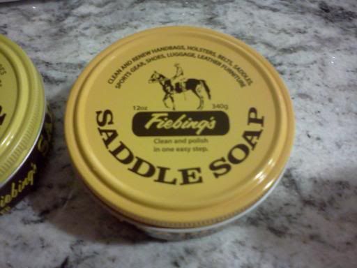

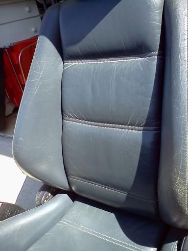

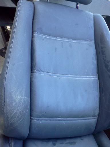

    A buddy of mine suggested i should buy some "saddle" soap and condition my seats. I would have to say for the most part I'm pleased with what it did. My seats could really benefit from a high quality recondition tho.
    Anyways on with the pics. Enjoy!
    The product

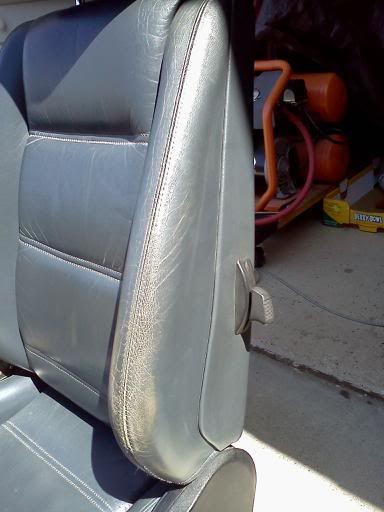

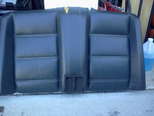

    Used a Mr Clean Magic Eraser to clean the back seat first. Nasty!!
    The back seat after 4 coats

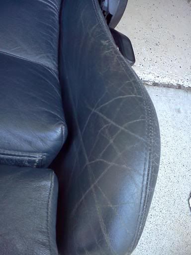

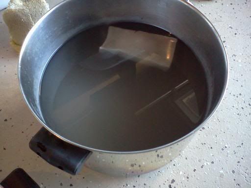

    Cleaning the passenger seat, Did the same thing to the drivers side.
    2 coats of the soap.
    Drivers seat

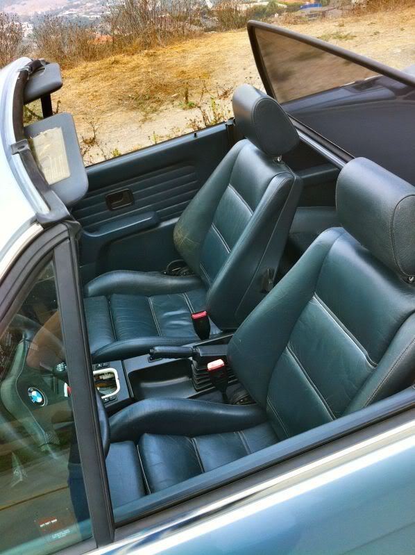

    After all that work I decided to drive down to La Jolla. I phone 4 goofy HDR photos. I will be getting some quality photos in the future.

    You need a shift booty ha let's find some cool ones. I used the saddle soap on my g37 and everyone wondered how I kept my seats so soft. When you say coats were you using the saddle soap on a towel with water, wipe and rinse with another towel and then dry?

      ^Yep
      Ill do another recondition with the soap in a few more weeks to see if it improves even more.

          Clean car! And glad that stuff is working for ya, looks nice after the refurb.

            Yeah and its only 7 bucks a can and I'm very surprised by what it did to my seats.

              chilling up on mt. soledad?
              i miss la jolla. just moved from the corner of pearl and draper st

                Those Mr. Clean magic erasers work great! I used like 5 boxes of those things on my interior and made it look like new! But great job, looks good

                  Small suggestion. Go to the fabric store and ask for a small piece of black or navy vinyl. Take that piece and stuff it inside the cracks of the seat where the seams have separated. It makes a big difference from 5'+ away. Looking good though.

                    Looks like the saddle soap did a lot to clean the seats up!
                    how long did it take u to clean them up?

                      Those seats look awesome. Remember to use some kind of conditioner on the seats after you're done cleaning them. The saddle soap is an awesome cleaner, but you still need to protect the leather.

                        Solid spot to shoot, nice choice. :D
                        I feel like I've seen you driving around SD, car looks pretty nice... too bad weather down here sucks right now and the marine layer won't go away.

                            Yep, Its a road going down the west side of Mt soledad. Good little spot to shoot and theres no one there.

                            It worked great. Now they're lemony fresh(the soap smelled of lemons).
                            It took me about 4 hours.
                            Thanks! They do need a good condition for sure. It was more of an experiment. I'm planning on getting some Groits products and going at my seats again.

                            Dude, i need you to take some quality pics of my car.
                            haha! yeah its a good spot!
                            I'm mostly in east county because I work in El cajon, but i drive up to Vista and down to Point Loma to hang with some E30 buddies all the time.
