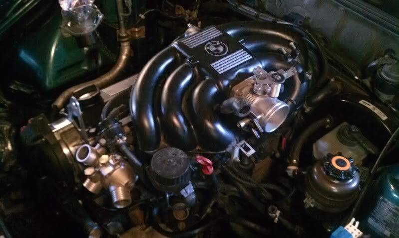

    This whole process has made me realize I'm terrible at build threads. I was working my ass off on this car. At times, I had the camera a few feet away cause I told myself I would document for the R3v crowd to enjoy. I just got to the work and forgot to take shots. Here is the semi finished product and a list of what went into it
    Engine:
    every seal
    every O-ring
    every hose and clamp (vacuum/coolant)
    every nut and washer(minus internals of the block)
    new water pump
    TB and tensioner
    thermostat
    New thermostat housing(both halves)
    new sensors(EVERYWHERE)
    Head refreshed (thanks to 328isjunkie)
    282 cam
    new Radiator and mount bushings
    new fan shroud
    Bavauto wires
    new cap & rotor
    filters and fluids
    crank scraper
    NPG waterless coolant $25 bucks a gallon
    new expansion tank and all that goes in it
    new washer tank and all that goes in it
    new relays
    new fuses
    new motor mounts
    new belts
    New Battery

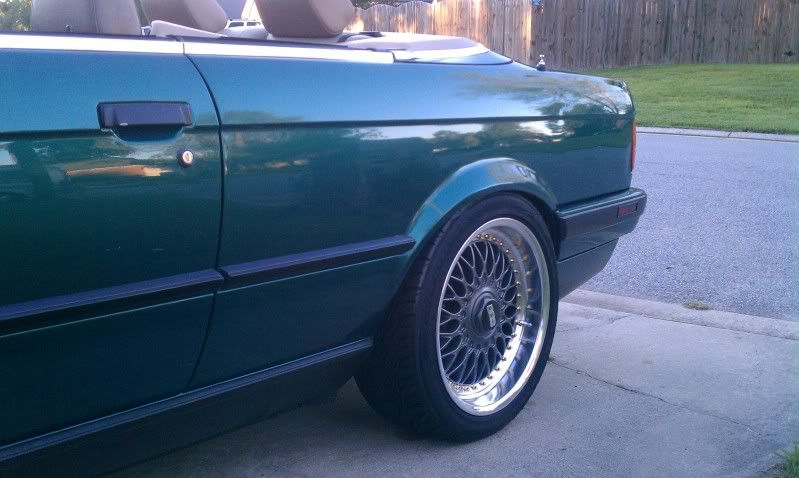

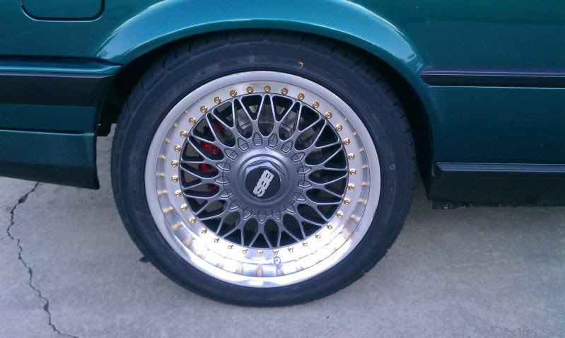

    Wheels/Tire:
    BBS rc090 "Style 5"
    new tires federal 595 215/45/17, tires are temporary
    filled and redrilled
    powder coated
    polished
    gold bolts
    BBS caps
    spacer
    spline drive stud kit(thanks to Kaliboy)

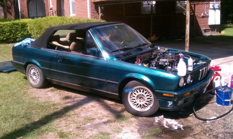

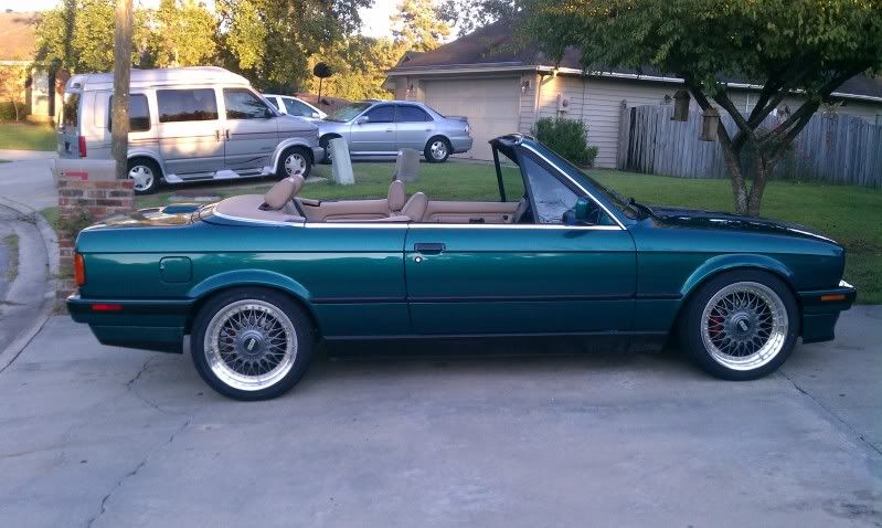

    Here are the pics I did take, some are from previous posts
    She started like this
    Today

                what size tires are you running on the new wheels? they look a little chunkier than the alpinas...
                    Thanks bro...I'm running 215/45/17, I have to roll the fenders a little
