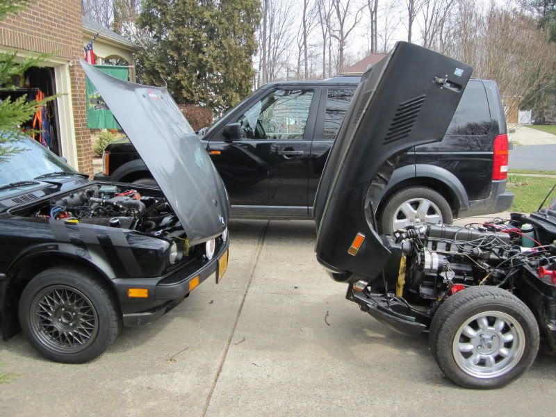

Axis vs. Allies
    Axis vs. Allies
    Britain vs. Germany vs. Japan. I couldn't find anything American to use....
    Fair fight

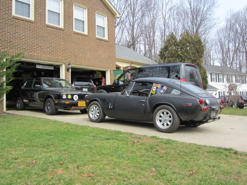

    Brits ganging up

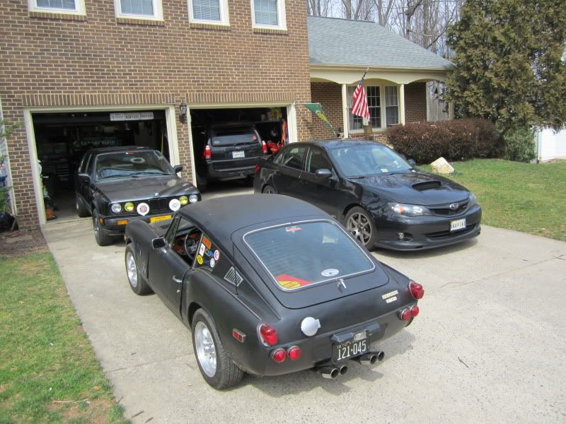

    The Japanese join in

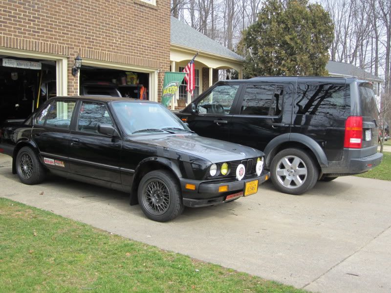

    The Allies are heavily outnumbered

    I want your cars.
      to be fair, the Rover is one of my wife's friends. I'm not that baller, I only buy cars that are either under $2k (projects) or under $30k (new) :)
