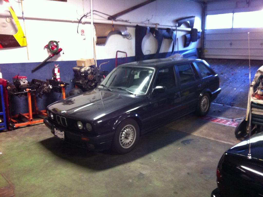

                              Betty is here at Guten, just arrived. 3000 mile delivery, will start on her tomorrow. Let the "while we are in there, while it is here" begin.
