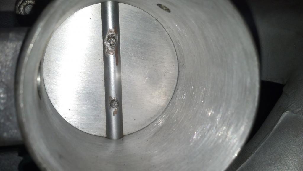

          Coming up on my first oil change on the rebuilt engine. I've got a bunch of new parts in, m3 cab's, electric fan(deleting clutch fan), I.E. steering rag joint, ss clutch line, and a couple other random things. This stuff will be going in sometime soon when I find the time. I did remove my right rear door panel and lube my window track screw. Man what a difference in how easy my window goes up. No more straining and groaning power window motor, just goes right up nice and quick. I used spray white lithium grease and just sprayed it directly into the screw tube/regulator, those of you with scissor tracks probably don't have this issue.
          Here is a pic of the throttle body I got from bobross here on r3v. It's bored and has had the throttle plate swapped with a proper sized replacement. The screws go in from the other side and have been staked to prevent them from coming out.

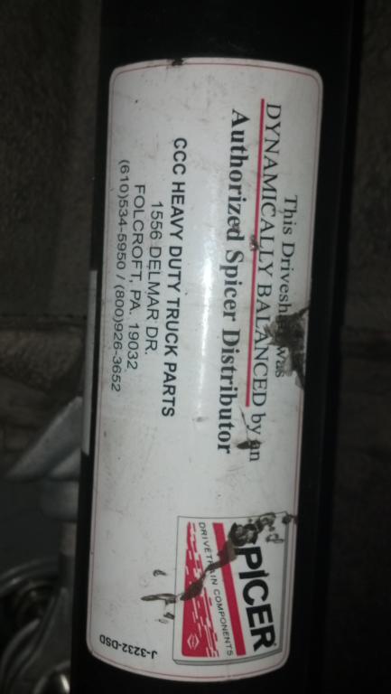

              thanks, it's nice to see a comment now and then:-) Hers a pic of my driveshaft, that's the people who rebuilt it.

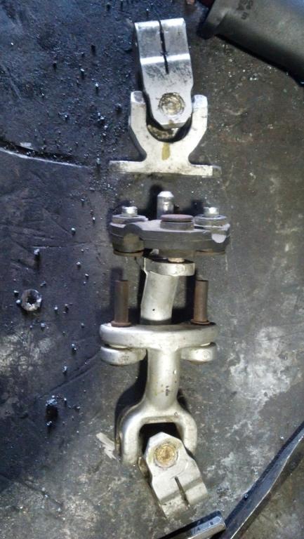

                posting multiple pics is not easy, I've got pics uploaded to the image gallery but can't seem to get them into the thread. So screw it I'll keep on going the way I have been. Pic of steering column during disassembly.

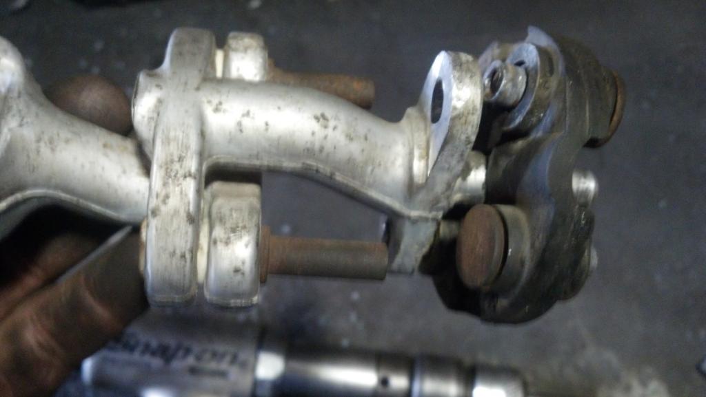

                  So I'll be replacing the rag joint in the steering column. It's being replaced with an I.E. poly unit. The last pic shows the column partially cut apart, I used a die grinder to cut the heads off the rivets holding the rubber to the aluminum halves. And then an impact hammer to drive the rivets out. This pic shows the rubber and rivets almost all the way out.

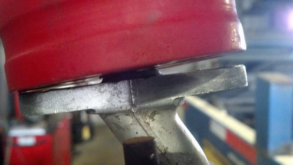

                    #54

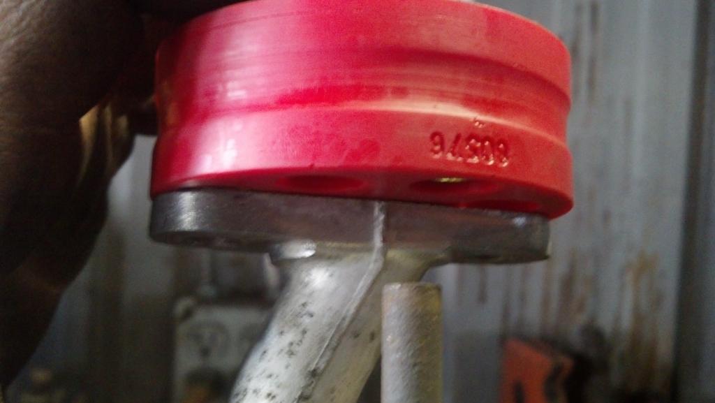

                    The next step was to fit the new poly joint to the steering column, It took a little trimming to get it to lay flat on one of the halves. When you separate the halves of the column there is actually a slip joint under the rubber. This allows for a little extension and compression of the column. On the one end the aluminum casting was a little larger than the hole in the poly spacer and it would not sit 100% flat so it trimmed the spacer a bit with a razor blade, the next two pics show this.
                    • bmwstudent
                      • Sep 2011
                      • 1364
                      #55
                      And now after trimming, it really didn't require much. Just a couple nicks with a razor blade, honestly it would have stretched to fit but I figured why not trim it up a little.

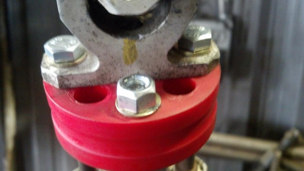

                        #56

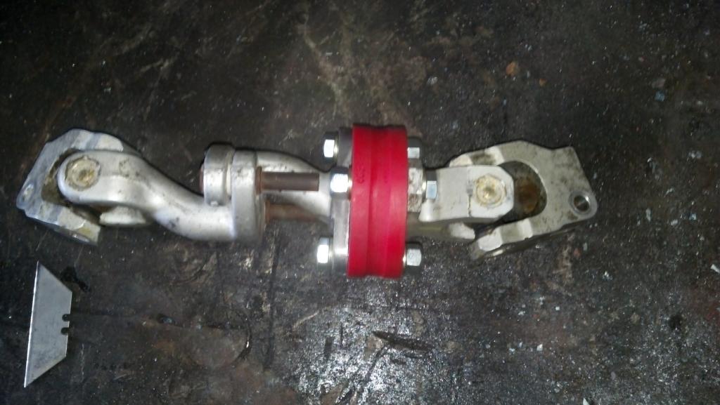

                        So this is what it looks like after assembly.

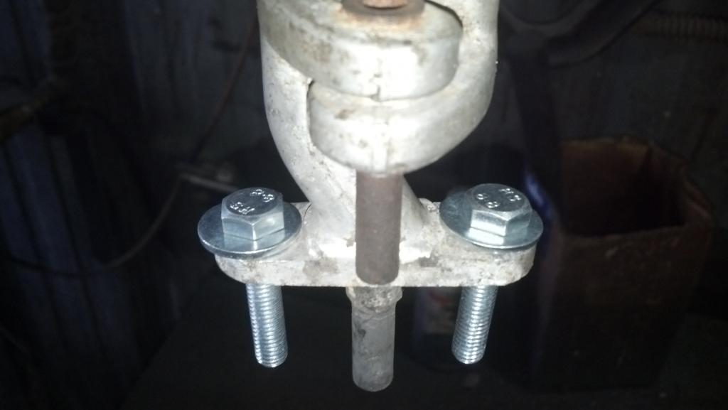

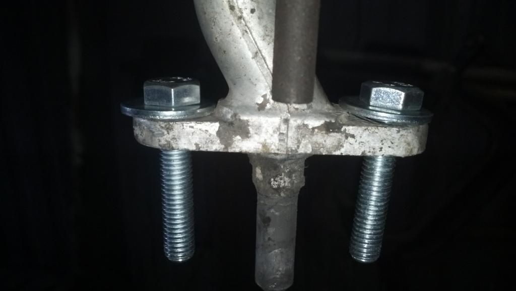

                          Here is a shot of the bolts and washers supplied with the kit. I didn't use the washers they sent because they were just a little too large. The outer perimeter of the washer sits up on part of the casting for the mount, you can slide it over a little bit to make fit but then it is offset and looks sloppy. I have a large selection of metric nuts, bolts, and washers, so I found some that fit a little better.
                          • bmwstudent
                            • Sep 2011
                            • 1364
                            #58
                            Here is a pic that shows it a little better.
                            • bmwstudent
                              • Sep 2011
                              • 1364
                              #59
                              Here is the washers I used, the spacer has steel tubes in the bolt holes(positive stop spacers) to prevent you from collapsing it when you tighten the bolts. The washers I used are still large enough to hit them.

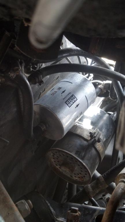

                                #60
                                While I had it out I installed the new fuel filter. Genuine Mann made in China. Love that world market.
